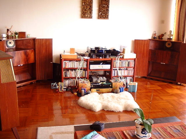

I would just like to say that my experiment with having all the power transformers on one chassis, and the recifier, tubes, choke and OPTs on another was very successful. No hum whatsoever, (using DC on DHT filaments is great) and sounds wonderful. Easy to lift too.
The best thing about this arrangement is that the PSU chassis can be hidden out of view, with only an umbilical going to the main part of the amp.
my 0.02
Why do you guys always argue so much! 🙂 Agree to disagree dammit!!! 🙂
my 0.02
