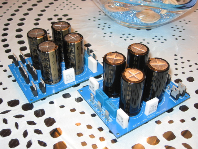

My amplifier (LF 100) need a decent case and while thinking about visual WAF friendly apperance, I have noticed that having two monoblock cases would make some asthetic and sonic benefits...better separation, placement amplifier close to speakers...but on the other hand, I am a bit worried about grounding issues. Each mono amp should have his own central grounding point, that means that both grounds meet together at extension main cord, compared to stereo amp where both channels meet each other at one central point with short (low impedance connection).

I presume you have a "standard" LF100 ... which has 1 x PS PCB connected to 2 power transformers? So to move to monoblocs, you will have to cut that PS PCB in half.
I implemented my LF100/55/55s as monoblocks - so that's what I did (cut the 3 x PS PCBs in half). I can assure you there is no grounding issue when separating the 2 channels - as long as you drill a new hole in each half of the PS PCB, so you can implement a new "star ground" in each.
How do I know there is no "grounding issue" ... because my system is dead quiet - ie. no ground hum. 😀
And the big advantage is that, as you noted, you can put the monobloc case right behind each speaker. (In my case, I have 3 amp modules, 1 active XO and 4 complete PSes in the one custom-designed case, sitting right behind each speaker. 🙂 )

Thx...Yes I have LF100, but with separate PSUs which were designed by myself. So no cutting here 😀

For safety's safe it is best to connect mains earth to the psu star earth.
On the LF board the signal ground is connected to power ground with 2 diodes and a 10R resistor, so signal ground is not directly connected to power ground, which is directly connected to star earth on the psu.
Not connecting the mains earth to psu earth is fine as long as nothing catastrophic ever happens.

You're asking - no, begging - for a nasty ground loop. Why would you want monoblocks and then connect the output grounds together via the power ground? The signal grounds should come back together via the RCA cables at the preamp. Any slight ground variances due to signal currents won't make an iota of difference as the output ground is 'floating'.
Please remember that any voltage drops in a cable happens in both conductors. 'Ground' (earth if you will) is not the same at the load as it is at the source. You MUST obey Ohm's law. You can try to force your way with ground straps or larger gauge wires but there is always resistance whatever you do. Don't fight it, work within the limits.

Did you read my post on how the LF board is designed?
It's relatively easy to check for ground loop noise by just connecting mains earth to star earth, and seeing what happens. I've used LF amps for years, and find no ground loop issues with connecting mains earth to star earth.

I have connected the chassis to star earth as I had a bit of noise in my "Soraya" boards, due to the fact that I had a large Mundorf silver/oil input cap fairly close to the board and therefore the output inductor. Dead quiet now. I did'nt have to do this on my original 100+n amps.
I tried this after I noticed that Hugh had done it on his commercial "Soraya", no problems at all.

Then again, with my Soraya monoblocks (each module is in a custom-built case with 2 Lifeforce 55 modules plus an active XO), the star earths on all 3 modules are connected together but the chassis is not connected ... with zero noise.
