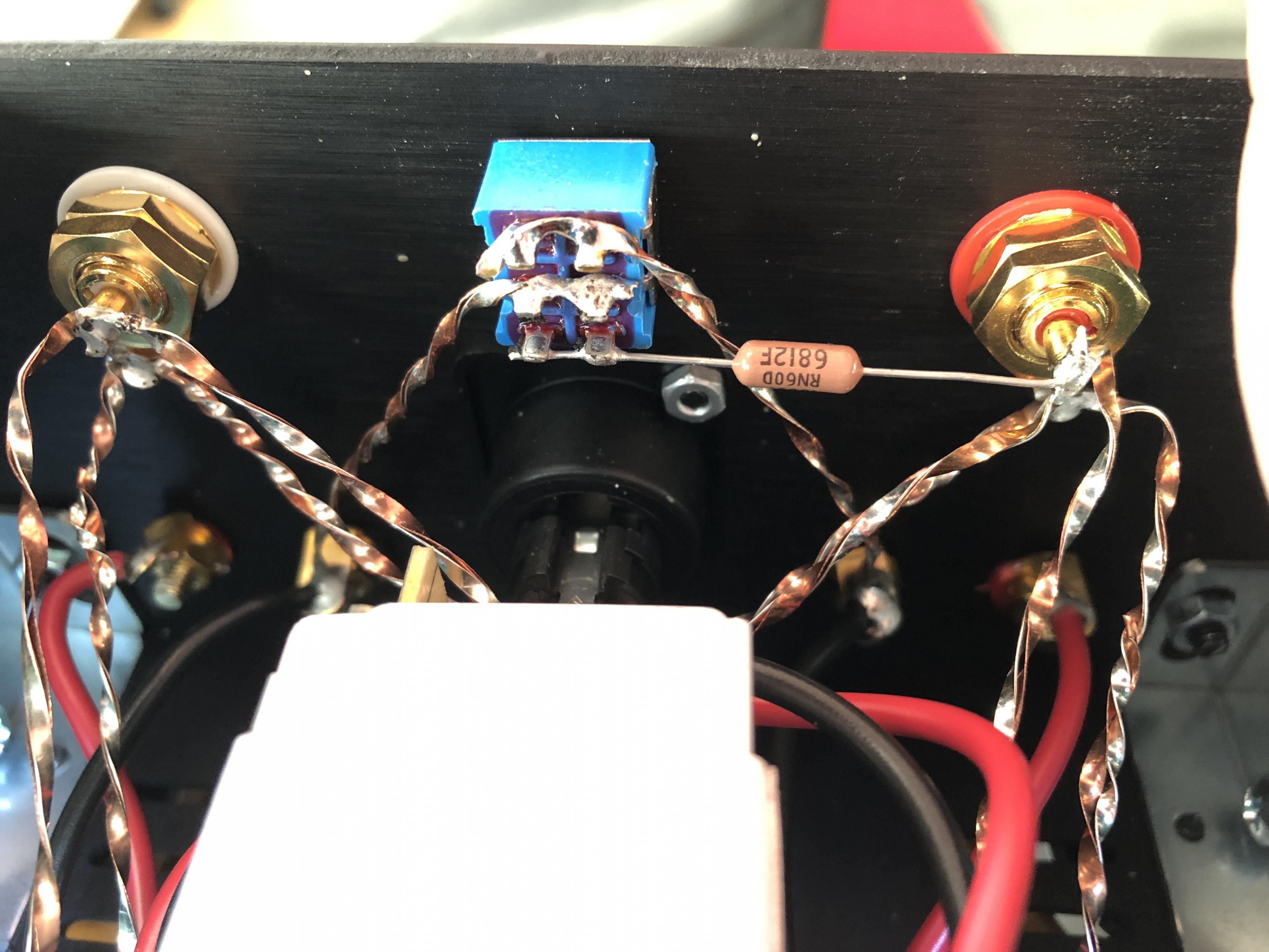

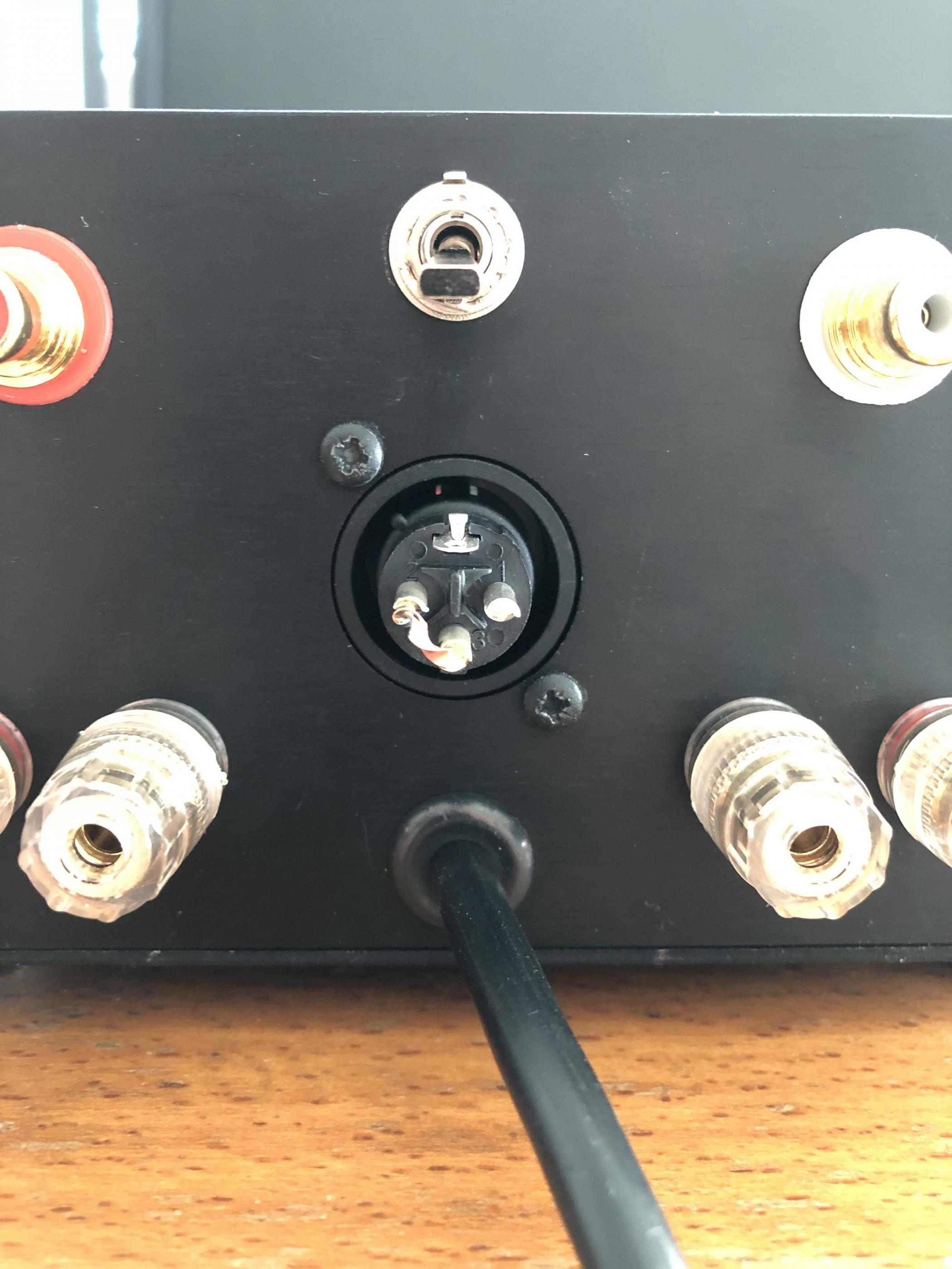

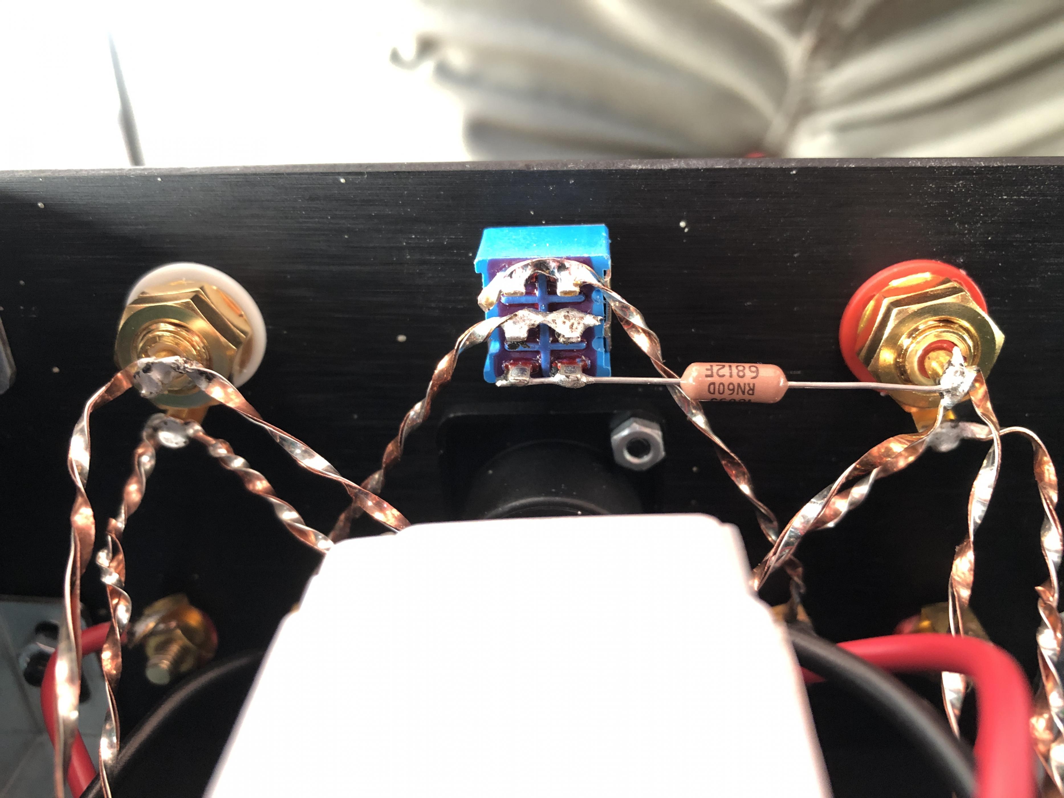

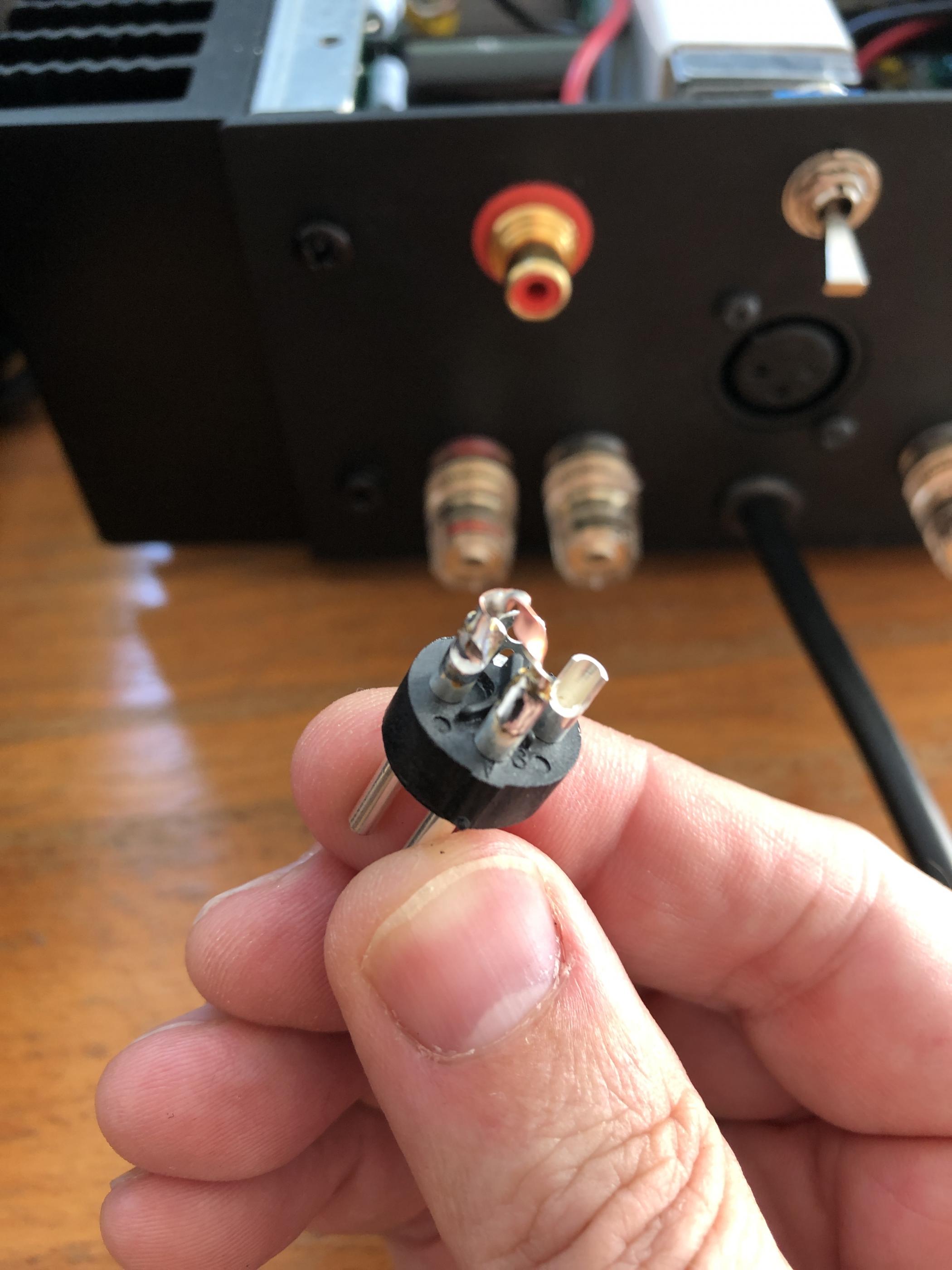

Monoblock ACA bridged mono <=> parallel mono at the flick of a switch
I have been playing with ACA's recently, swapping between bridged mono and parallel mono operation... and then I realised that instead of having to do a fair bit to go from one configuration to another, there was a pretty capable rating-wise switch at the back that can do both in no time at all.
So, I took a few photos that explain what I did. The switch contacts should be used in parallel to half the contact resistance😉
I considered the safety as well... and could not see any problem in using the switch for either mode.
Especially useful if you want to try monoblock ACA in both modes at your friends' place, for example, where each mode may sound different depending on individual tastes, rest of the system, speakers, room size/damping...
Also, why settle for one mode, when you can change the mode to suit your mood... don't forget to re-wire speaker connections when changing the modes.

The switch is pretty good for the purpose... it is rated for mains voltage use, and I mentioned already how to utilise both contacts for each position, to halve/minimise contact resistance. The switch option provides for an easy change of the mode of operation while playing/deciding on which mode suits your needs best. Once you settle on either, there's nothing to stop you from omitting the switch and hard-wiring for the chosen mode of operation.
The bridged mono mode requires high-quality signal relays, the paralleled mono operation requires high current -capable split relay contacts.... but relay options are too cumbersome because they'll require some sort of control circuitry to operate them in the correct way.
The little ACA already comes with the switch.... so it's simple to implement and use for both modes.... just don't forget to us both switch contacts for either position
Whenever there's more than one option, there's a compromise -> some sort of switching method has to be utilised
