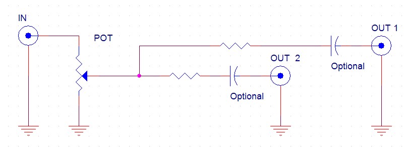

A single pot with the wiper feeding 2 10K Rs each feeding the amp inputs is what you are after. Where did you get that circuit?
Actually, all you have to do is parallel the inputs.
Why not something like this?
Would this do the job? The output is going directly into a NJM2073 amp. The input is coming from some kind of preamp. I cut down the r9 resistor to 470 because of the paralleled r9/r10. I don't know if I would have to do anything to the caps and res after the pot. Again, any and all help is appreciated.
Thanks.
