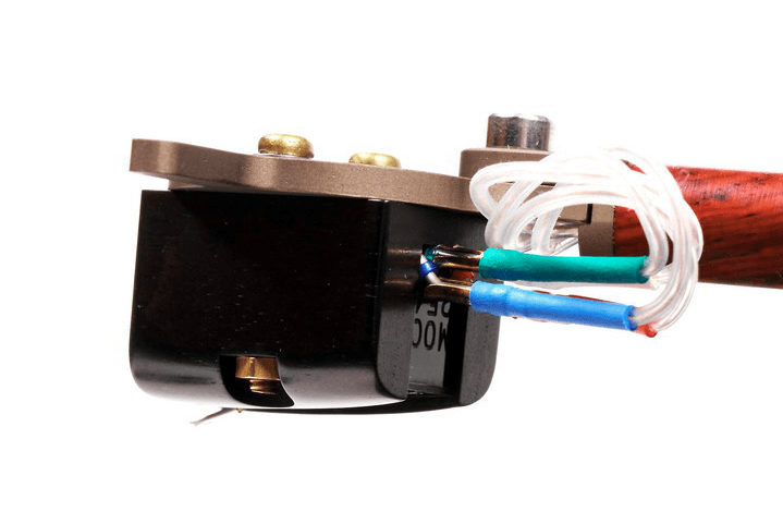

I have no exposure to mono at all. But I have someone who I built a Paradise for asking for a solution to a dedicated mono setup.
Is he best off using a Y splitter between tonearm lead and into both inputs of a dual mono phonostage?
Or, is he better off getting another single channel of a Paradise and using a y splitter on the output?
Assume cost doesn't matter, and he's using a Majiyma dedicated mono cartridge.
All opinions appreciated.
This shot from a review shows the mono Miyajima Zero has four pins. If this is the one your friend has then I'd just plug it in like a stereo cart and run it like stereo. That's how it was intended to be used.
I can think of reason to have reservations (mostly paralleling unequal channels and the potential for poor summing (bass) out of mono played through dual channel speakers) but if Mr. Miyajima designed it that way there would be a reason.
In cases like this where big bucks are spent on a specialized component, I'm frankly surprised the owner doesn't consider asking the maker what he's thinking and recommends. I certainly would.
I looked into this cartridge some time ago and found a picture of its internals. There is one coil only feeding the left and right output pins - they carry exactly the same signal. If you listen via your standard stereo setup with two speakers, best is to use only one channel for the RIAA pre-amp and then feed the signal to your right and left line / power amp inputs. Reason is that if you use a stereo EQ amp with the inputs connected together, even small deviations in both channels due to slightly different EQ will result in degraded performance as the outputs will be slightly different and not exactly the same anymore for an optimal mono listening.
And yes, it is designed with 'left' and 'right' output signals to be used exactly the same way as a stereo cartridge is connected to make it usable for the non tech oriented users. Maybe the underlying thinking is, if you spend such an amount of money for a mono cartridge, your RIAA preamp should be already of adequate quality with excellent match of both channels 😉

The customer already has a Paradise, there's no channel mismatch, riaa parts are all matched to a fraction of a % across both channels and the outputs are level matched to a couple of mV. They are as closely matched as its possible to make at reasonable expense and without substituting individual transistors to match noise profiles.
I think he's probably best of just using both channels as the designer Intended.
