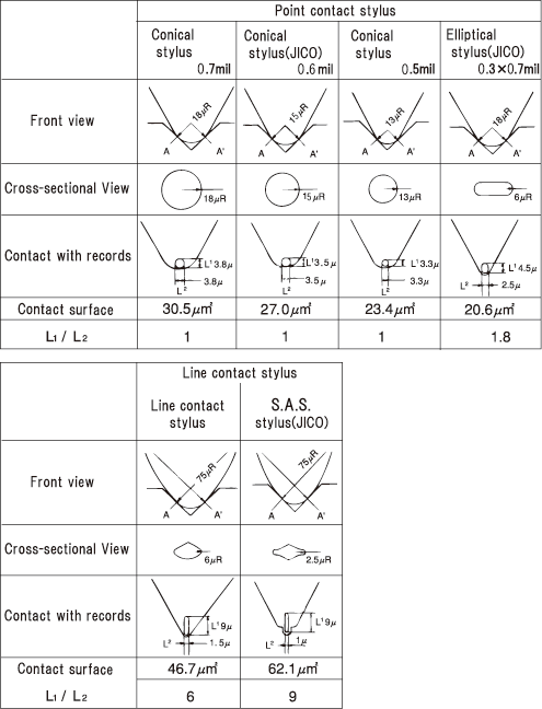

I didn't realise they did an affordable mono*...as well as some unaffordable ones. But they are true monos which I didn't know anyone other than ortofon made these days. However they have changed to elliptical for the Kotetu.
