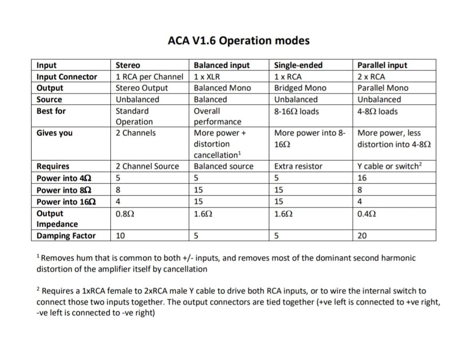

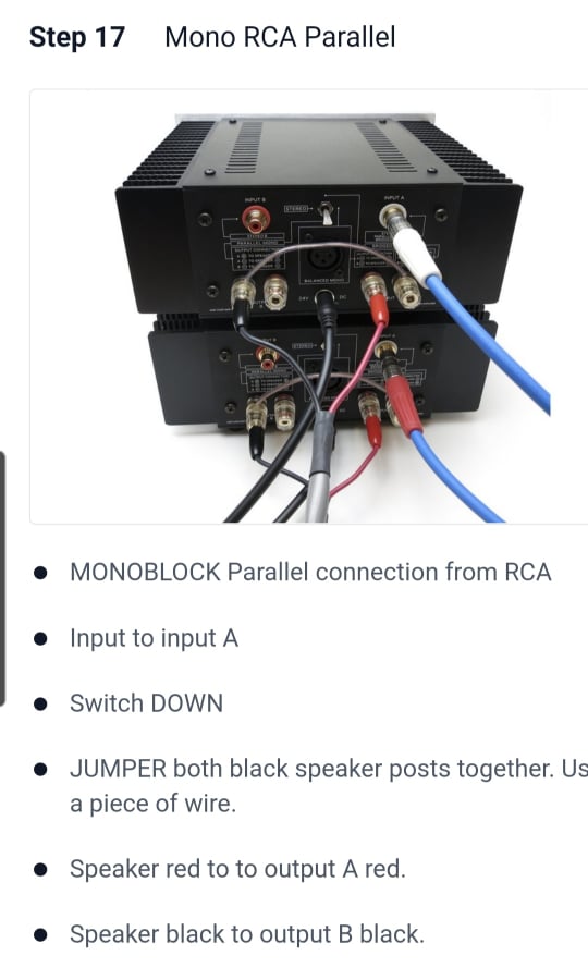

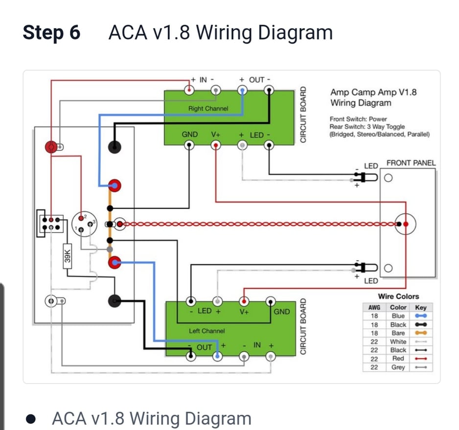

I connected my 2 monoblocks v1.8 aca to monoblock parallel as per build instruction. I checked the ACA V1.6 operation modes table, Is my connection correct to follow the parallel input operation mode? i like to evaluate the highest damping factor 20 in my normal bedroom listening level at 8w (8 ohms) as compared to single ended bridge mono. Pls let me know. thank you.

Yes, the picture on the left from Step 17 of the 1.8 build guide is correct for running parallel mono with a single RCA input. The picture on the right is the correct wiring diagram for the 1.8.
Your table in the middle shows (as you know) the 1.6, which was a different wiring. If you were only wanting to show the DF of 20, then that is accurate.
