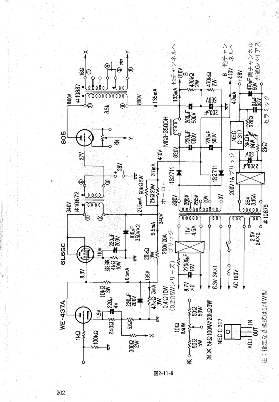

The 805 and 833 don't need huge voltages to run. Nobu k Shishido found they are best run at about 800 volts and 100-135 ma. Nobu used a 3.5k out put transformer in his amps for the 805.
I have made both Se And PP using the 805; I used 5k for the PP
If you can't afford inter-stage transformers you can use a Cathode follower such as a 6BL7.
The ming Da uses only 750 volts for 40-50 watts.

Nobu. K. Shishido 805
Nobu design for the 805 SE; he claims 45 watts for the 805 and 35 watts for the 838 {no top cap} with driver transformers.
Out put transformer 3.5K.

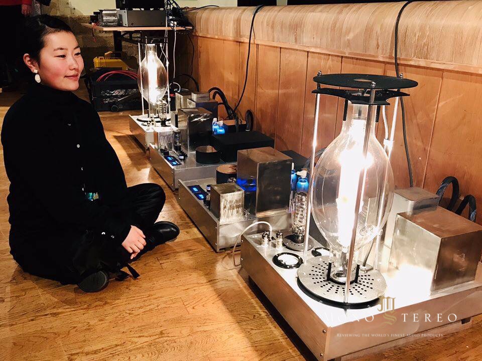

Did you mean this pictere?
It runs on 1900Volts at 350 mA, so it runs not that red hot as in the picture.
It a sort of modular system, i can run many different radar end or tranmitter tube's.
Think of the TB3-1000, TB3-2000, 6C21, GMI30,TB5-1250, TB-1500, TB5-2500, 833, SRS326, T3-800

That's the picture. They look white-hot but I don't know if it is the camera exposure. I wish I could afford to go to such a convention. It looks like fun.

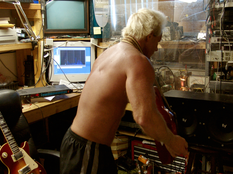

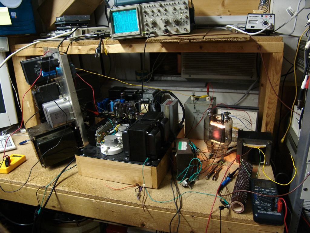

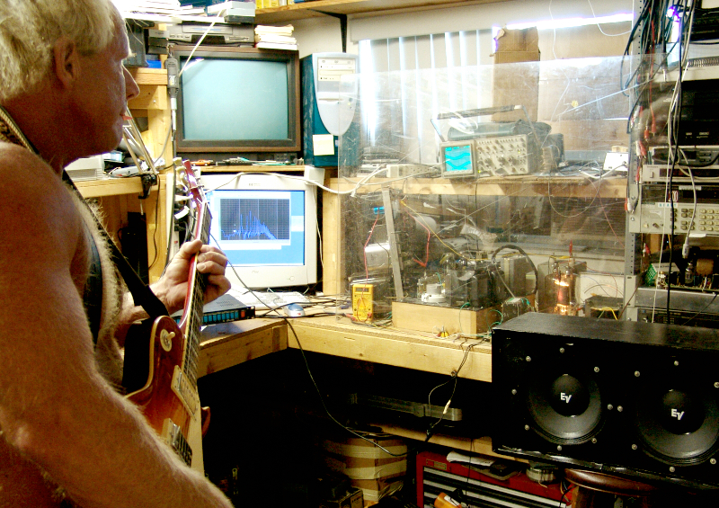

A 45 buffered by a mosfet (the second prototype Tubelab TSE board ever built, before Tubelab existed) is driving an 833A well into the red zone for 200 watts of SE terror. Drive the whole thing with an old ADA guitar preamp using a preset named "Jimi." It could be heard two blocks away.
For all but a few pictures there was a 1/4 inch thick Lexan shield between me and the pile of deadly electricity. The plate supply came from an old Motorola radio transmitter. it was rated for 1500 volts at 1/5 amp. I was using about 280 mA.
This was a test of a custom made OPT which worked great for guitar, but wasn't quite good enough for HiFi. This test amp only existed for about a week, and the stuff in the picture tells you that it was nearly 20 years ago.
