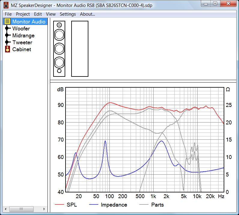

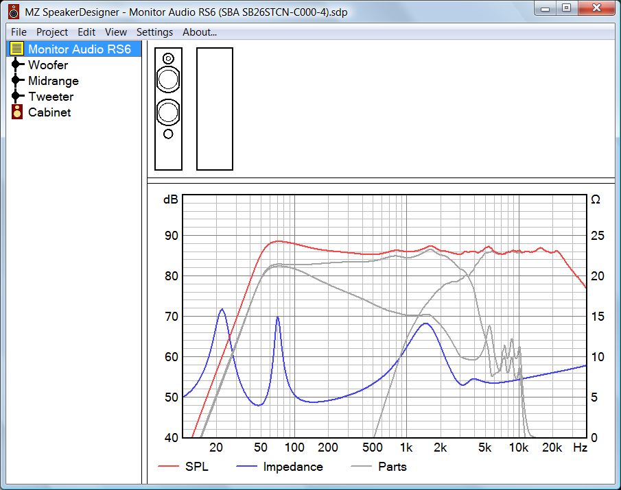

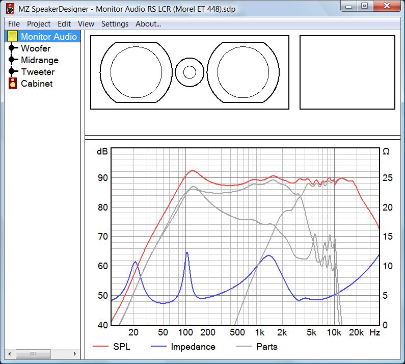

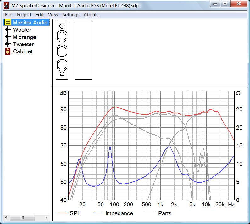

I tried some replacement tweeters in my simulation and got some interesting results.
The Morel ET 448 has been reported as promising candidate. The simulation shows a very nice result and confirms full compatibility. No crossover modification is required. The same applies to the Morel CAT 408. However, these are rather large domes and they are quite expensive.
A cheaper solution, but not lower in quality, is the SB Acoustics SB26STCN-C000-4. This is a 4 ohm tweeter and it needs an additional resistor between crossover and driver. But the result is amazing (at least in the simulation). Everything falls into place. 🙂

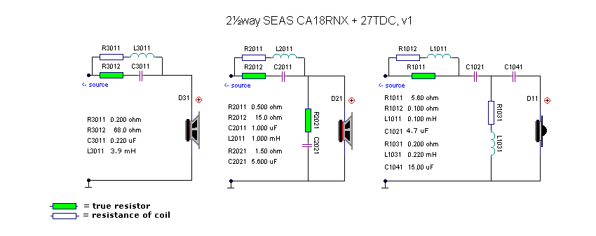

But his 6" paper cone CA18RNX 2.5 way is very interesting:
CA18RNX
Crossover fans will notice the 5kHz tank notches on bass and mid. This could be just what we want. The 1:3 (4.7uF/0.22mH/15uF) capacitor ration 3kHz BW3 tweeter filter is familiar too, here with a bit of RL rolloff. Trust me on this, 1mH and 1uF makes 5kHz, as does 4uF and 0.25mH as a rule of thumb. Or 3.9mH and 0.22uF, roughly...
Where I'm leading, is it wouldn't be hard to notch the bass driver with a tank. 😎

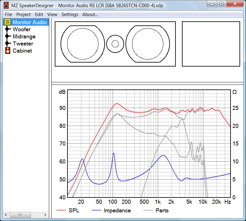

Hi meeko,
I now have verified my simulations and came to the conclusion, that the sensitivity of the RS speakers actually is higher than I assumed. As consequence the Morel CAT 408 drops out of the list because it is too silent. The additional resistor required for the SB26 now is only 1 ohm. The resistor even can be omitted when a hot top end is preferred. Adjust it to your taste.
I have no idea if the replacement tweeters do fit mechanically. But the simulations for the RS8 and the RS LCR look promising IMO. Except for the additional 1 ohm resistor in case of the SB26 there's no crossover modification required. 🙂
Good luck, and don't buy the Morels, they are too expensive! 😀

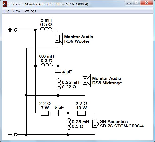

Dissi's simulation, and TBH, I don't know how he did it except he designs these things, is extremely useful:
Roughly based on the above crossover and the SB26STCN-C000-4 :: SB Acoustics, though MA seem to be using a 6.5mH bass coil and 0.2mH elsewhere in your (meeko's) latest schematics. And a bit of fiddling with tweeter level.
What I noticed about Dissi's sim, is the bass is actually contributing more breakup hash than the mid.
Which says to me a tank notch on the bass is a very good and cheap idea.
I'd suspect that one soft-dome tweeter is much like another, and SB make particularly good ones at low prices. I was looking at Dissi's sim and thinking the notch was too low at 5kHz. 6kHz would be better. So 4uF and 0.2mH shunt on the mid, it is. The bass tank would be a cheapish CR. On 6.5mH, it must be about 0.12uF and 47R, keeping the LC product constant.
A 5W resistor and a little 0.12uF polypropylene (MKP) or mylar (MKT) is cheap entertainment. I agree with you about snake oil. Only real quality difference in components I can justify on scientific and measurable grounds is better air coils replacing ferrites.

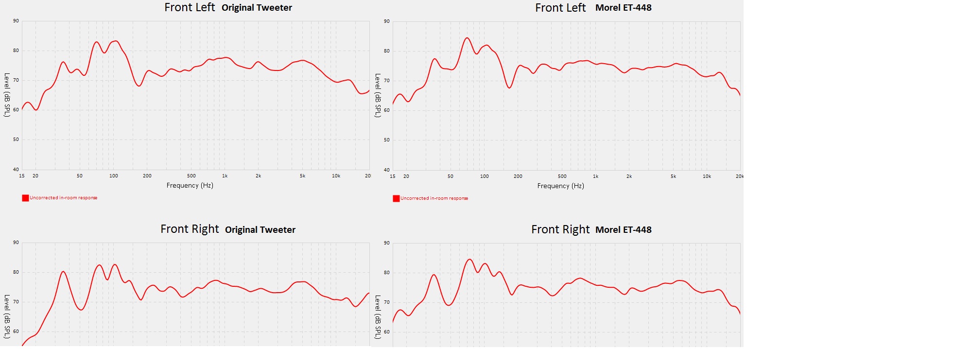

Hi all,
I've attached a picture showing in-room measurements using my Anthem MRX720 ARC 1M Calibration software. It uses a calibrated microphone and is useful for seeing the difference in response with the Morel ET-448.
As you can see the peaks at 2k and 5k are smoothed a little and the Morel is definitely louder between around 10k-16k but not so sensitive beyond that.
I've listened to these for many hours now and the difference in clarity and enjoyment especially in acoustic tracks is night and day.

Always good to get some feedback, Steve.
I notice the 2dB hole is still there from 2-5kHz.
This is another variant:
I see no need to change the 6uF if that is what you have, but I found a 10uF after the 0.25mH (or 0.2mH) almost exactly filled the tweeter hole. Worth trying, IMO.

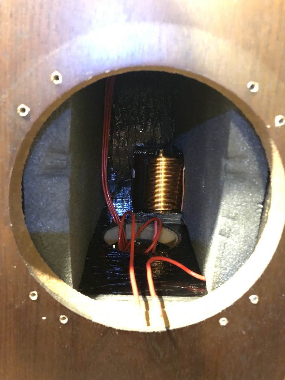

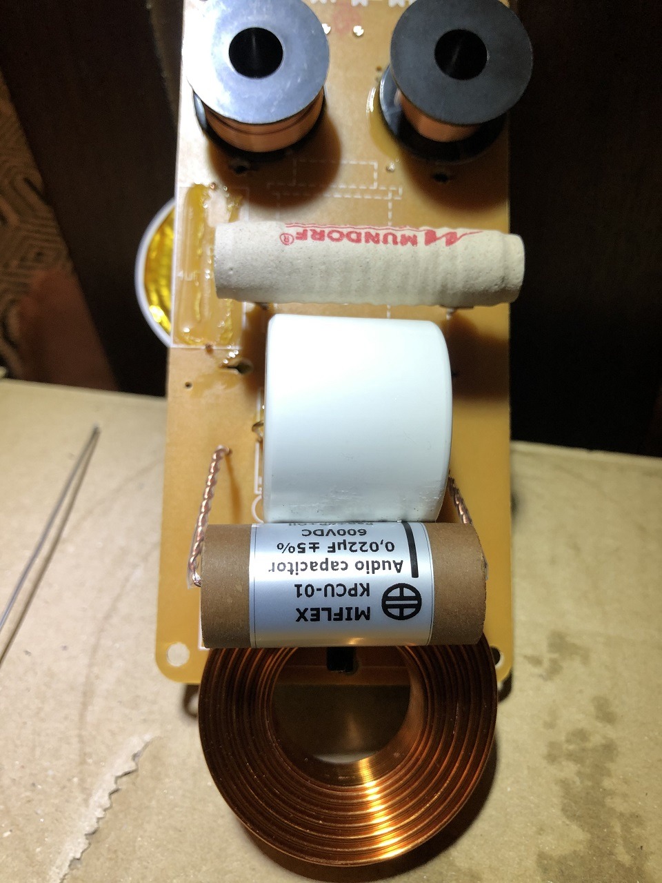

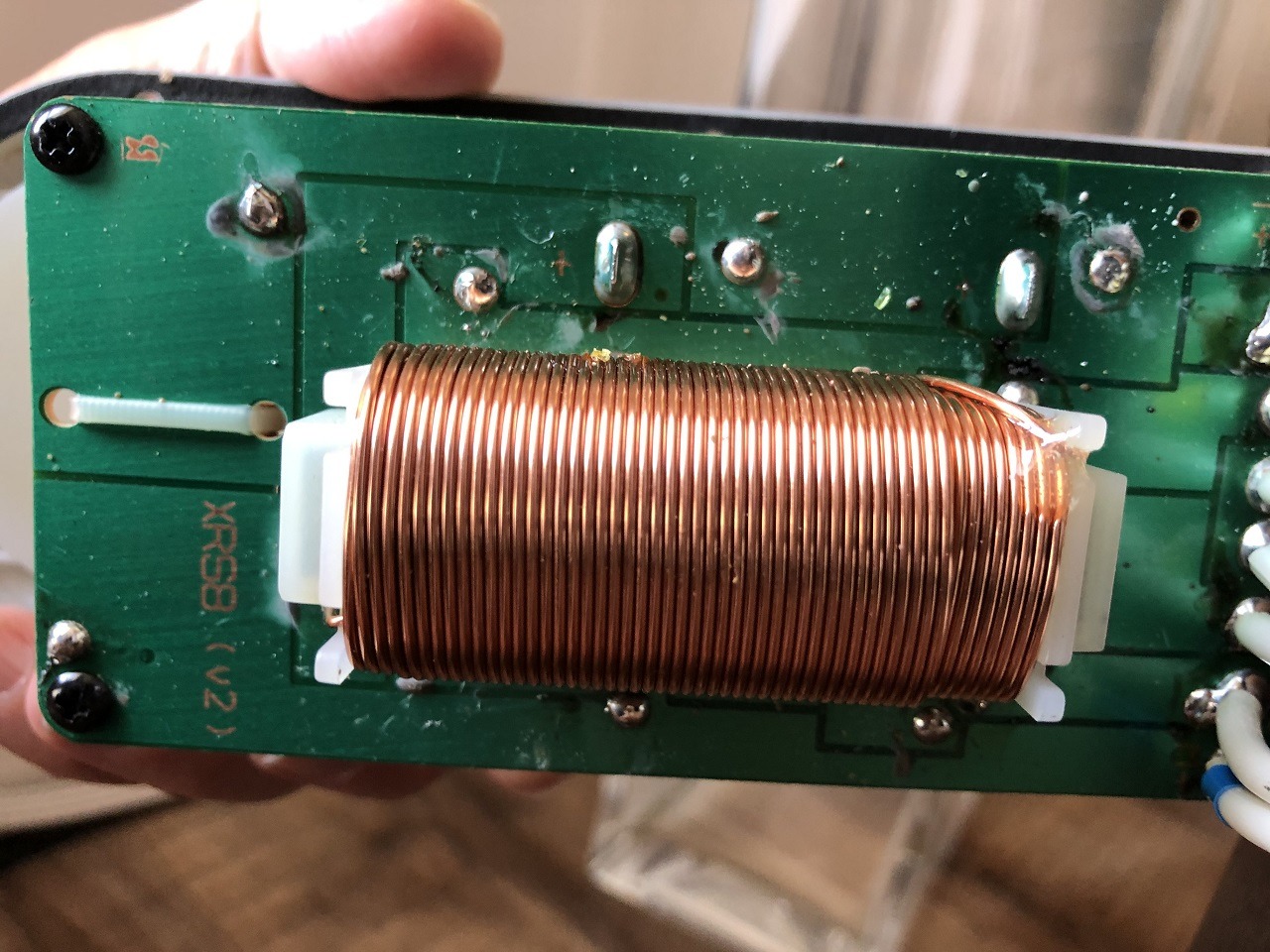

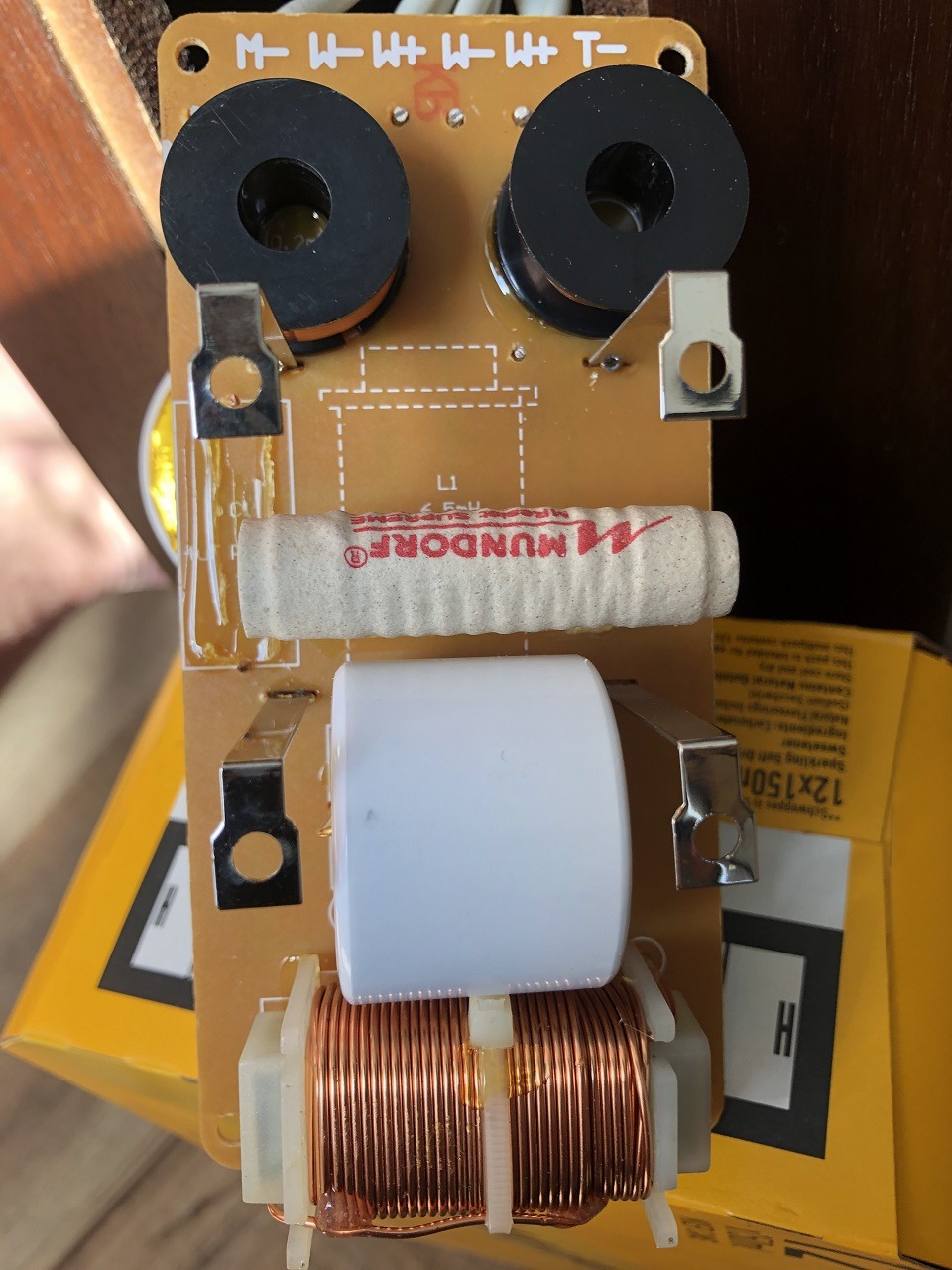

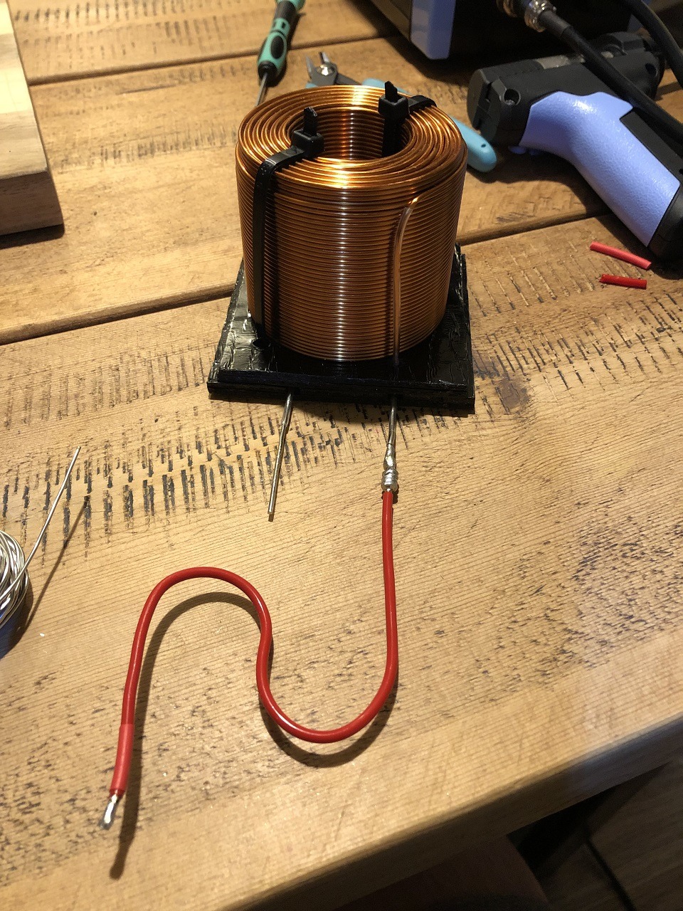

Following on from meeko results I also upgrade my RS8's with the Morel Elite ET 448.
They are a significant improvement over Monitor Audio's TRS-025; it has to be said those are pretty poor with their uneven response and horrible 'oil can resonance' spike at 20KHz. No crossover mod's were required.
They're also quite a neat fit in the original baffle and drilling new holes for the mounting screws isn't too scary if you take your time. Ideally they should be recessed further for better driver alignment, but the same can be said for the originals too.
I obtained mine from SoundImports in Europe, very professional service.
A massive thanks to Dissi for his original crossover modelling work and recommendation.
Obviously the cost has to be considered, but I'd highly recommend them to anyone looking to improve their RS series speakers. They offer a great improvement in overall balance, detail and imaging.
This wasn't my first RS8 modification, but it was one I wished I'd done earlier.
From experience, I'd actually recommend improvements in the following sequence:
1. Change the woofer and mid-range driver iron core inductors for high quality air core inductors (bass depth and punch, huge improvement in mid-range clarity!)
2. Resonance damp the cabinets using bitumen pads. Also damp the bass and mid-range magnet shrouds
3. Replace the tweeters
4. Replace the crossover capacitors and resistors (improved clarity, less smearing during complex passages)
5. Rewire the drivers
6. Remove the mix of metals from the crossover connection path
7. Replace the magnetic torx screws used to retain the drivers and crossover with stainless steel equivalents. Check and fix spike mountings.
In combination with the above, correct placement and room treatment have provided a massive improvement in enjoyment. You'll be really surprised what can actually be achieved here.
I'll post more details and images soon.

The RS8 woofer low pass filter rear mounted iron core inductor (L1 6.5mH in the XRS8 (v2) crossover):
(note the quality soldering on the original PCB)
and L2 0.8mH iron core inductor for the mid-range band pass filter at the base of the image:
They were replaced with Jantzen Audio air core parts wound from high purity 4N copper wire. Mid-range:
and for the woofer:
the mounting is made from bitumen sheet and due to its size and weight the coil relocated from the rear of the PCB to behind the top bass driver:
As mentioned previously, I'd recommend the inductors are the first item looked at as they are reasonably inexpensive and provided a significant improvement in clarity, taming the edge on the mid-range and providing noticeably more depth and drive in the bass.
and for the woofer:
