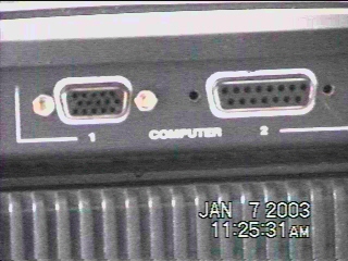

I was just going to plug my computer into my LCD Panel and I realized I don't have the cable.

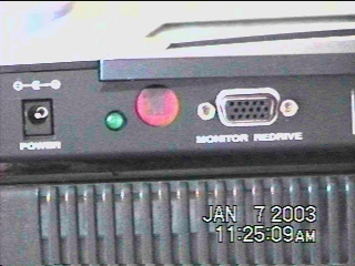

Looking at the LCD panel I saw multiple computer connectors. One that I didn't know was labled "Monitor Redrive". What is this?
Which connector do I plug my computer into?

You plug your cable into either monitor 1 or 2.
Monitor redrive is so that you can plug your computer monitor back into the panel so you can watch what you're presenting while you're presenting it (in case you don't have a VGA video splitter or a dual-output card).
Hope that helps. You should be able to find a nice male-to-male HDDB15 vga cable on E-bay with a buy it now of $5 and $3 shipping or so.
Good luck!
