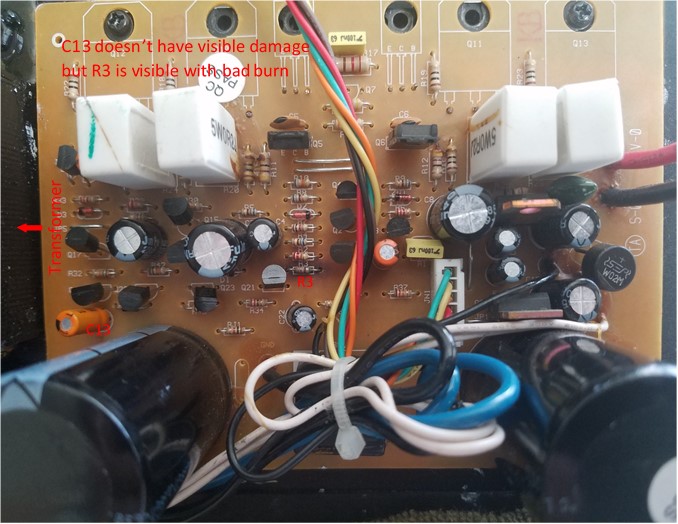

I fixed mine
My MA FB210 was having a similar problem. And I have fixed it.
I noticed the problem about 2 and half years ago. Switching the off-auto-on switch to on would turn the led green but no sound.
The strange thing was I could make the sub to work by pulling the power cord out slightly and pushing it right back in quickly when the switch was in on position. It might take several tries, but it always worked. I knew it worked because I could hear the sub powered up with a pop then it functioned normally. It worked fine as long as the switch was in on position.
The trouble was the sub would stop working by itself at random – no sound again although the led was still green.
The following is the repair detail.
I cannot find FB210’s schematic but I find some diagrams for Apex Senior Sub Amp that is very close to my FB210: The Apex Junior Subwoofer Amp.
I learned the sub never powers off. What the off-auto-on switch does is changing the signal (CONT) sent to the protection circuit. The off position makes the protection engaged by connecting the CONT signal to the ground while the on position disengages the protection by connecting the CONT signal to some high (~10v) voltage. The auto position makes the CONT signal sensitive to the line audio input and holds the CONT signal high for a while after the line audio signal is off. The led related to the off-auto-on switch shows the CONT signal status only.
My problem is the protection was always engaged so the power amplifier part was shut off. The protection circuit was engaged even when the CONT signal was high (off-auto-on switch in on position) except it could be disengaged with unplugging/plugging the power cord quickly.
The culprit is the C13. It could be that the cap is near the transformer so it’s impacted by the heat. Anyways the protection circuit works and the sub functions normally again after I replaced the C13. Sorry that I don’t know why unplugging/plugging the power cord could disengage the protection with a bad C13.
My guess is if you can make your FB210 work by quickly disconnecting/connecting the power cord then you probably have a same failed C13 as I did. But even if unplugging/plugging the power cord quickly can make your FB210 work, you may still want to replace the C13.
This is because my 2nd finding: the R3. When the sub is active with either the switch in auto or on position, it means the protection circuit is disengaged, there is ~130v (positive ~68v + negative ~68v – ZD1’s ~5.6v) applied to the R3. Here is the calculation: 130x130/22k (R3 is a 22k resistor) = 768 (mw). That is a terrible big consumption for a 1/8w resistor. As a matter of fact, the PCB under the R3 shows burning sing and the soldering is de-soldering. I believe putting the switch in on position all the time makes the R3 burning a lot more than put it in the auto position. I also believe that if the R3 gets totally de-soldered and disconnected from the circuit, the protection will engage all the time. In this case, unplugging/plugging power cord won’t work and a good or bad C13 is irrelevant.
I replaced the 22k with 40k (4 x 10k 1/4w since I don’t have the right resistor) to reduce the power consumption and the sub works fine after the change.
Hopefully, your FB210 problem is either the C13 or R3 and you know now how to fix it.
If you are going to fix your FB210, make sure to properly discharge the circuit before you start to work to avoid a shock and/or some damage.

My suggestion is to measure the voltage cross the R3. It should have 0 or near 0v when the off-auto-on led is red and around 130v when green. If this is the case, your protection circuit is working and you should hear some loud noise when touch the SG with your finger. We need to find the problem is in the pre-amp, amp, or protection part first.
