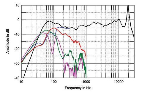

A review of the Monitor Audio Silver 6S let me doubt about the crossover modification in the midrange:
Audio Ideas Guide Hi-Fi and Home Theater Equipment Reviews: Monitor Audio Silver 6S
The frequency response shows an early roll-off starting at 1 kHz. Increasing the coil and the capacitor, as Steve suggests, will make things only worse.
Do you have any better suggestions?

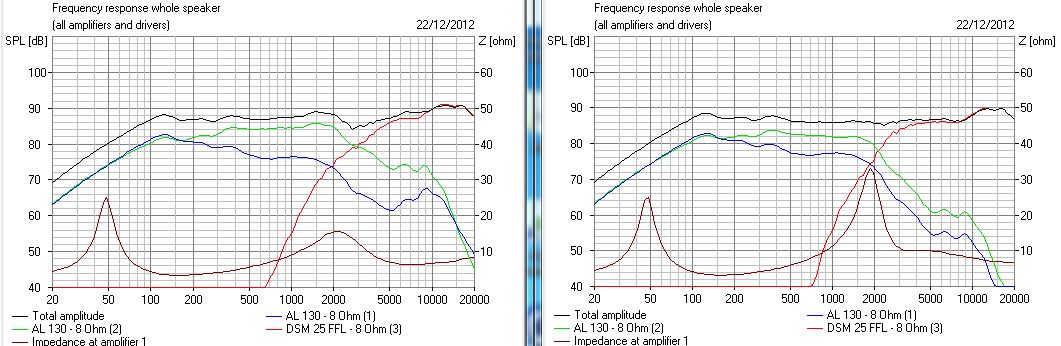

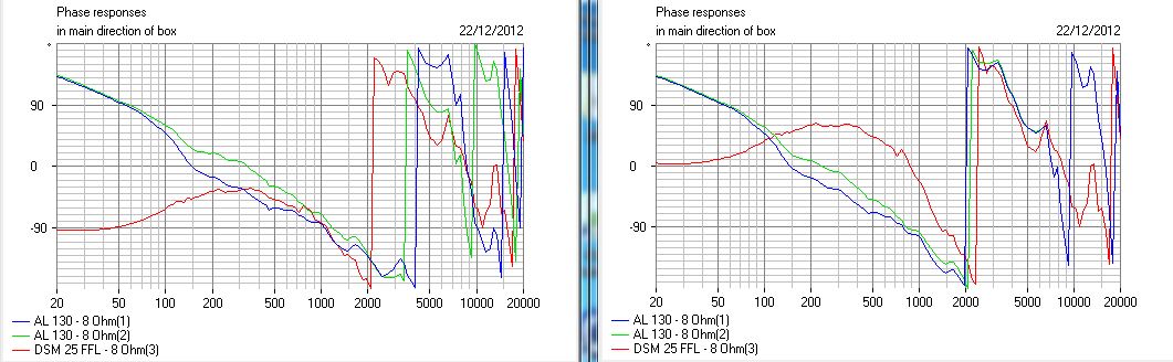

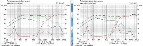

I can only reiterate what I have done and why I did it. Firstly I attempted to reduce the cone breakup from the metal woofers. This should make for a smoother sound without metal harshness.
Secondly I attempted to smooth out the midrange dip at 3kHz. This needed a 3rd order filter and the bigger bass coil.
Lastly I attempted to reduce the top end a little. This needs the Zobel.
It's worth mentioning that an expensive 0.3R coil is really not needed. About 0.8R would doubtless be fine. The 15uF capacitor can be lost with a return close to the original tweeter filter and a better phase response. There is nothing stopping you reducing the input resistor to the tweeter filter to 1.5R for more treble level, as long as you are aware you stress the tweeter more.
It's a shame AllenB no longer posts here. I can understand his reasons. People here make awfully hard work of what should be a fun hobby. 😡
Sorry, no. The driver parameters are completely unknown. I don't think it's correct to assume Visaton AL130 and DSM25 would be similar. Obviously drivers and/or crossover of S6 and RS6 are also different.
In the case of the S6, an elliptic filter might give more spl in the upper midrange and suppress the cone break-up as well. But it's impossible to design the filter without having any driver data.

@dunenthem. I'm not AT ALL concerned about the accuracy of the modelling. Within certain limitations, I found it worked EXACTLY, as shown below! 😎
As it goes, Monitor Audio have employed decent components. What they have done is cut down the number, which we might rectify.
Dissi, don't take this too hard, but most people wouldn't know an elliptic filter if it slapped them in the face, although it happens I do know what one is. Please do not employ such vague audio-gibberish. Leave that to Zaph...🙄
We are living in the real world. It IS possible to modify a crossover VERY PREDICTABLY with enough insight into filters and metal drivers. Naturally there is an element of trial and error here AND reporting back with the results. But I have, I hope, addressed the three main criticisms of the listening experience. I have also been quite conservative in changes and reused components as much as possible. Time will tell.

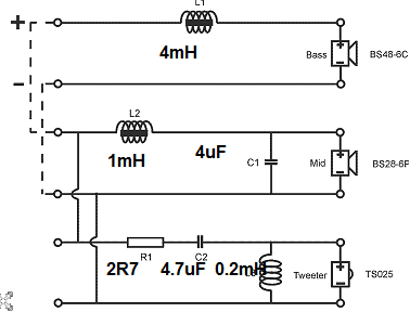

RS-6 Crossover Details
Still looking to modify my M.A RS6 crossover......I discovered that there are significant differences from the S6 discussed above. We knew that it was different based on the F.R. ascending on the stereophile measurements. Anyway, after opening up, this is what I found;
Version 2 ,RS6 scribed on the circuit board;(Stock Crossover)
,,l-----l----C1---R1---- + ,,,,Tweeter
,,l,,,,,,,l
>l,,,,,,L1
,,l,,,,,,,l
,,l-----l--------------- -
R1=7W2.2ohm
C1=6.0,250V
L1 = ? very small coil
,,l------l-------L2------ +,,,,Midwoofer
,,l,,,,,,,,l
,,l,,,,,,,C2
>l,,,,,,,,l
,,l,,,,,,,L3
,,l,,,,,,,,l
,,l------l--------------- -
L2=.8mH,
C2=4.0,100V
L3= ? ~twice the L1 coil
,,l--------L4---------- +,,,Woofer
,,l
>l
,,l
,,l-------------------- -
L4= 5.0Mh
Still too much treble, some harsh upper mid. longterm listening still an issue although much improved via tube preamp,tube cd player. I have tried routing my tube preamp out to my parasound p7 where I can use my tone controls. Typically -4 gets me to a better place on the high end but clearly the tone circuit has degraded the signal slightly.
My current thought is to try the 22 ohm across the tweeter with a 4 ohm replacement on the series resistor first. Does this approach still make sense given this crossover? I noticed they put a Zobel? on the mid woofer ,not the tweeter.
I wonder what system7 has to say regarding the evolution of S6 TO RS6. Any comments would be appreciated. By the way, where do you guys stand on bypass Caps? Any application here ?

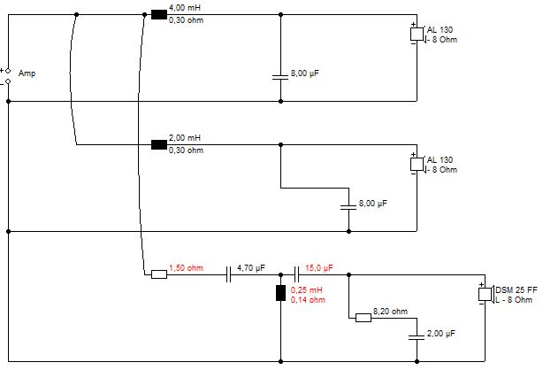

Anybody doing a PROPER job with metal midbass cones deals with the breakup around 7kHz.
DIY-Loudspeakers

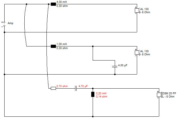

This what is called a 2.5 way. If you are interested, you can do some mods.
There's plenty of ideas in this thread. Have a go. 🙂

System 7 ,you lost me on this latest schematic. Re;
1. The Zobel is now gone on the tweeter?
2 The twin 8 mF shunt Caps have been replaced? New Zobel on the bass unit?
3. The 15mF butterworth is now a 10mF?
4. The upsized coil in mid bass is now back to 1mH?
I don't get it. What changed?😕
Why do you think for a minute that Monitor Audio, with a revolving door of staff, have really any idea what they are doing with this combination of drive units?
The S6 was the earliest version. IIRC, the RS6 was an adjusted crossover version. FWIW, most 5-6" basses look like this:
AL 130 - 8 Ohm
Shiny metal drivers that look good, but can it be improved soundwise? I thought so: http://www.diyaudio.com/forums/multi-way/115780-monitor-audio-s6-tweek-5.html#post3294900
I gave the basses more rolloff to reduce the 7kHz bell resonance and zobelled the tweeter and made it third order to stop it sounding so bright at the top and match slopes. Give it a go. If it's no good, come back! This is diy. It either works or it doesn't.

According to my current thinking, a 7.5R plus 2uF Zobel (not sure if "2.2mH" cap is a typo?) across the tweeter ought to do good things. I am ready to admit that a 22R 10W wirewound resistor shunted across the tweeter might effect a similar improvement in top end smoothness.
Actually improves amplifier stability more than anything. 😎
