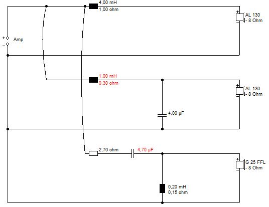

Thats what i want to learn, i dont really familiar to the graphs i am looking at.. and how is supposed to be, whats good, bad, too high or low...
Well those values i gave you is allready changed, normaly its should be 6.0 and 4.0 i think, thats why i asking for help, i dont mind experimenting, as long its done with common sense, not just by guessing.

When you take out the crossovers, can you determine what circuit goes to the tweeter? Let`s start from there. Post the values you see there.

We had a look at a similar metal driver Monitor Audio S6 a while back. The S6 circuit is below.
http://www.diyaudio.com/forums/multi-way/115780-monitor-audio-s6-tweek.html
The crossover was very basic and didn't address cone breakup much. This is not how you make an unfatiguing speaker. I'd agree that improving component quality is not the way forward. Crossover modifications might be. Some impedance correction (Zobel type shunts) would be a good start.
