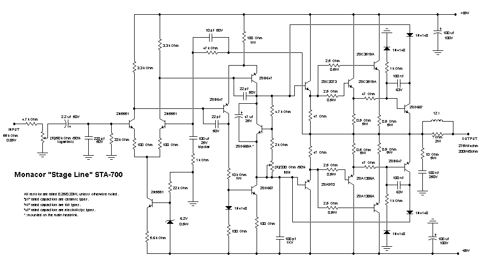

Monacor "Stage Line" STA-700 schema
here is the schema
sorry, I can't post it in better quality.
if you can't read something, let's post, I will tell you the value.
