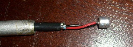

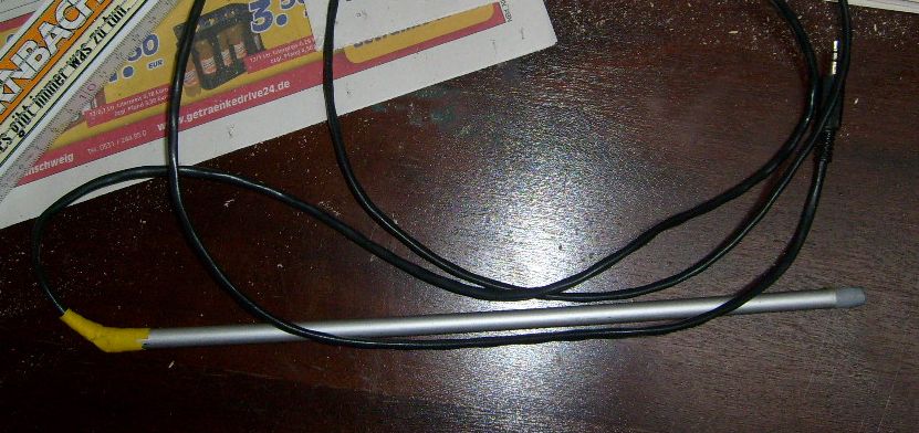

I build a microphone a few years ago with a eletret capsule (don't know which one)
it was simple and should be the same with mce-4000
-take a aluminium pipe 8mm diameter 30cm long
-push it over the microphone cable

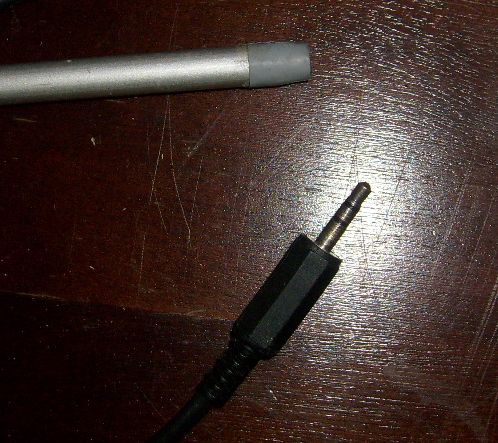

-solder the cable to the capsule and to a 3,5mm mono jack plug
-tape the capsule to the pipe, I used electrical tape, and tape the cable at the other end making some sort of pull relief
microphone ready!
Frequency response was flat far beyond 10kHz.
sorry!
