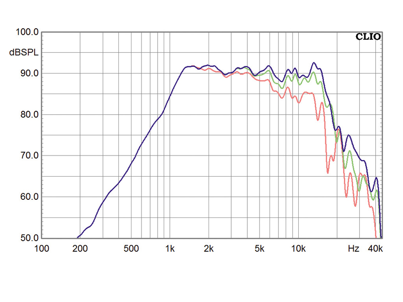

Using the CHN as midTweeter would be killer, but i question whether it is the right approach with the CHP-70.2.
I’d try the Monacor, the CHP just needs some help above its purposely shelved down top. That the roll-off ends in a shelf does make XO harder.

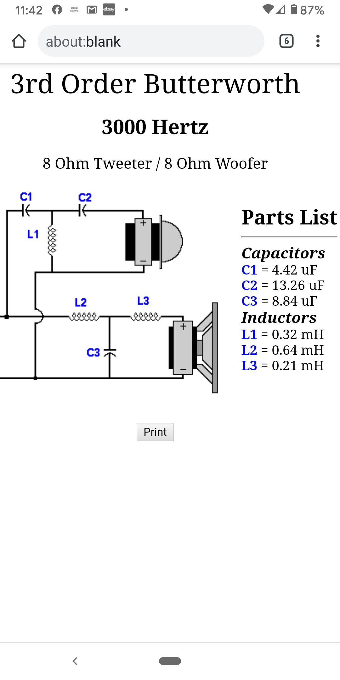

I am just wary of the Monacor HT-22/8 here. It needs a steep rolloff above 3kHz at its best. To match that, you might need some steep and high order rolloff on the 5" fullranger, and that would defeat the object of simplicity.
I don't see why you shouldn't keep the Founteks in their 1L box, and use it on top of a new one with the bigger CHP 70.2. It does look to me like the Fountek is more of a closed box driver in this application. It ought to be easy enough to make a low order crossover. FWIW, you just can't use them open backed in the same enclosure as a bass unit. They interact too much, which will distort.

I've used those sort of tiny "balanced drive" tweeters myself. Balanced drive because the dome weighs as much as the surround. I think you are quite right to not go below 5kHz. And Michael Chua seemed to take that onboard.

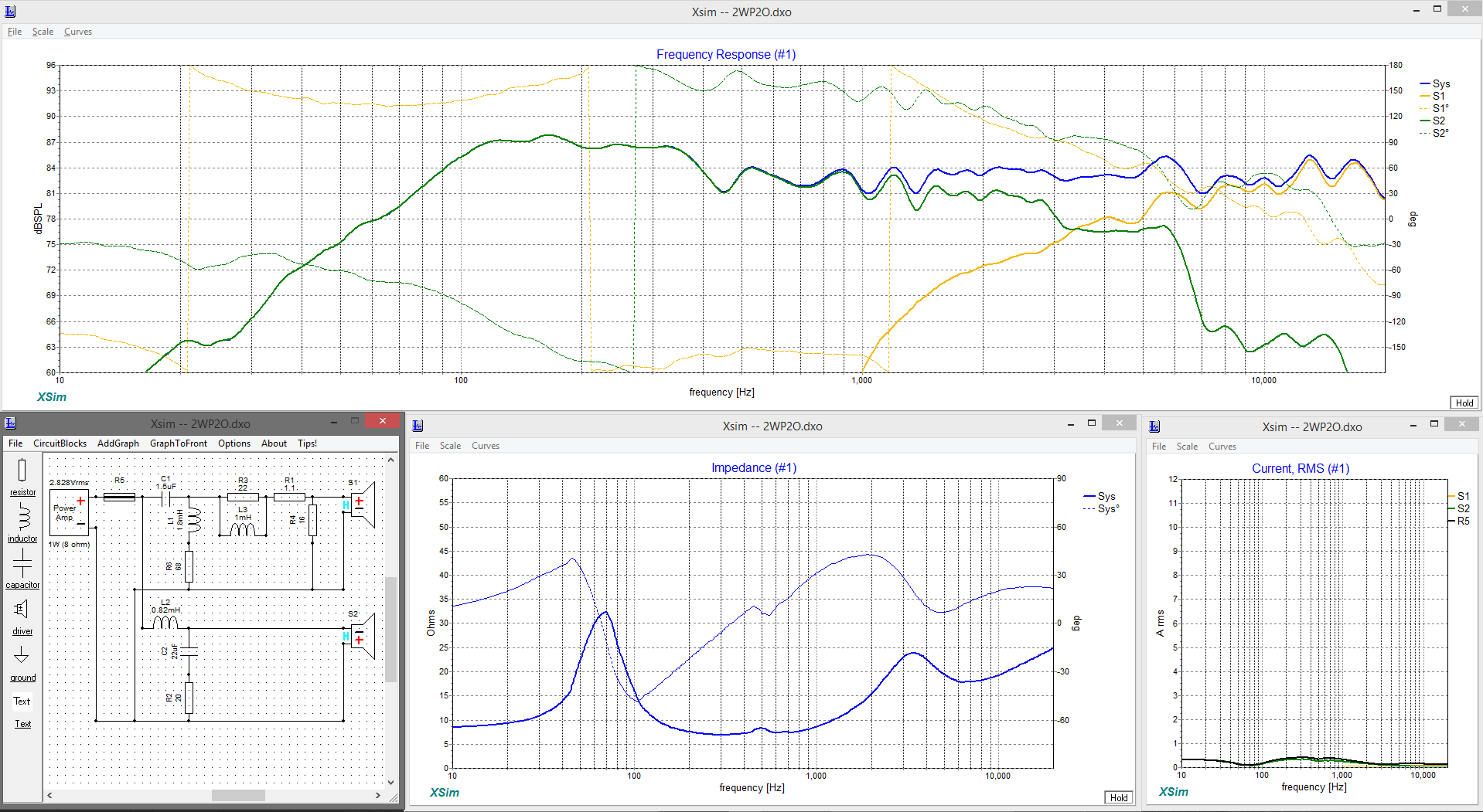

I'm not quite sure about this, but the optimiser in Boxsim might have problems with an incomplete driver file, can't remember, but it is quite easy to simulate for frequency response: Software | Visaton
A typical project with a couple of 3" fullrangers is easily put into the projekte folder with Boxsim, and off you go: CT Center 81 – Boxsim Projektdatenbank

From what I've seen, it will work just as a fullranger to get you started. But does fall away at 5kHz.
