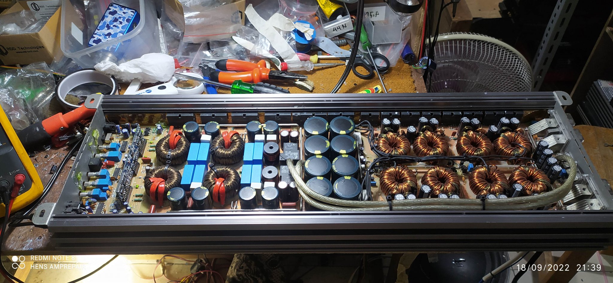

Hi everyone help me, i have problem with korean amp, momentum 5K, after final repair and test every 1 minute amp goes silent, green led normal, all voltage normal, but voltage an freq for mosfet final cutt off, what solution for this problem.

All power supply ok, 15v,5vDoes the power supply shut down when you lose audio?
Voltage lose only from out Ir21844s to final FET.
When all operation normal voltage to gate final 4.5vdc 55khz, when cuttoff only this voltage lose.All power supply ok, 15v,5v

The problem was a transistor in the mute delay circuit.

Yes i read that tread, ok i chek one by one, and try switch CE mute transistor. Thanks perry.Did you read this thread:

Perry do you have that schematic amp?The problem was before the muting transistor (the 1302).
I posted the closest thing I had in post #9:

Result, Amplifier succesfull replace D1303 with new one thanks very much perry🙏🙏🙏I posted the closest thing I had in post #9:
