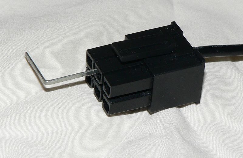

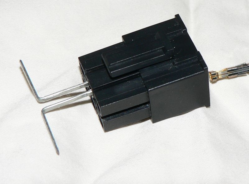

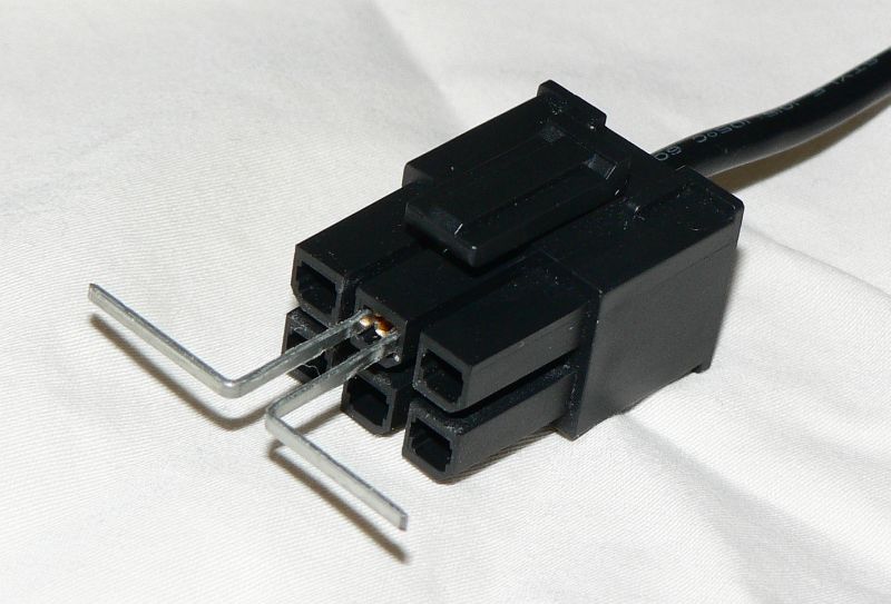

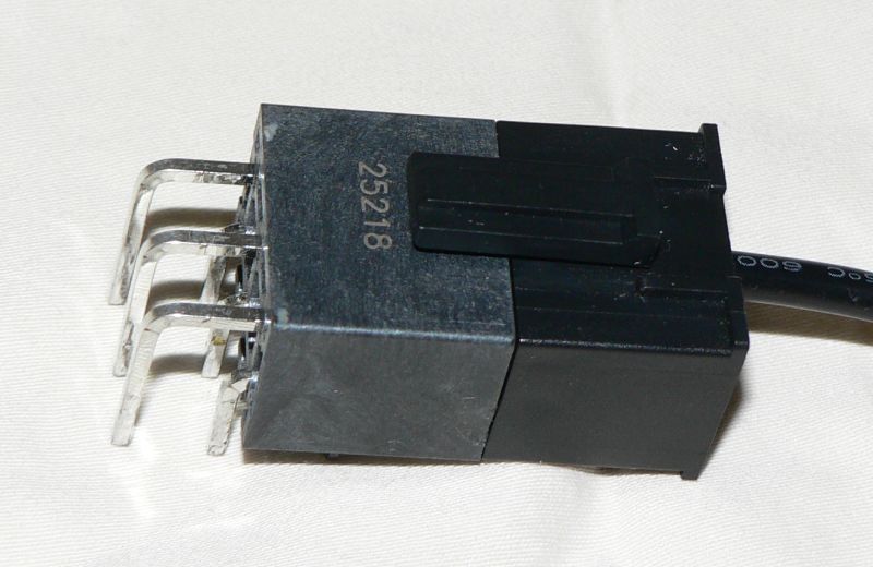

I found a tip on Youtube for removing wires from the Molex Mega-Fit terminals without buying the super expensive tool.
All I used was two 12mm Powershot staples with one leg on each straightened. The long leg is placed in each side (vertical sides) of the terminal and then pushed in to unlock. The wire then drops out. Not my idea but saved me some hassles with wire removal.
