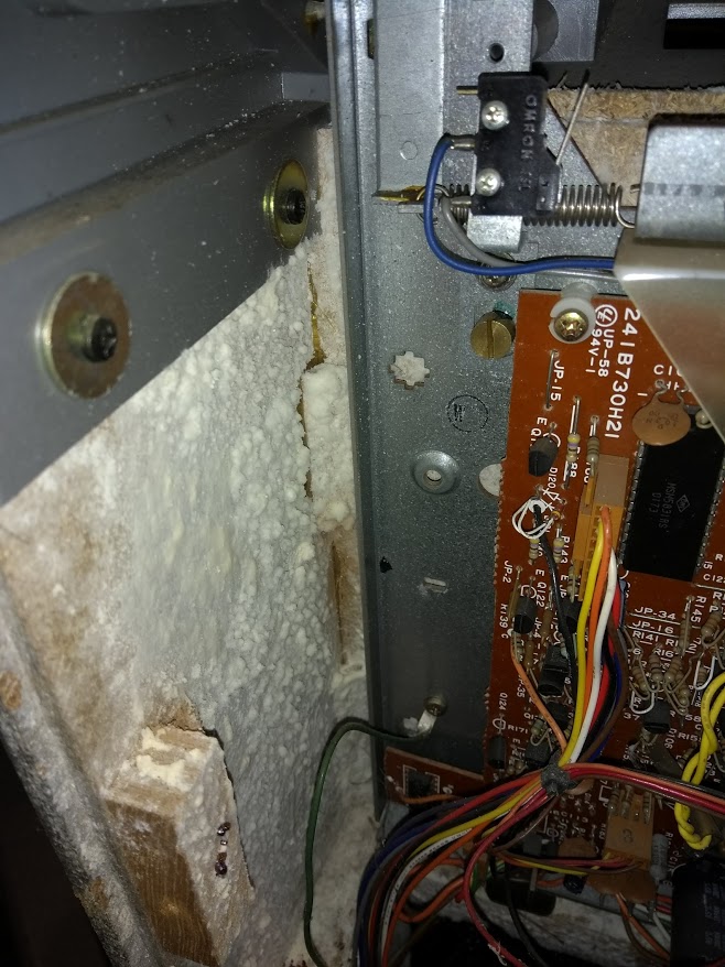

I bought a Mitsubishi MC-8000 off eBay in need of restoring. Its a vertical, liniar tracking turntable/amp/tape/radio combo. Been after a vertical turntable for a while and this was silly cheap so I thought I'd get it to tinker with. I ordered belts and replacement bulbs for the light sensors (common fault) and got around to opening it up today.
As you'd expect the belts are 100% perished. Good news is all the motors seem to work. Its not in bad shape considering its been in a loft for years.
Shared album - Google Photos
What I didn't expect so see was thick white mold covering about 50% of the insides :( .

I'm looking for an effective way to kill the spores and remove the mold without having to completely dismantle the whole thing. Basically anywhere on the chassis where there is woo, there is mold. I think maybe the perished belt had fed it somehow!
Is there a dry spray you can use to kill the spores? Or can I just wipe it all off with a soapy damp cloth? I'm guessing bleach isn't a good idea?

I can see the pics in your first post. I have had stuff stored in lofts that have not been ventilated properly and moisture has allowed this sort of thing to happen. Mine was in an amplifier.
I would be inclined to scrape off as much as you can using a thin bladed palette knife (wearing a mask) and then clean all the area with a solvent based quick drying product maybe something like this :-

Frankly, I would remove all that wood, take it far back on my neighbor's land, and burn it, standing far back. Or bag it and send to landfill. You can't ever kill the spores with anything that won't dissolve the wood. It may be innocuous when dead-dry, but WILL spring to life with any free moisture. In a house frame, sometimes you have to just run the de-humidifier to stay well below 80% RH (in the dankest corners, which means <70%RH in the middle of my cellar) until you can sell the house on. If this is a play-thing, set it on a heating pad so it dries and stays dry. (Note: newer heating pads have auto power off.)

Here is your image direct from Google. This works until you remove it from Google or Google goes out of the pic-host business (they already ate my Picassa). It does not display well in-post.

Here is the image Attached to this post and hosted by DIYA server. I gave that obscene URL to DIYA, it fetched and hosted, and gives a convenient thumbnail. It is possible to re-code that to an in-line image. However even just 658x878px is really too big. Best to let it pop-up when desired.
