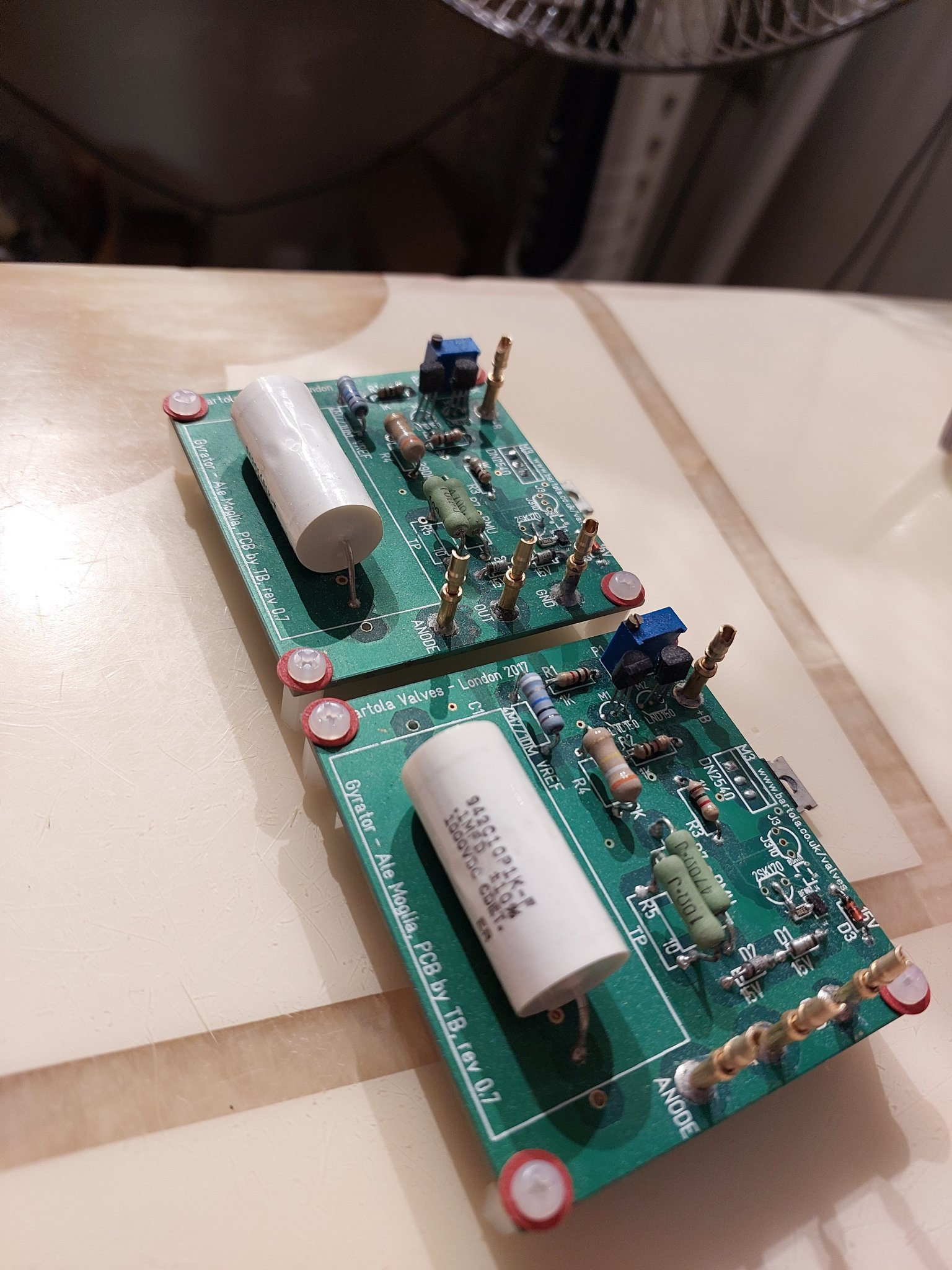

It is as per schematic in the link, I built the board and it works just fine. Value is 330ohms. Determining the right value of R8 to get a the led to indicate properly is a little more annoying.
I use 67ohms for 30mA and I wish the led was a little more 'lively'.

There is no error. Prior to v8, R9 is not included. It will work fine without R9, i have built v7. However, it is added in v8 to avoid oscillation for some high gm mosfets eg. BSH111. In the link you posted, the schematic is updated to have R9. I did some minor surgery on my v7 boards to include the gate stopper resistor after some time, just in case.
I have used BSN20 and CPH3910 without the gate stopper resistor without experiencing oscillation. I honestly think j113 would be fine without r9.
But with the BSH111, there is oscillation. This transistor has been a constant reminder from Moglia regarding oscillation. After i installed the gate stopper resistor, i did not put on the BSH111 again to try because i am very happy with the CPH3910.
