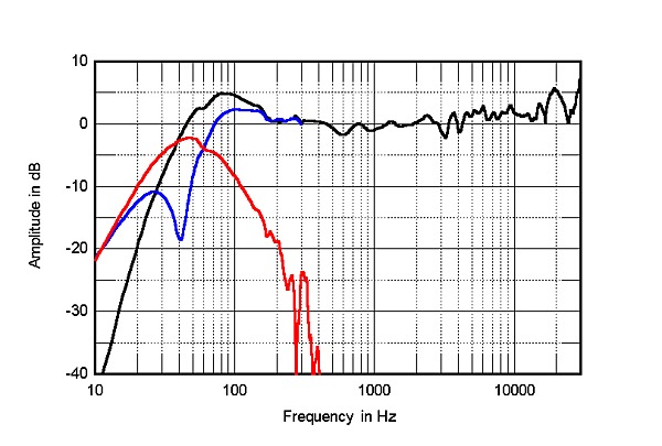

The normalized dispersion charts are really interesting.
Needs some tweeter delay to get it lined up.
dave
The step response would be great if the tweeter would run 0.2 ms late, but thats quite a bit of delay for a passive xover and would require higher order slopes to obtain. Would be interested in seeing the driver design, specifically the HF element. Suspect its crossed around 1.5k based on the impedance plot.

Mofi sourcepoint 10 looks very good being a coaxial, see measurement at stereophile, see figure 8 here https://www.stereophile.com/content/mofi-electronics-sourcepoint-10-loudspeaker-measurements
The tweeter frequency response looks very good with no severe dips, do anyone here have first hand experience with this coaxial driver?

The tweeter is a smidge ragged, but by no means bad. The normalised dispersion out to 10KHz is very interesting.

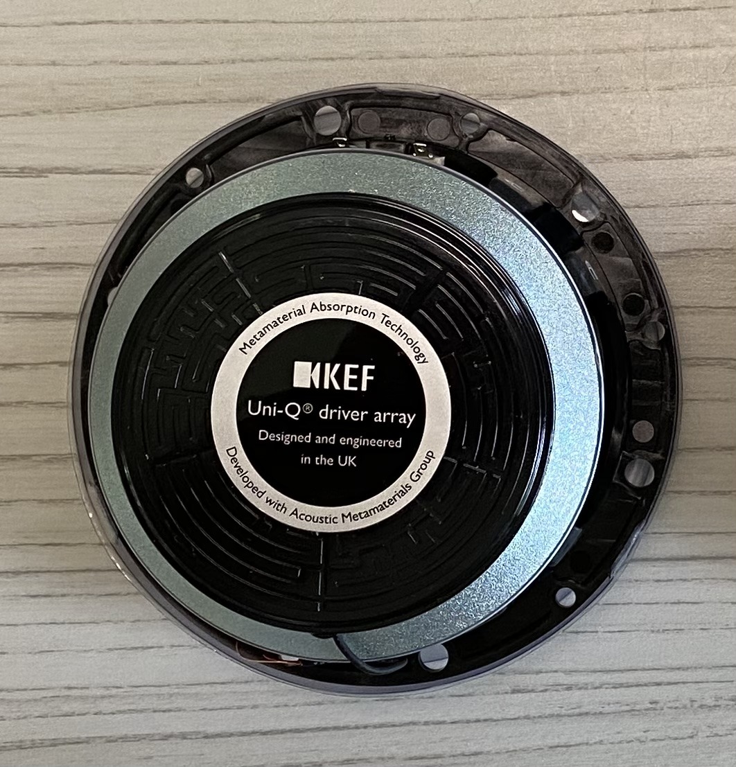

The idea to build our own top flight true midrange coaxial is being considered... made in small batches but at low costs for DIYers to use.

Our MF+HF will do only 150Hz upwards, like the KEF Blade/Reference Meta UniQ MF+HF
For a woofer with significant x-max, + (MF) + tweeter + coincidental there’s BMS, RCF etc

@tktran303 : Andrew Jones give a relatively transparent overview of these and other issues in the Sourcepoint 10 whitepaper. I was referring to the distortion generated by the motor, not touching on what you brought up about modulation of the tweeter wavefront by the moving woofer cone. Physics is physics. The cone has to move to work, so you cannot eliminate that only minimize it. If you constrain the driver so that it does not need to move much by only operating above some frequency that will reduce IMD dramatically. That is also one reason why AJ used a relatively larger woofer for a coax, the largest he has ever tried or so he told me. I chatted about it with him on the phone for about an hour. It's a pretty impressive driver all in all. He designed it himself and then had them built in one of the usual MFG houses.
