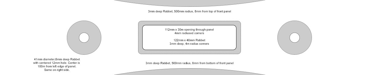

I'd like to be about have some areas on a 10mm front panel routed out for aesthetic purposes. If I pay for reanodizing after machining, will the machining marks be removed (e.g., will the routed areas be approximately as smooth as the flat front panel)?
Thanks.
Hello Jay,
It depends on how your panel needs to be machined. Most of the times if the surface is flat enough we sandblast the panel to remove the machining marks but in some cases they are still a bit visible even after the anodization.
If you already have a drawing feel free to send it to me so I can have a look
Slimline 2U front panel

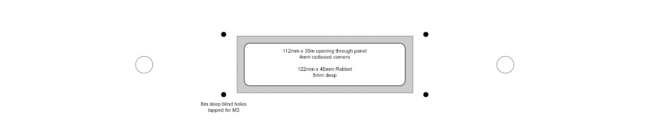

Hi Gianluca -
Attached are preliminary drawings for what I have in mind. The first is the front (outside) of the front panel, and the second is the back. This will be for a Slimline 2U chassis.

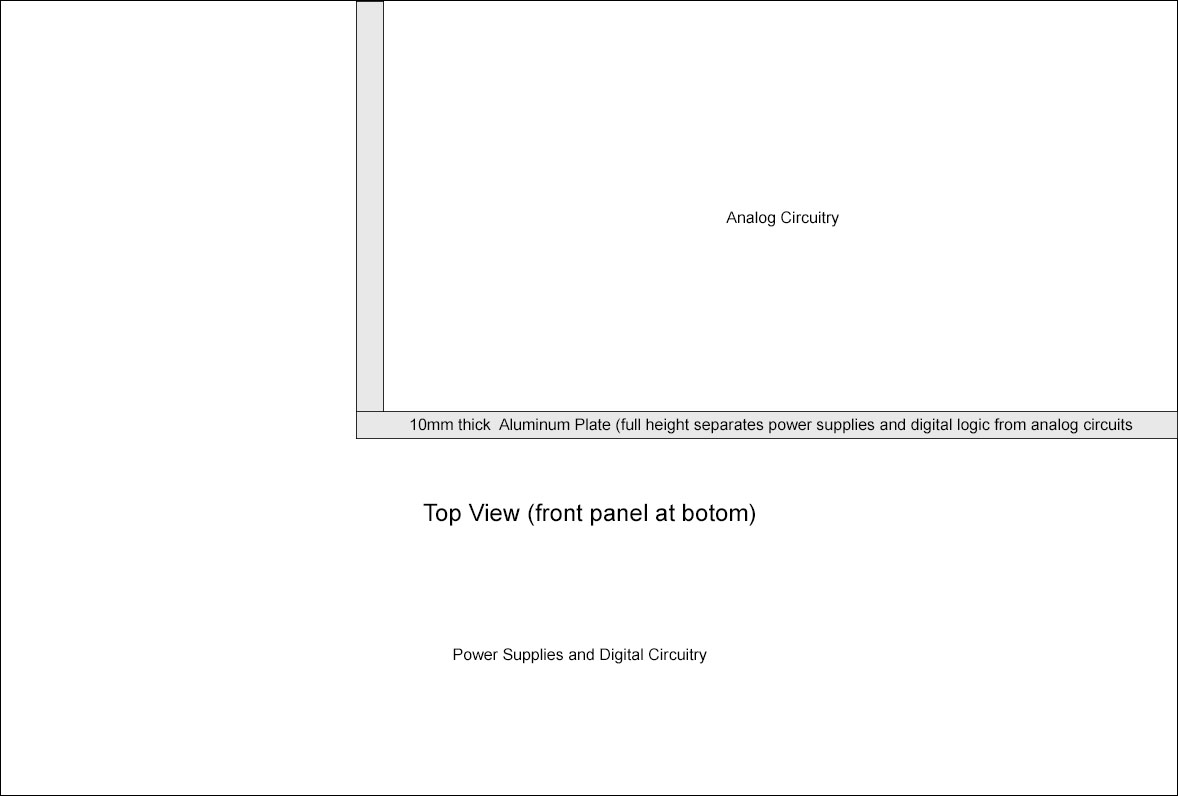

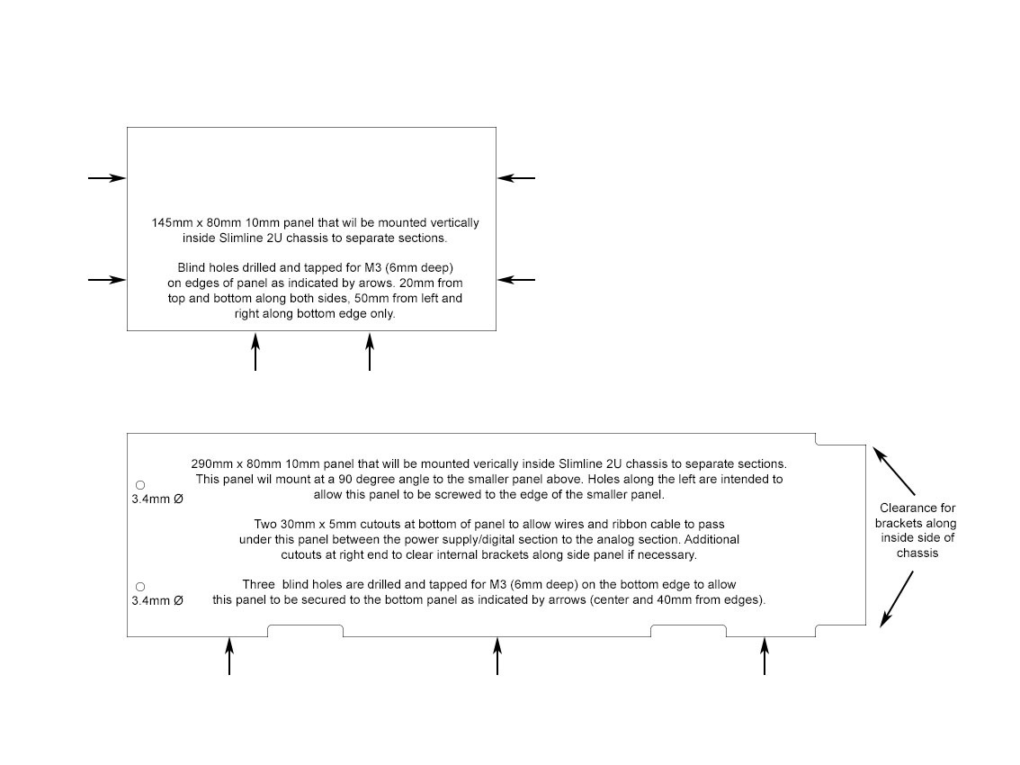

Guanluca - Are you able to do additional custom panels? I would like to add two internal rectangular panels (6 to 10mm thick) that would go top to bottom inside the Slimline 2U chassis to separate the digital and power supply circuitry from the analog circuitry. These would require tapped blind holes along the edge of the panels to secure to the bottom panel.
Can I order these by paying for an extra 10mm front panel and CNC charge?
Thanks,
Jay
Internal panels
I've attached two drawings to show what I have in mind. The first drawing shows the two panels, and the second shows how they will fit in the Slimline 2U chassis (top view).
