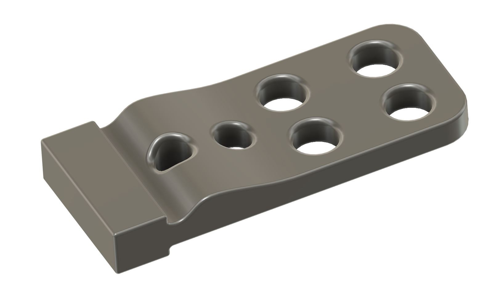

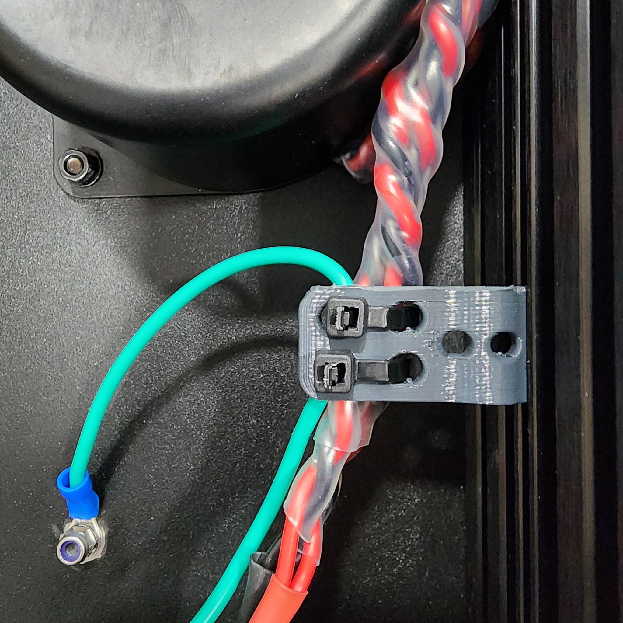

First post is a very simple wire post that mounts onto a chassis wall and allows zip tie connection of wiring. Inspired by wiring structural support posts in Aerospace industry. Until *.3MF and *.STL files are allowed for file attachments I'll be using ZIP files to convert the files to something sharable on the site.
This part slides into the slot on the Modushop extruded chassis sides and is a nice tight fit. After sliding into the slot and finding optimal location, simply use zip ties to hold the wire to the post. The main mount holes can accept 5mm wide zip ties. The additional inner mount holes in that are centered on the part can accept 4mm wide zip ties.

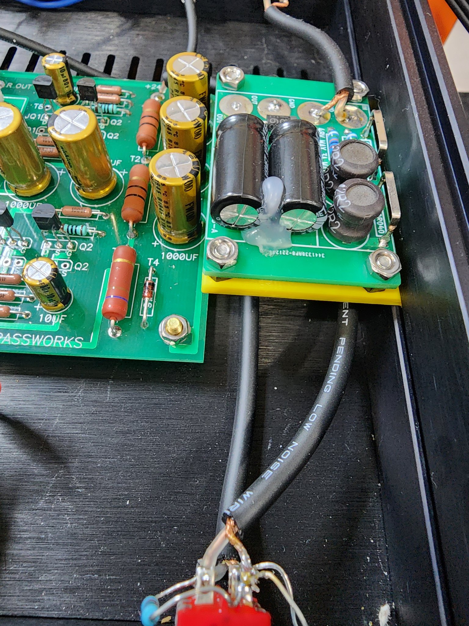

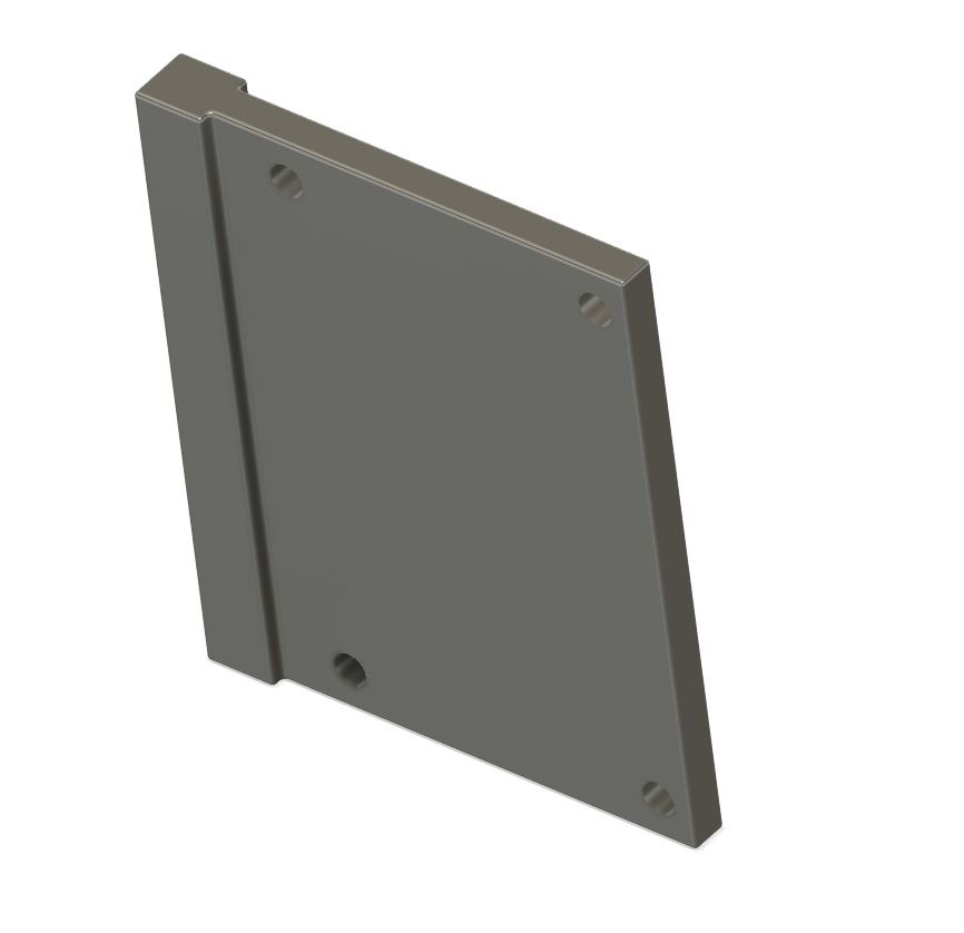

Here's a simple mount for the SMPS filter kit available through the store. It allows the kit to be mounted to a "beam" that slides into the side slot on the standard Modushop chassis extruded aluminum sides. You just need to be sure to mount the extruded side in the proper orientation so the inside slot that the mount slides into works for your purpose. The 3D printed part is yellow in the picture. M3 bolts "thread" into the plastic PLA and hold tight as mounting points.

Yes StevenCrook, you are pointing out a very important line of demarcation, that using 3D printed materials are susceptible to high heat. Very important point to clarify that, so thank you for making that point clear!
However, for preamplifiers like Korg and Iron Pre, we're not dealing with heat dissipation of class A, so thermal deformation is a non-issue in this case. For example, I have been using the SMPS filter board mount in my Korg B1 for many months with zero issue. Heat is not a concern in this case.
So lets be clear here,... Do not use 3D printing for high heat environments such as Class A amplifier heat sinks.

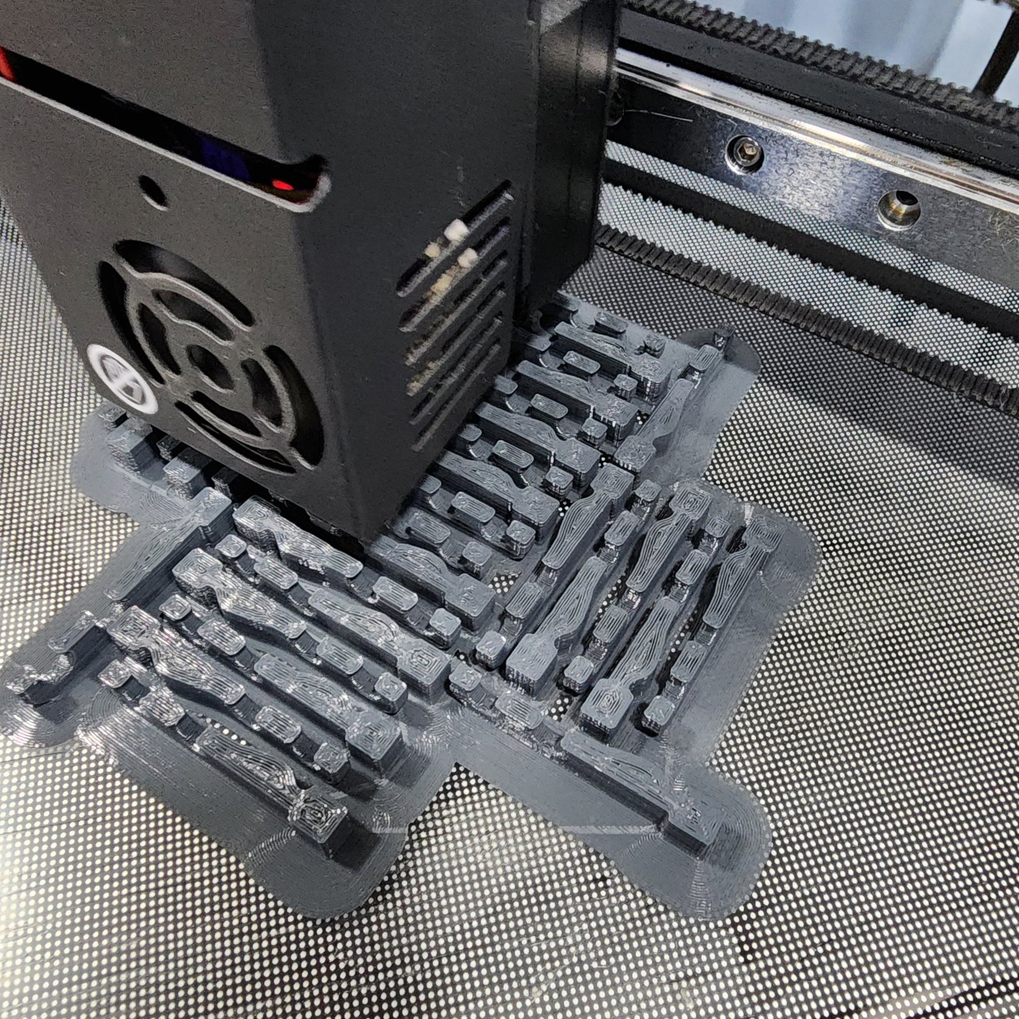

Here's the crux of this 3D print design sharing idea. These sort of designs are so simple to create, and so cheap to make, that it's nearly "free' if you can find a buddy with a 3D printer. Since an "Ender 3" printer (or similar cheap hobby printer) can be bought for under $200, I suspect a lot of us can find someone willing to hit the "print" button if someone else has validated the design works. Heck, I'll print either of the two designs I've posted above for free if someone is willing to pay shipping for the parts. The machine does all the work, so it's just matter of material cost, which is pretty darn low. I hope this thread is a way for those with the means to 3D print to share with others who don't have that means. That's the intent anyway.
