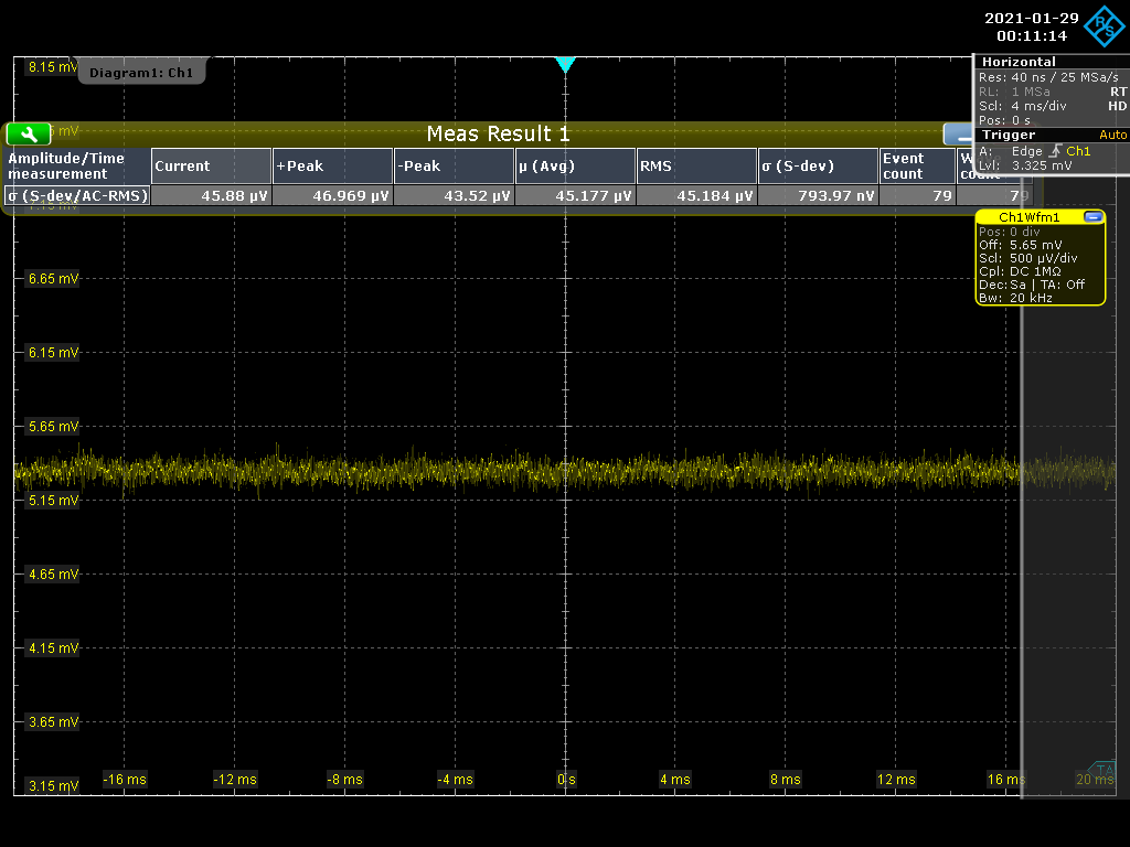

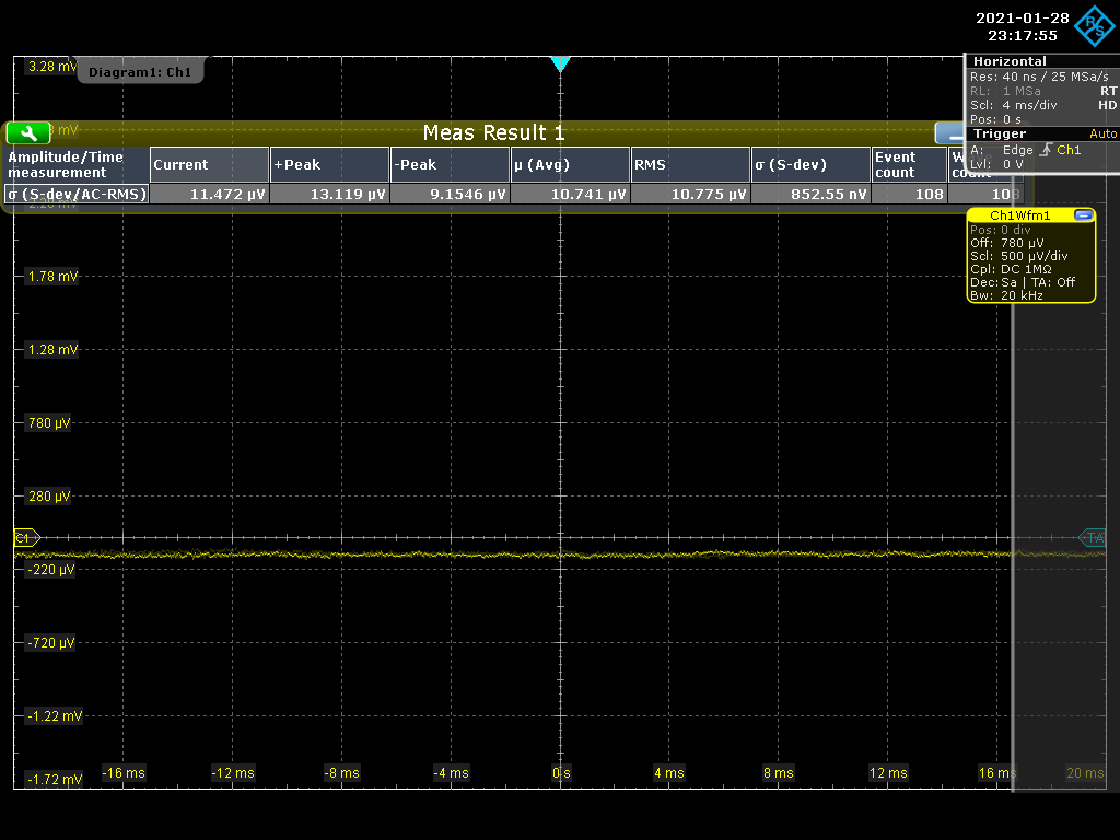

So, here I would like to show the noise test result of my personal Myref FE, with a moderate BOM setup, and my preferred 'standard' Fet input opamp (OPA828) configuration.
The load is 7ohm, the input is shorted, the bandwith of the scope is set to 20kHz, and the AC RMS measurement is turned on.
First screen is the scope baseline measurement, with (scope) input shortened. Readout: 10,77uV AC RMS.
The second screen is the actual measurement, with the FE amp on, input shorted, scope at 500uV/div max resolution. Readout: 45,2uV.
The readout is the quadratic sum of the scope noise + real noise contribution of the amp. After quadtatic subtraction the FE contribution is sqrt(45,2^2-10.77^2)= 43,8uV.
Plus, this is not a proper steep wall noise filter, so it could be a bit even less. But let's take it for good, so this is 43,8uV total /31,6 gain = 1,4uV input referred noise.
As mentioned before, of this total a great part is from the input series RF filter resistance, 3,3kohm thermal noise. That adds like 0.65 uV input referred noise to the gain structure's inherent noise.

Wished to add that it was taken from a full, operational, daily use amp, equipped with a 300VA Talema toroidal /channel. On an MDF board, no chassis & screening.
Why am I showing it? Because the modul what Tom has measured, was given to him 3? 4? Years ago. In the meantime some other options, configurations has stabilized in the community. The FET opamp option became part properly in this present, active last group buy.
Again: I am not doubting Tom's result. That was taken with the original LM318 control opamp in the composite structure. That result still could be valid for a module with classic BOM.
I will measure also that, but right now I don't have one assembled with LM318..

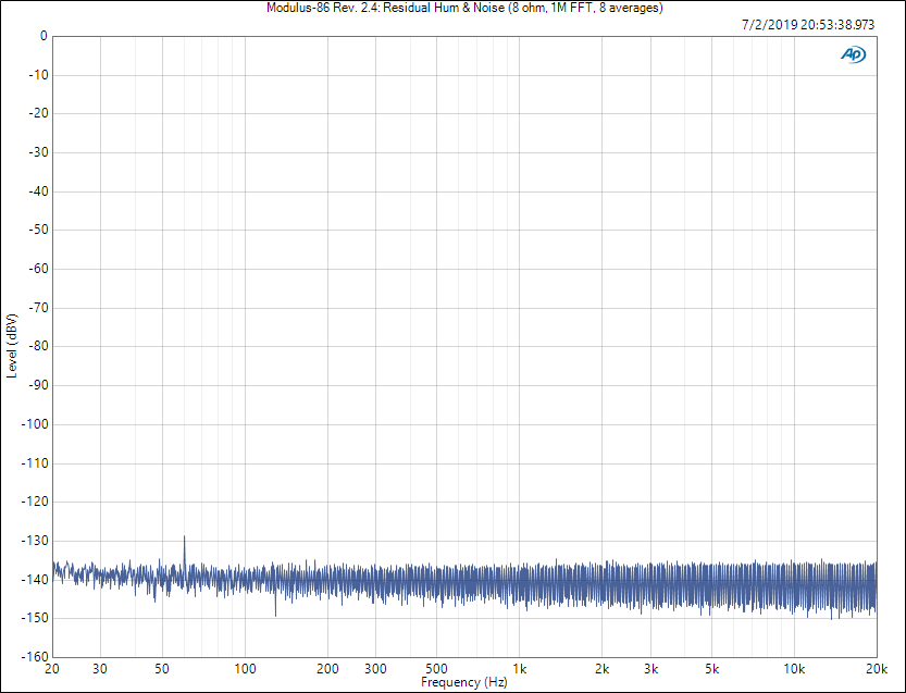

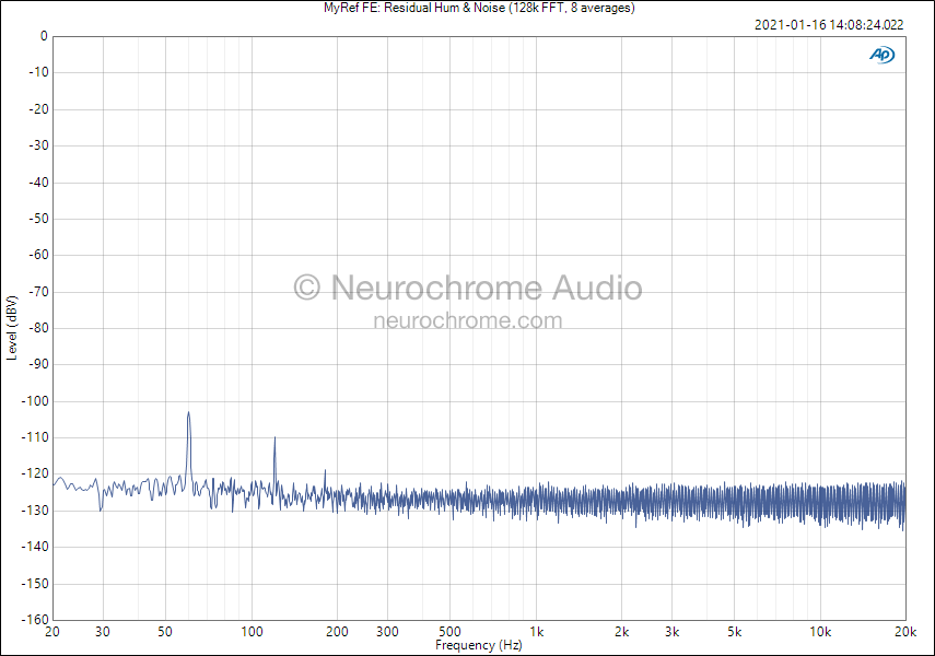

Let us take this little confrontation: you have provided the measurement of the noise floor, while idling, for both amplifiers. First is the Myref floor, second graph is the Mod86 noise floor. Both with the same instrument, same lab PS:
I really do think that You did a very measured, decent presentation of a 'third party' product.
So I would like to thank You again. And a bit I feel uncomfortable about being polemic, so I try my best of being as little as possible..
But.. I feel Your testing provides some real nice examples about how objective testing can result in say.. Hm.. Providing some 'directionality' for the interested public?
You say:
"how a calibrated Audio Precision APx525 can be biased in its measurements."
Now, what will be the reader's impression?
And a second impression? In the Myref graph, a 128kpoint FFT is used. In the Mod86 graph, a 1Msample FFT is applied. That is 8 times, 2^3 times difference between the two. That means 3 * 3dB noise floor advantage for the Mod86 spectra.
So we should move the Myref spectrum floor 9db downwards, to be correct in the analysis.
That is, from ~-126dB to - 135dB. The Mod86 graph stays at - 140dB floor.
That gives at once a much closer an impression than the original presentation.

But we did not finish yet. As told before, the the Myref provides 30dB gain, the Mod86 20dB.
Now, when I try to understand noise contribution of a device in the lab, the two things which I 'normalize' first, is resolution bandwith (here FFT length) , and device gain..
So for equivalent gain conditions, we have to 'take away' another 10dB from the Myref noise floor, which after this arrives at - 145dB.
That is 5dB lower in reality than the Mod86, initially appearing much less noisy..

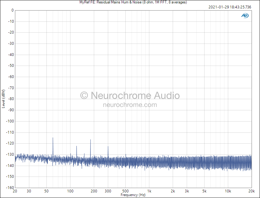

You are correct. I have switched to shorter FFTs more recently as I didn't need the frequency resolution of the longer FFT. The noise floor of a longer FFT will appear lower than a shorter FFT as the FFT bin width is smaller for the longer FFT. My bad.
Attached you will find the 1M FFT of the residual hum & noise of the MyRef FE. I've attached the one for the Modulus-86 as well for reference. I used the same HP 6643A lab power supplies and the same 8 Ω dummy load for both measurements.
I will update my website to include the 1M FFT for the MyRef FE and will just stick to that from now on. Thanks for bringing that up.
The 69 uV of residual hum & noise I measured on the MyRef FE is measured by the voltmeter in the AP. It is independent of the FFT. I'm just stating this for the record. You would get the same result with a good bench top DMM (HP 34401A, for example) and an AES17 20 kHz filter.
