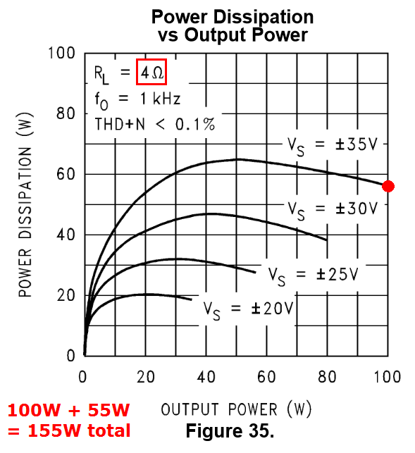

2x22 VAC gives about 28 V rectified when accounting for the current draw of the amp under modest load. With the Antek AN/AS-2222 I typically see a tad above 30 V at idle for nominal mains voltage.
The LM3886 is guaranteed (tested) to be able to deliver 7 A minimum of output current. That means the highest rail voltage that's guaranteed to work is 28 V for a 4 Ω load.
I also prefer to operate the ICs at no higher than 40 W of dissipation as this makes the thermals more manageable. You'll find this recommendation in the BPA-200 app note as well.
Those are the two main considerations that lead me to my recommendation of ±28 V rails for the LM3886 if used with 4 Ω loads. For 8 Ω*operation, you can crank the voltage up to ±35 V.

And if they're driving 4 ohm loads, attach a thermal cutout to the power transformer, because you'll exceed its 330 VA rating if you turn the volume all the way up.... I'd recommend one Power-86 board per side (= woofer + mid + tweeter amp).
For sine wave operation, you are correct. However, most of us listen to music rather than sine waves.
For music, the power draw depends on the crest factor of the music. Assuming a 14 dB crest factor, each channel would require 87 VA. Also, for a 3-way, this would mean delivering full power to all speaker drivers, continuously. This seems like a rather unlikely scenario.
If you're curious about the math behind this, I suggest checking out my Taming the LM3886 pages.

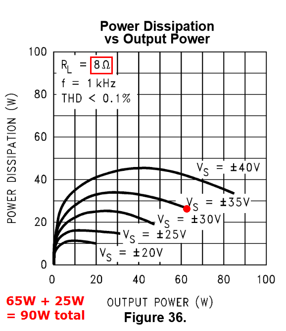

Thank you all kindly for the replies. Speakers I'm building should be an easy load, not only are they 8 ohms, but with efficiency of 97dB/w/m I probably won't often turn it up very far.
I suggest you do some engineering calculations..............................You could start by looking at the LM3886 datasheet to estimate how many watts each amplifier PCB will draw from the power supply, when delivering output power to a loudspeaker load. ..................... estimate the voltage sag on the power supply when driving a heavy load. You know the PSU board's filter capacitance C, you know the load current I (it is simply N x loadpower_per_board / 35V), so you can calculate dV/dt. You know dt, it's 8.3 milliseconds (US) or 10 milliseconds (EU). So calculate the sag, dV..............free power supply analysis software called PSUD2. ................
I agree with all the above....................... For 8 Ω*operation, you can crank the voltage up to ±35 V.................
A +-35Vdc supply at quiescent demand will sag significantly when asked to deliver full power.
Expect at least a 3Vdrop from quiescent voltage. i.e. +-35Vdc drops to less than +-32Vdc
Using the 8ohm plot in post1771, you will see that the lm3886 can deliver ~72W into 8r0 and dissipate ~29W (well below Tom's <40W recommendation) while this power is being delivered. From my own experiments and measurements I find much less than 68W from +-35Vdc and this has led me to using even higher quiescent voltage, I have gone as high as +-39Vdc and found no problem provided a decent size heatsink is used.
Only bass duty will stress the amplifier to near continuous power delivery, mid and treble duties are transients that last for very short durations, but repeat often.
The heatsink demands for mid and treble can be pretty low, because the duty cycle is low. Look at the dissipation when 1W is being delivered. 1W delivered into mid and into treble is very loud, but dissipates ~5W into the heatsink and the two amplifiers draw a total of 1+5+1+5 =12W. The bass amp could be 2W to 3W of average delivery and ~10W of dissipation.
The total average draw from the PSU for a 3way active could therefore be around 25W, for three channels rated @ 65W+65W+65W into 8ohms when supplied with +-35Vdc
The average dissipation load for the combined heatsink will be around 20W. A 0.5C/W sink will rise by ~15Cdegrees and will feel quite warm.
This shows that the first sentence made by Mark
