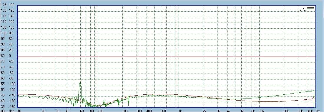

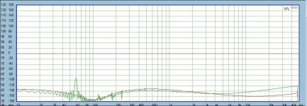

Here is an example of what can happen if you only consider point data.
As shown in the green curve of the attached file, my measured data of the XL280 which was built from a kit. The bass was never well defined with this amp, and as we can see, there are some problems shown in the damping data. The red curve is one of the MyRef configurations I played around with which I do not recall specifically which.
Now, from the damping specs of the XL280, can you imagine how the green curve can result?

The only thing your plot shows is that you have an issue with mains hum in your setup. That's why you get the peak at 60 Hz and crud at 120, 180, 240, ... Hz. The ringing before and after the 60 Hz peak looks like an artifact of the sampling, either a pre/post IIR filter response or sampling window response.
You used this measurement of mains hum to support your perception of the bass not being well-defined (which may/may not be an accurate perception). This is experimenter bias and/or confirmation bias.
For the measurement to show anything meaningful, you need to remove the ground loop from the system and remeasure. With the interest gathered here, I'm sure you will be able to attract quite a few people to help with the debugging of your setup if you start a new thread, for example, in the test & measurement forum. I'll be happy to participate there to the extent my time allows.
~Tom
The way it is measured is explained in the link I provided. If it is not understandable, I don't think I could explain it better.I can see no explanation of what that is a graph of and how it was measured. Just lots of graphs with no coherent attempt at analysis.
The point is not discussion of the Hafler amp, but why I like to look at measured curves instead of point values. The Hafler amp was built from a full kit with professional document. It demonstrates anything can happen when building a kit, even with something documented like the Mod86. Hafler also provided point inspection procedures, and a difference measurement method. All parts came directly from Hafler.The only thing your plot shows is that you have an issue with mains hum in your setup. That's why you get the peak at 60 Hz and crud at 120, 180, 240, ... Hz. The ringing before and after the 60 Hz peak looks like an artifact of the sampling, either a pre/post IIR filter response or sampling window response.

I am more interested in seeing what the Mod86 curve would look like.
I still am none the wiser to the X axis or scaling tho.

So basically you have the same information I had when I started. Based on that, I just dug in and get my hands dirty to fully appreciate how the I formation relates with listening impression.
90db in my plots equate to 0db in his plot.
