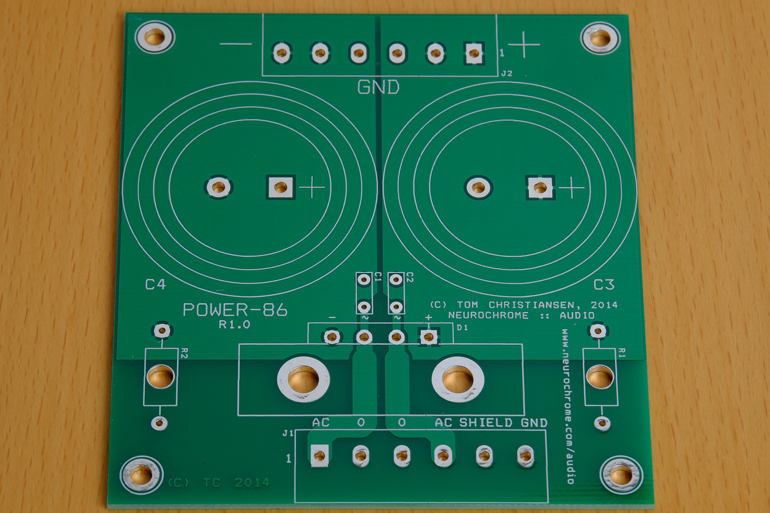

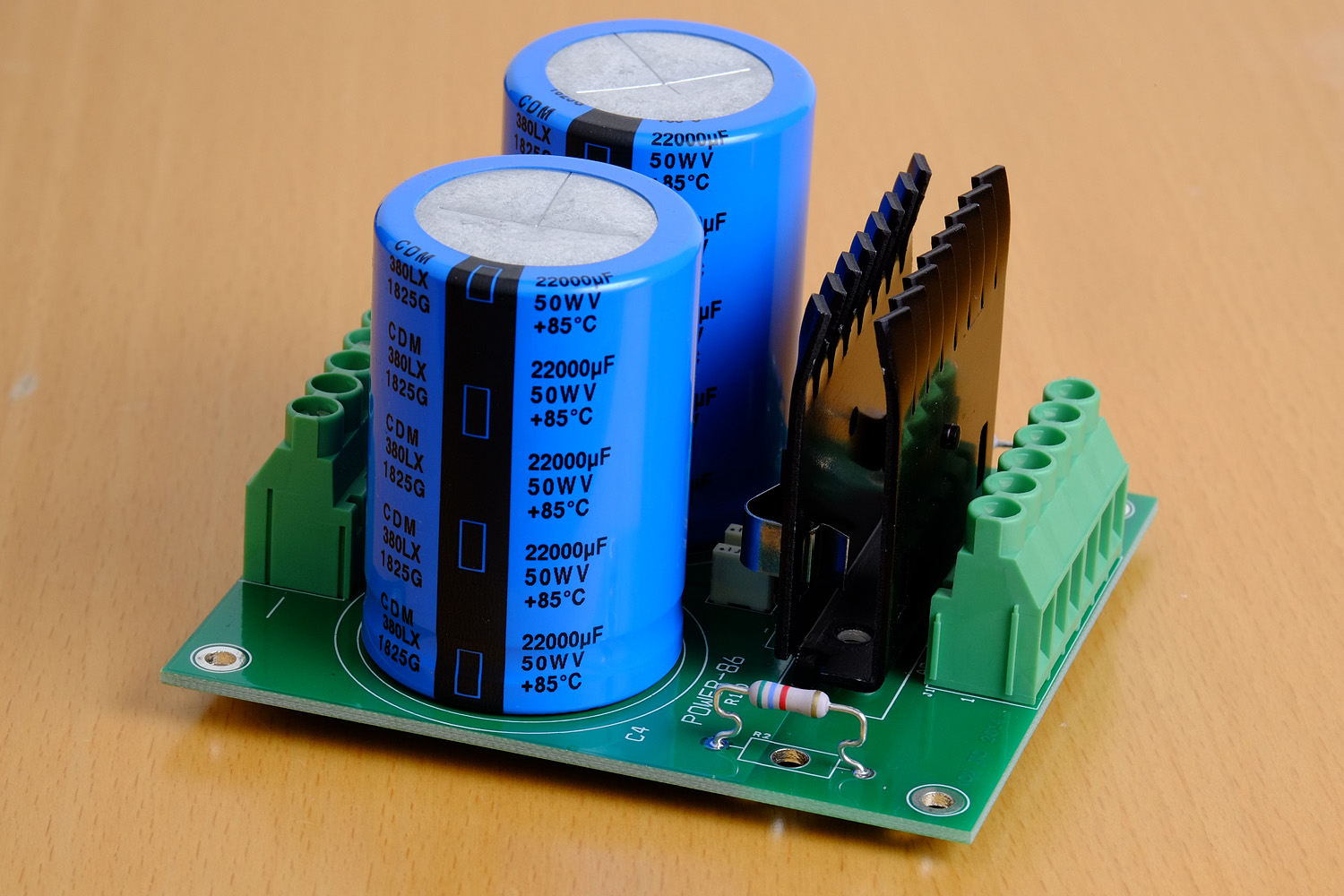

The Power-86 boards are now in stock and available for purchase on my website.
One Power-86 board is optimized to power the two Modulus-86 boards in a stereo amp. The Power-86 board can easily power one Modulus-86 board in a mono block and/or multiple Modulus-86 boards in a multi-channel configuration.
The largest electrolytic capacitor diameter supported on this board is 40 mm ±1 mm. The board is designed for use with snap-in capacitors with a pin pitch of 10 mm.

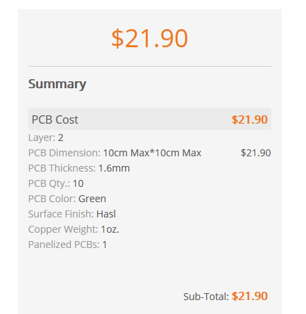

Wow! $50 for an 84mm x 92mm printed circuit board that holds 10 components (2 connectors, 2 electrolytics, 1 bridge, 1 heatsink, 2 resistors, 2 film capacitors). $50 for the bare board!
DIYers who have the confidence to lay out their own printed circuit board, may be motivated to consider alternatives. Seeed Studio will custom build ten PCBs this size, for $37. ($22 for the fab plus ~ $15 for the shipping; see attached quote). The cost is $13 lower, and you get nine extra PC boards to give away or to sell at your cost to other DIYers.
Laying out your own unregulated power supply board also provides an opportunity to modify the design, if you so desire. Perhaps to install secondary fuses (if desired), reverse-polarity rail protection diodes {Cordell ch.15}, Quick Connect I/O blades, power-is-good LEDs, ferrite beads, four individual diodes rather than a 4-in-1 bridge assembly, and many other contrivances, limited only by your ambition and imagination.

As I said in the first couple of pages of this thread, you get more than the raw board material when you buy my boards.
There are many supply boards on the market. I have seen many of them. Mine is the only supply board that has been optimized for a low supply impedance (performance). That adds value.
One of the main things you get when you buy the Power-86 board is good documentation. The documentation explains how to identify the different windings on the Antek AN-2222 power transformer and hook them up correctly to the mains and the Power-86 board. For experienced builders this may be no big deal, but for builders towards the beginner end of the spectrum, this is a significant source of anxiety, which is further magnified by the choice of wire colors by Antek. My step-by-step instructions will allow the beginner builder to get the wiring right the first time. This adds value.
If you buy my Power-86 board, you get a link to a project set up with Mouser Electronics. To order the correct parts, that will fit the board and provide the advertised performance, all you have to do is click "add to cart" and check out. This adds value.
In addition, I plan to fully characterize the Modulus-86 when powered by a Power-86 board in a stereo amplifier. This way, the customer can get a full end-to-end spec and be confident in the performance of their build.
The value proposition of Neurochrome is simple: I provide well designed, well tested, well characterized, and well documented state-of-the-art circuits. I perform my testing and characterization using state-of-the-art equipment. I also support my customers and take pride in their success. I believe this quality level is worth paying for.
