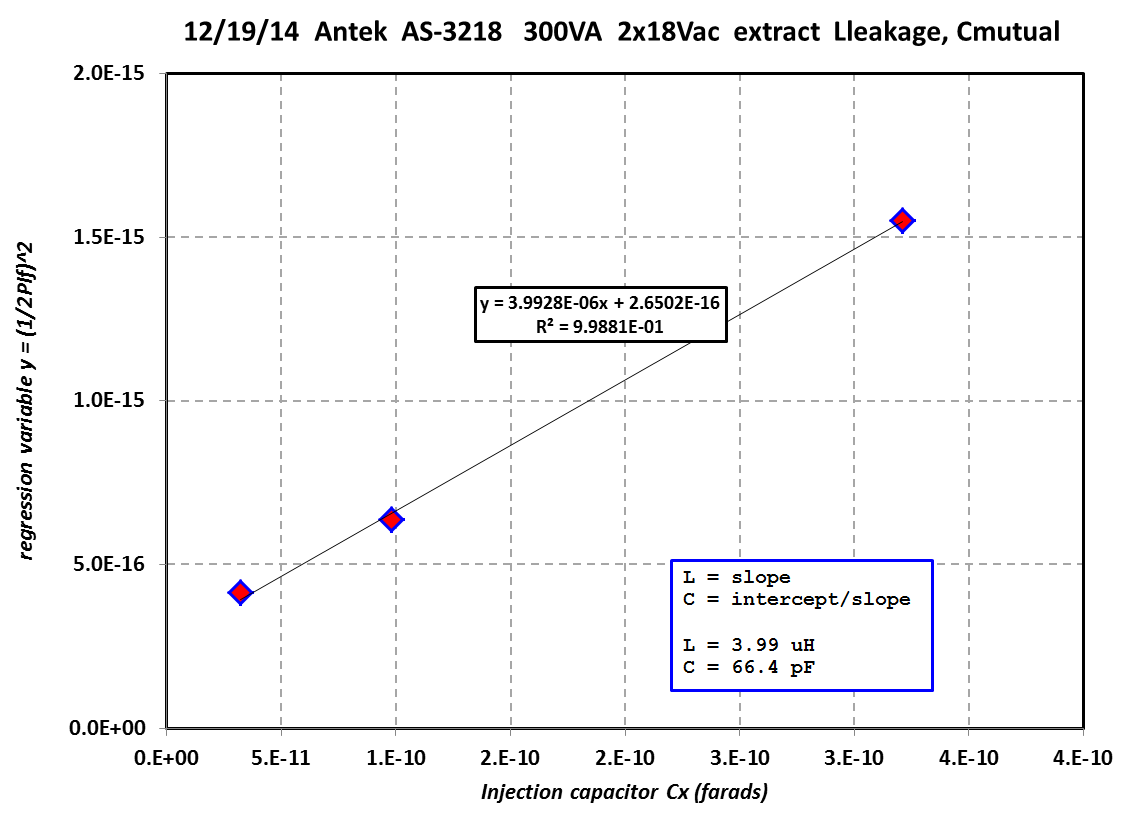

Tom, I have some good news. The GBPC2510 / KBPC2510 bridge rectifier that you plan to use (see post#205) appears to be a medium-to-low capacitance device: 146pF @ zero bias, according to the spice model provided by Diodes Inc, and 435pF @ zero bias, according to the spice model provided by Vishay. As a further double-check, the 35 ampere bridge rectifier spice model on the Cordell Audio website, says 500pF @ zero bias.
This is good news, because the diode capacitance is comfortably below (in fact way below) the 3300pF Cx value of the Modulus Toroid Universal CRC Snubber described in post#408. As desired, Cx >> Crectifier and so the snubber performance (damping factor) will not be affected by variations in Crectifier.
Although I don't have an example of the Antek AS-2222 (200VA, 2x22 Vac) toroid that you recommend, I do have its big brother: the Antek AS-3218 (300VA, 2x18 Vac). It's shielded, same as the AS-2222. I measured it today and found that the secondary winding capacitance is nice and small: just 66 pF (measurement attached below). This is also good news because it means that unit-to-unit variation in secondary winding capacitance ("mutual capacitance") will not affect snubber performance. Cx >> (Crectifier + Csecondary). Throw in another 0-200 pF for the secondary hook-up wires, the secondary fuseholders, and PCB traces; you still get Cx >> (Crectifier + Csecondary + Cwiring). Big Cx has rendered the snubber performance insensitive to variations in the diode capacitance, the transformer capacitance, and the amplifier hookup wiring capacitance.
So it's looking better and better for the Modulus Toroid Universal CRC snubber: Cx = 3.3nF stacked film; Rx = 22 ohms; Cs >= 680nF stacked film.

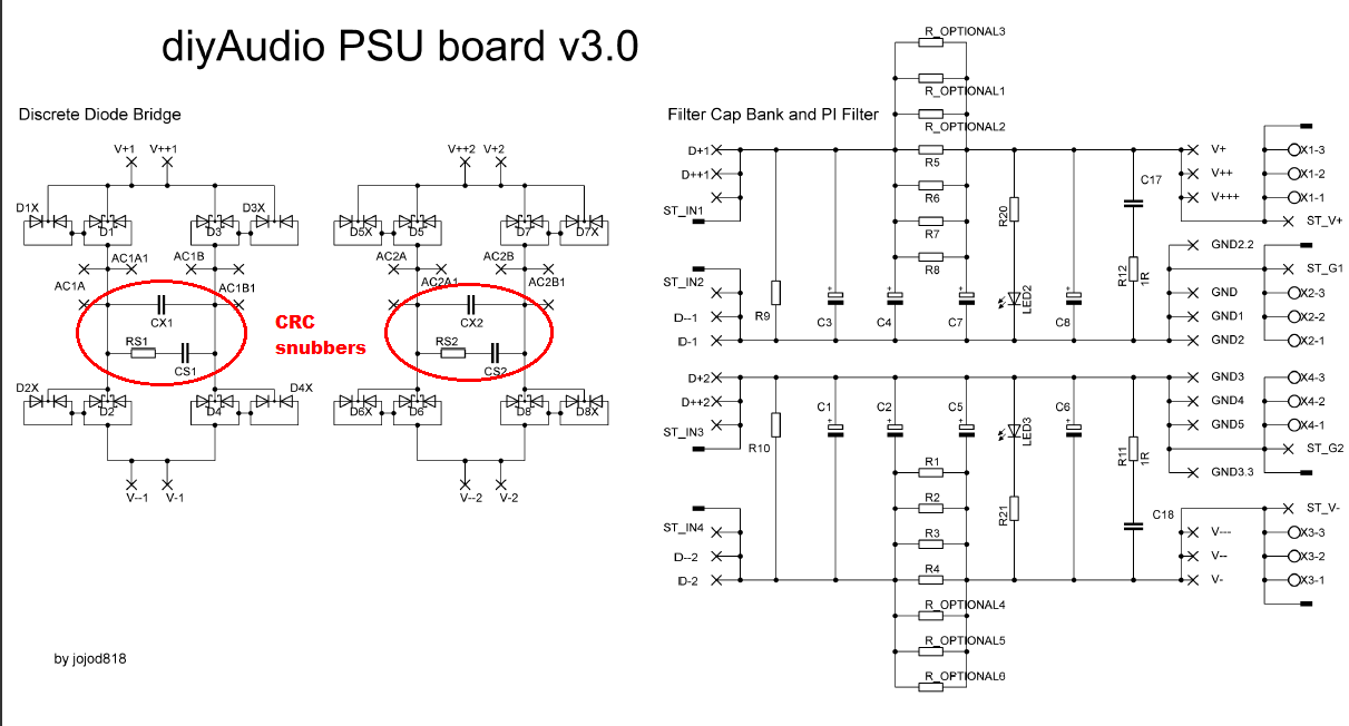

Tom, I don't think that's the best decision. I think your customers would be best served by placing a CRC snubber across each secondary, at least in the PCB layout. Then you have the option of recommending that Cx1 = Cx2 = 100nF is your preferred design, while Cs1, Cs2, Rs1, Rs2 are optional -- and you suggest omitting them.
This is the approach taken on the diyAudio Universal Power Supply circuit boards sold here in the The diyAudio Store. CRC snubbers are provided in the PCB layout (red circles below); however, it is left as an option for the buyer/builder, whether or not to populate them. It is also left to the buyer/builder to choose component values and to purchase them. (discussion thread) . I've included its schematic, below.
This has worked well, even though Universal Power Supply board buyers often don't own oscilloscopes, pulse generators, or other test equipment. But the idea of oscilloscope-less people building a snubbered power supply seems to make you nervous; in post 406 you say " ... optimizing the snubber. However, this requires that each builder has the skill and equipment to perform the optimization. Each build would have to be optimized separately as the parasitic inductance and capacitance of the transformer, wiring, etc. vary from build to build."
I think you're too worried; DIYA Universal Power Supply board buyers have navigated these waters successfully, and so can Modulus Power Supply board buyers. Besides, your board has an unfair advantage: the Modulus PS board is not trying to be universal! You are more or less guaranteed that it'll be driven by a transformer rated between 100VA and 400VA, with secondaries rated between 12VAC and 25VAC. This puts limits on the min possible and max possible secondary leakage inductance, which is the only important variable. All other variables are rendered insignificant, since they are swamped out by using a CRC snubber with large (3.3nF) Cx. Parasitic capacitance of the transformer? Insignificant! Wiring capacitance of the builder's chassis & boards? Insignificant! Junction capacitance of the rectifiers (and its variation with bias voltage)? Insignificant!
You only need to design a CRC snubber to handle a small range of secondary leakage inductance: 100-to-1, or less. This translates to an even smaller range (square root of 100-to-1) of damping factors. By judicious choice of the bottom and top ends of the range, you can provide a single CRC snubber that completely eliminates (damps) all ringing in all Modulus transformers.
Don't underestimate the pleasure and relief that people will get from eliminating that 67 kHz oscillation, the one you deem harmless. Get this %#%#%# the hell OUT of my amplifier! (they will say). Especially when the cost is only two resistors and two capacitors, many people will say they don't care whether or not that oscillation is harmless, they want it removed anyway. Killed. Snubbed to death, and the quicker the better.

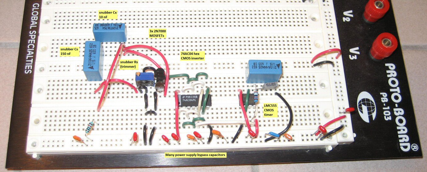

I suspect that a few Modulus builders have spent the 1.5 hours necessary to construct a Quasimodo test-jig on their solderless breadboard (picture below). I suspect they will hook it up to their Modulus transformer and upload the before-and-after waveform photos to this very thread. I further suspect that the resounding replies will be "Holy Moly! Do you mean to tell me that those nasty RF sinusoids are running around in my amplifier! And I can totally wipe them out with just two resistors and two capacitors? Sign me up!"
In my view you are trying to solve a non-issue. I have no intention to force my customer to pay extra to get something they don't need. If there was a problem, I would address it. But there is no problem. There is nothing for me to solve here.
That's fantastic. Those who wish to have the footprints available for a CRC snubber are free to buy those boards. They can also solder the two additional components onto the bottom of my board.
Those options cost money. They cost board area, component cost, documentation, testing, etc. All that to achieve absolutely nothing. There will be no measurable difference on the output of the amp. I have verified this already. Any perceived sound quality difference obtained by more complicated snubbers are in my opinion caused by confirmation bias and other psycho-acoustic effects.
