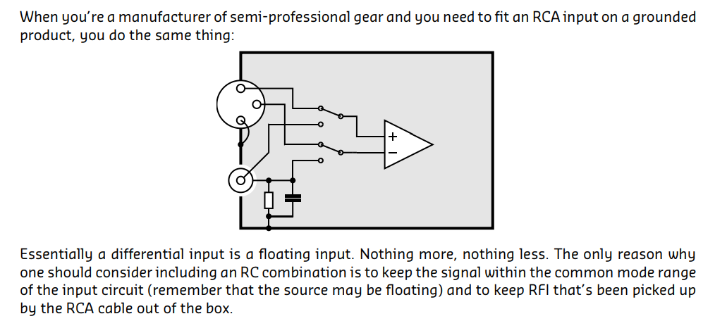

What I'm wondering about is: are these resistors (let's just say the pair of high value resistors for the XLR input) needed before the relays of the input selector board, or can they be omitted from there and the preamp (or other differential input circuit) be given the responsibility to do whatever is needed?
If you're taking Doug Self's circuit from fig. 20.5 in the power amp book, I'd probably do the switching after the two 10 kΩ input resistors, but you could just as well switch just after the input connectors. Do check the chapter on signal switching in his Small Signal Audio book if you want the switching accomplished cleanly.
I don't like the highish impedances of Self's input. 10 kΩ adds a lot of noise. So I tend to use an instrumentation amp input. It costs an extra (dual) opamp, but gives you very high input impedance. This makes life easier for the RF input filter and allows me to set the input impedance to whatever I want. With the IA input, I'd just switch the two input signals between XLR and RCA. Just keep in mind that you need to control the common-mode voltage if you sense the RCA differentially.
Tom

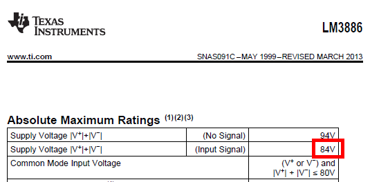

I was thinking of putting two of these on each rail, to give me 30,000uF per rail. Is that a good amount? I was just going by the formula of "100uF per rail for each Watt of rated output".
In the Power-686, you're doing 50V caps. Do you feel there's any point in the additional safety margin of 63V? And you're doing 44,000uF capacitance against the 30,000uF I was planning on. Is my reduction in capacitance acceptable, if I mostly operate the amp on 8 Ohmish loads and at "domestic" power levels?

Since you are not allowed to apply more than ±42 volts to the LM3886, you need to design and build a power supply which never exceeds that. Even when playing very softly, where the amp is only delivering 1 milliwatt to the loudspeakers. Even when the mains AC voltage is at its highest possible value (+7% in US, more in India, I am told). So if you think 50 volt capacitors are safe for <42 volt supplies, use those. If you feel you really truly need 63 volt capacitors to be double extra safe and sure with <42 volt supplies, use those.

85 vs 105 ºC affects reliability. The 105 ºC rated caps will last longer (assuming all other variables are held constant). Be careful when comparing the specs, though. A cap rated for 10000 hours at 85 ºC may outlast a cap rated for 1000 hours at 105 ºC. The lifetime vs temperature function is not linear! If you're truly concerned about this, I suggest contacting the manufacturer of the capacitors.
Many use 10000 uF (10 mF) per 100 W (8 Ω) as a guideline. So 22000 uF per rail would be appropriate (says this guideline). I'd double that.
Note that the MOD686 is not rated for 2 Ω operation. It's stable there and I have even driven a 1 Ω load with the MOD686 by accident at one point. No ill effects observed, but I would not recommend making that the typical operating point.

Pretty exciting -- @alexcp pointed me to a PDF published by the Hypex designer about grounding, and it has this diagram about connecting an RCA and an XLR in parallel. It uses a switch, however, which is more complex than I wanted to do.
My quest to figure out the perfect but simple way to have an input support both XLR and RCA continues...
