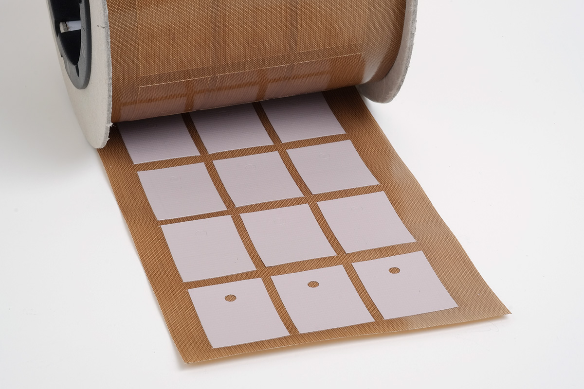

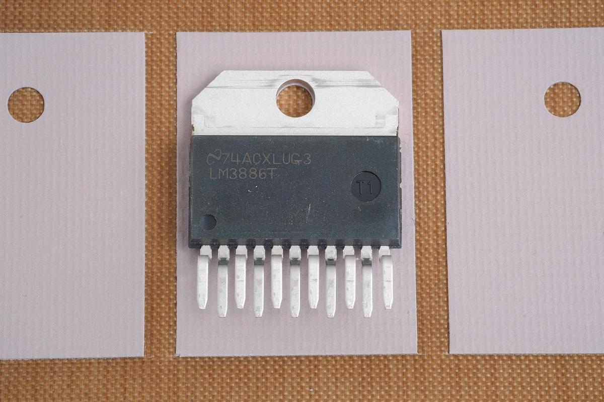

I further asked around about heat sink contact, it seems that using hard anodizing of (I think) 3uM thickness should do. It seems best to press the T package using a bar rather than the hole provided.
Yeah... It's interesting what people choose to geek out about. There's a thread around here somewhere, where someone precision machined a block of brass to make contact on all sides of the LM3886 and provide some clamping force. They claimed this was superior to the standard mounting method, but true to form provided no data to back up this claim. They also completely neglected that the vast majority of the heat is conducted through the back side of the package and very little escapes through the plastic.
There are many ways to mess up a clamping solution and fewer ways to mess up when using the manufacturer's recommended solution (i.e. the mounting hole in the tab), so I went with the latter.
I just received a roll of 1000 (minimum order quantity from the distributor) of Keratherm Red (86/82) in a size that fits the LM3886. They'll be available on my website by Sunday night. To the best of my knowledge, they offer the lowest thermal resistance of any thermal pad on the market.
Tom
Tom
Nice!
Actually the bar attachment method offers more uniform pressure and less need to align the mounting when your assemble most chassis. Right now you use a special bracket to keep alignment which would cost more and soldering the LM3886 is a bit cumbersome, the alignment would be a bit better though.
In most commercial practices, the tolerance in the PCB mounting holes would allow good alignment without introducing stress and the LM3886 legs, aligning multiple devices does take some skill and preparation though.
Another trade off is the number of contacts to the heat sink. I would go for less contact interfacing surfaces.
Actually, the LM3886es are easy to solder through the openings in the bottom of the bracket.
