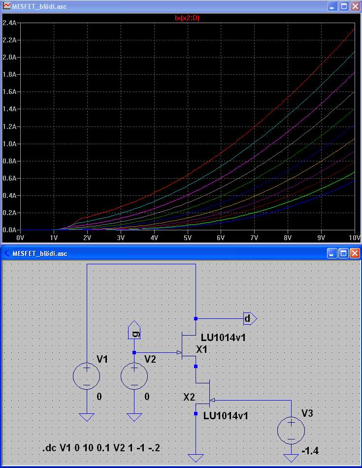

Hi Circlomanen,
if you want to play try this idea. It makes nices Triode curves.
Bye
Emil
