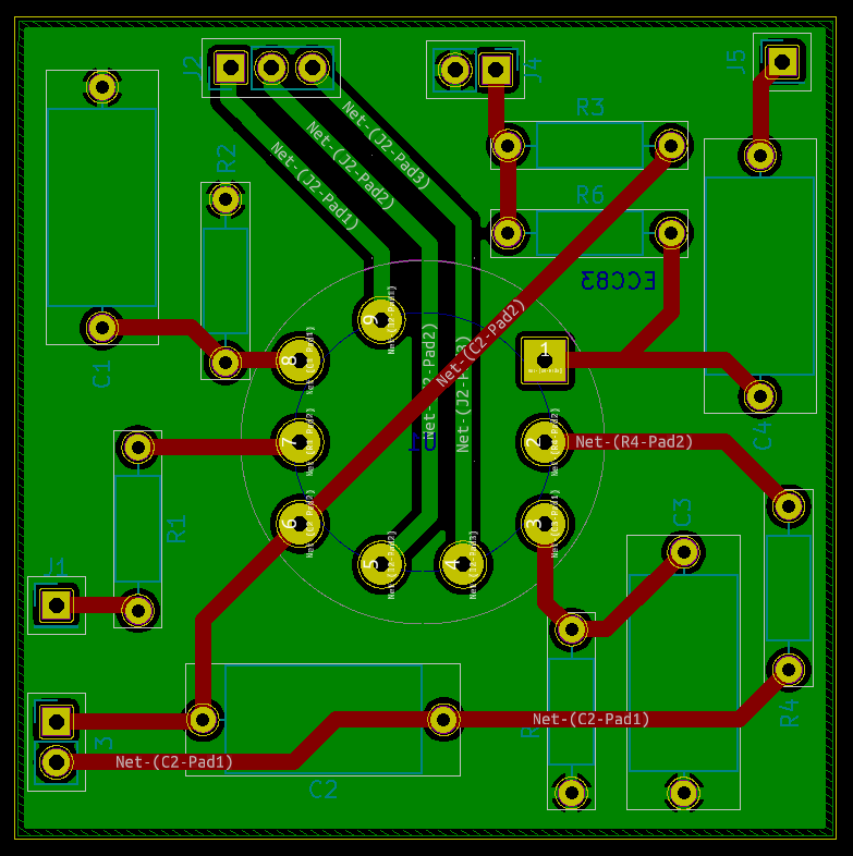

Its been a bit but I've still been stewing away at a few things. Due to another project of mine, I've found a decently reliable Chinese boardhouse that I'm happy with the end-result of. What that means is quick-turnaround, repeatable, decent quality PCBs.

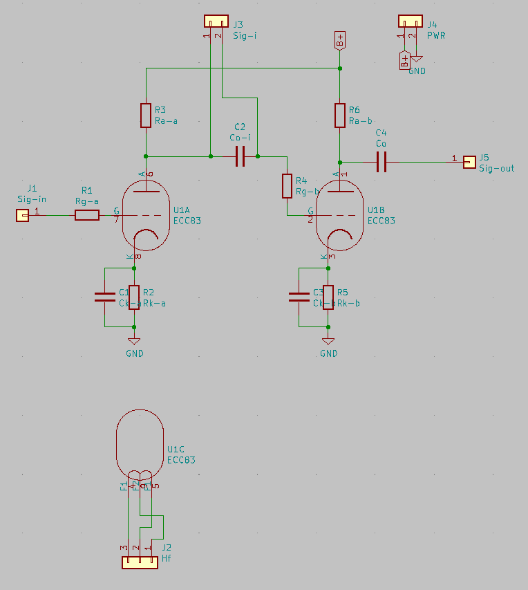

Input stage (scheme and PCB in attach)
  • standard noval socket (9-pin)
  • single tube, two triode stages
Few things on this:
  • cathode bypass caps optional
  • can include C1, but could use the-through hole for a "fat" switch wiring on V1A's (U1 on scheme) Rk, like what's in the "blues jr".
  • C2 can be omitted and signal at J3 connected to a Tonestack, or volume pot, or any circuit of choice
  • additionally could omit Rk&Ck and wire into a constant voltage supply of your choosing/design to provide a fixed bias.
I know pt.2 and p.4 aren't ever really used (or practical) in a hifi application but just wanted to demonstrate that since these are through-hole you have pickup points that allow for a wide array of scenarios.

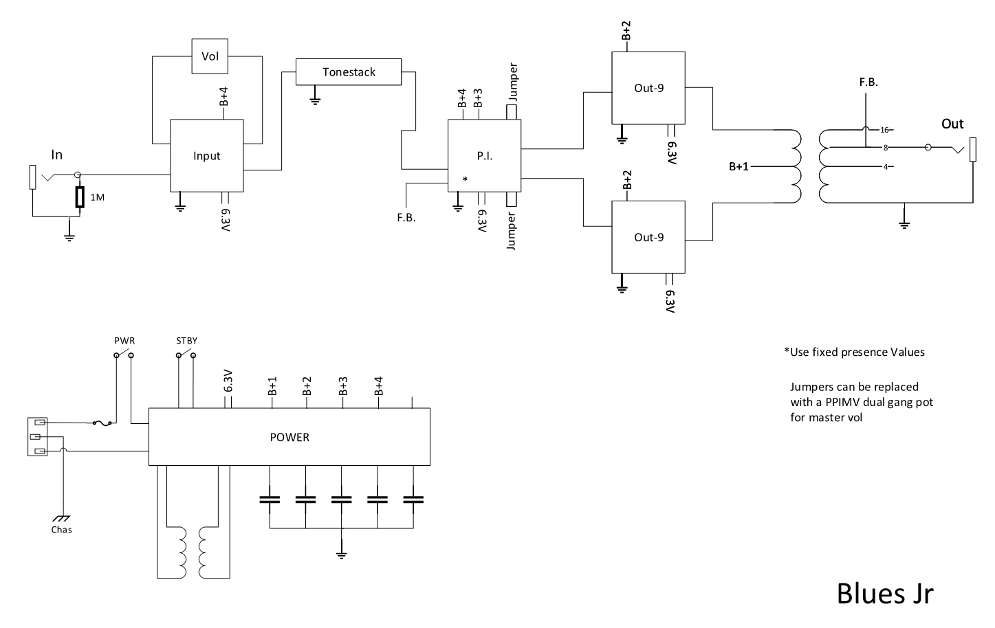

The idea is that then this "input block" would be coupled with a phase-inverter, volume, tonestack, and power supply boards, those boards would be wired together at their termination points and you'd essentially have an amp. An example of what a guitar amp would look like in terms of the "connection blocks" is also included.

How were you planning to implement the needed grid leak resistors?
My mind had been on oscillations recently so the grid stoppers were front & center but you're right, I need to add in the grid leaks as well. thanks for the reminder 😛
I've been tinkering around with the general premise and scribbling on paper so this was a first draft revision of the concept. I wanted to make sure i had the essentials without them being bloated. That said, as you pointed out, this (the leak resistors) is something that very much needs to be included.
