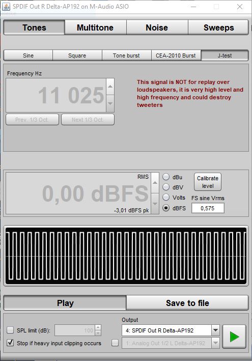

I meant more from the stand point of correctly setting up REW with J-TEST in the signal generator and the RTA settings such as Hann window.
I just want to know more of the details for correctly setting with REW the first time instead of making a silly mistake.
Can you explain in detail how to perform such jitter measurements?
It is actually very easy. You have the JTest signal in REW. You may have to check from Windows sound settings whether you are using 16-bit or 24-bit.
I don't know if there is an "official" way to perform JTest (meaning window or averaging parameters).

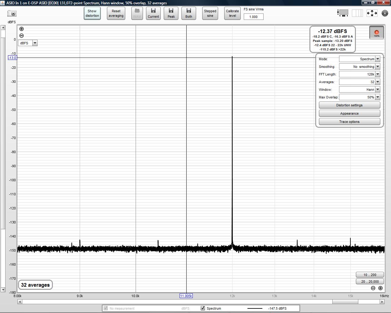

So I used (24-bit) Creative Professional/E-MU 1820 ASIO drivers with REW on Windows Vista and obtained the attached spectrum while measuring my ES9038Q2M board.
Does this look right? Should I conclude that the jitter is very good?
When You do 'jitter testing', You should push for highest frequency resolution (and you did it ~right, do not have 'skirts' down around the carrier).
Do the largest FFT that you can afford; do the highest signal level that you are capable of (close to 0dB FS on the dac, which is still not clipping, not dirty)
That way one can go down to - 170dB noise floor.. But it's not a must. ~160 is the general value. You will see better the spurie getting out the floor.
And it is possible to open the zoom out fully, 0Hz-24 kHz in your case. Everything included is still anharmonic dustortion (the first harmonic would be at 24kHz..)
