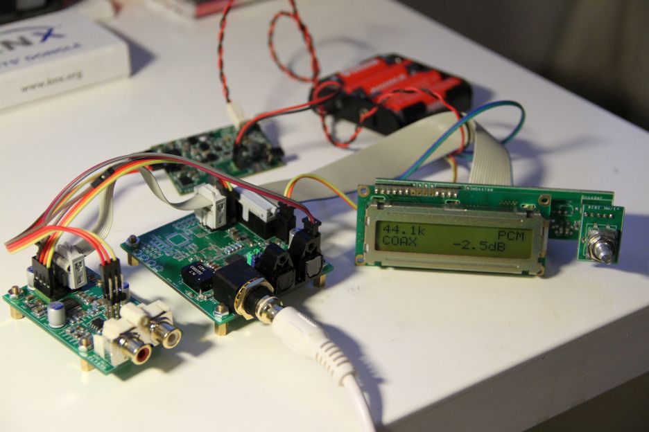

This is my modular AK4490 DAC that I made last year.
attachment.php
I started the design a few years back when I needed an optical SPDIF input for my TDA1541 DAC with tube buffer. Instead of buying something from China I decided to make my own. After all this is do-it-yourself audio, not buy-yourself-chinese-stuff audio.
First I made an integrated SPDIF board with AK4118 and STM32F030. Then I decided to add an AK4490 DAC. Then later AK4137 SRC. Soon I found a need to have a separate STM32F030 control board for other projects so I decided to make this more modular.
Now it contains 5 separate boards:
1. AK4118 receiver with optional AK4137. The board has coax and optical inputs as well as 1 optical output for SPDIF bridging. The board can output I2S via AK4137 or directly from AK4118 so the SRC can be truly bypassed. There is also an additional I2S input to AK4137 for an external USB-to-I2S board.
BTW fittingly the coax spdif input is based on Jocko's design (or rather advice to a fellow member) from 2005.

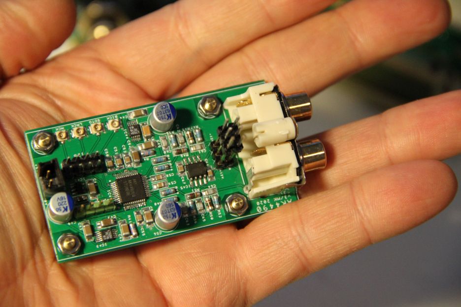

2. AK4490 board which is more or less according to datasheet with LM4562 as LPF Opamp. LT3042 regulators for VREFL/VREFR.

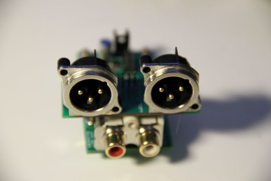

3. XLR "shield" for balanced output (2 LM4562 opamps).
4. STM32F030 control board with headers for HD44780, encoder, I2C, IR receiver and I/O.
5. Encoder board that has HW debouncers for encoder and switch. No SW debouncing needed.
The DAC can be powered by e.g. a SilentSwitcher with a battery pack (as seen in picture above).

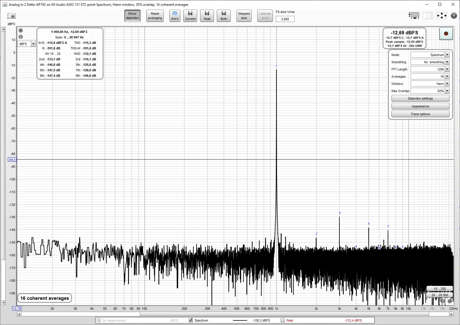

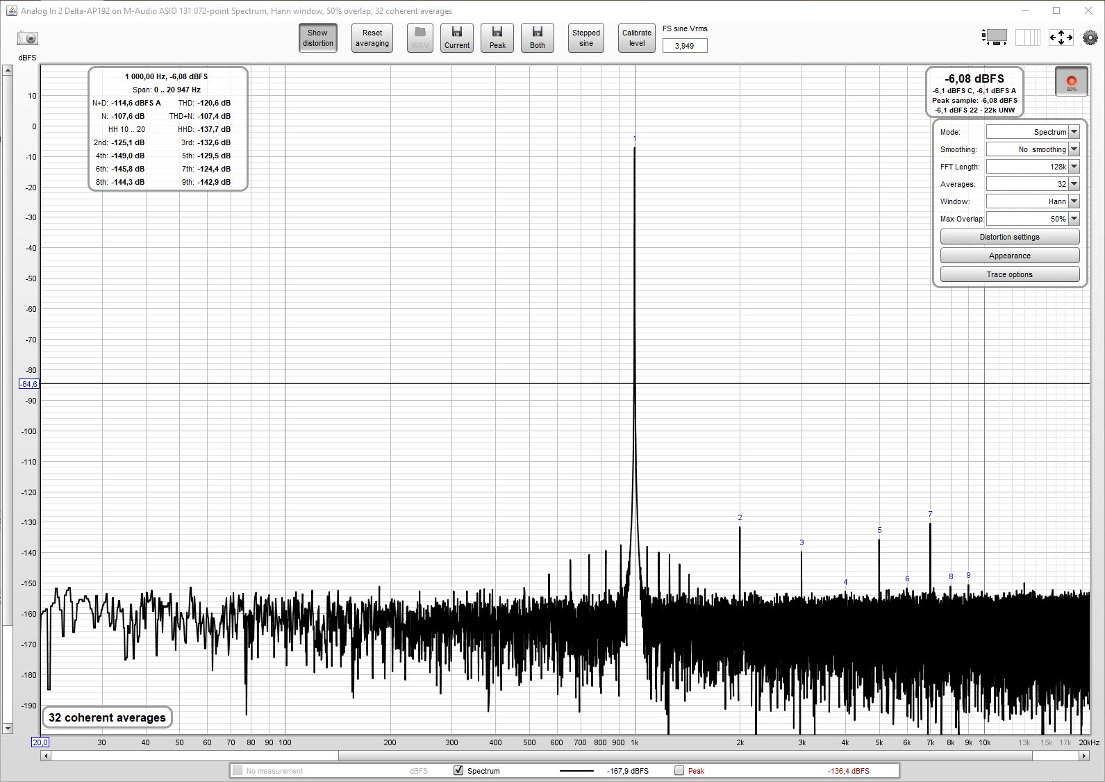

The performance is close to datasheet level. THD is very close to the measurement limit of my setup. Here is the FFT spectrum for 44.1kHz/24bit SPDIF input.
attachment.php
Here are pictures of the DAC board and the XLR "shield".
attachment.php
attachment.php

I noticed that I had mistakenly used too low VHREF voltages on the AK4490 board so the output was a tad low. Here is a new FFT spectrum with 2Vrms output. Now the THD+N is within datasheet limits.
attachment.php
AFAIK the artifacts around 1k are due to AK4118. Similar can be seen in jitter diagrams (as in Topping D70).
There seems to be lot of confusion about AK4118 even on ASR forum. Contrary to what some are stating AK4118 does not use the crystal or clock for reclocking the input. The crystal is only used for detecting the input sampling rate or for spdif output. Actually no crystal is required since AK4118 uses the PLL to retrieve the master clock. The measurements I have shown have been made with boards that have no clocks.
So even though AK4118 is claimed to be a low jitter spdif receiver there are better ones available (that actually do reclocking). E.g. ES9068AS as in Gustard x16 (see here). However even in AK4118 the jitter should be below audible levels.

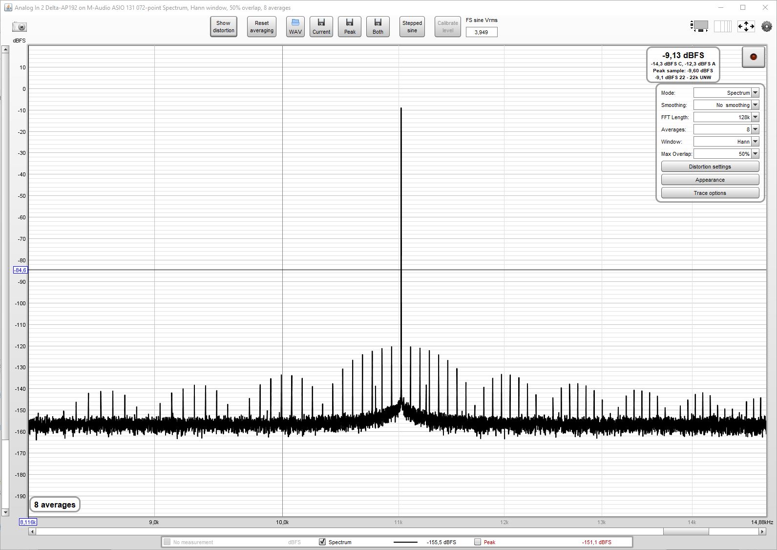

To wrap-up my monologue here are some jitter measurements.
1. SPDIF (Coax) - AK4118 - AK4490
attachment.php
There are strange artifacts about 85Hz apart. These are the same artifacts as shown in previous post. I assume these are somehow related to AK4118 PLL.

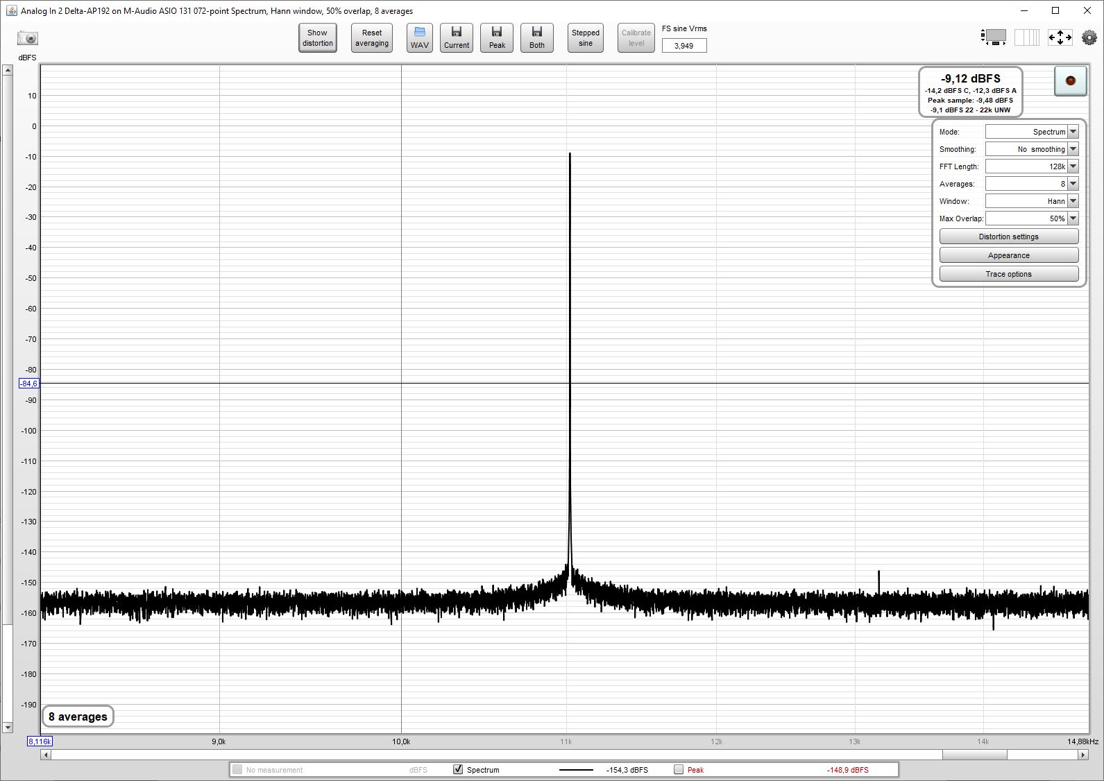

Now let's add AK4137 into the stream.
2. SPDIF (Coax) - AK4118 - AK4137 - AK4490
attachment.php
This looks much better. The reclocking done by AK4137 seems to remove most artifacts. So SPDIF jitter is not that bad after all 😀
BTW the on board master clock that AK4137 uses is NZ2520SDA (24.576MHz). The clock enthusiasts probably regard it as "mediocre at best". But for us mere mortals with wax filled instead of golden ears it will do.
