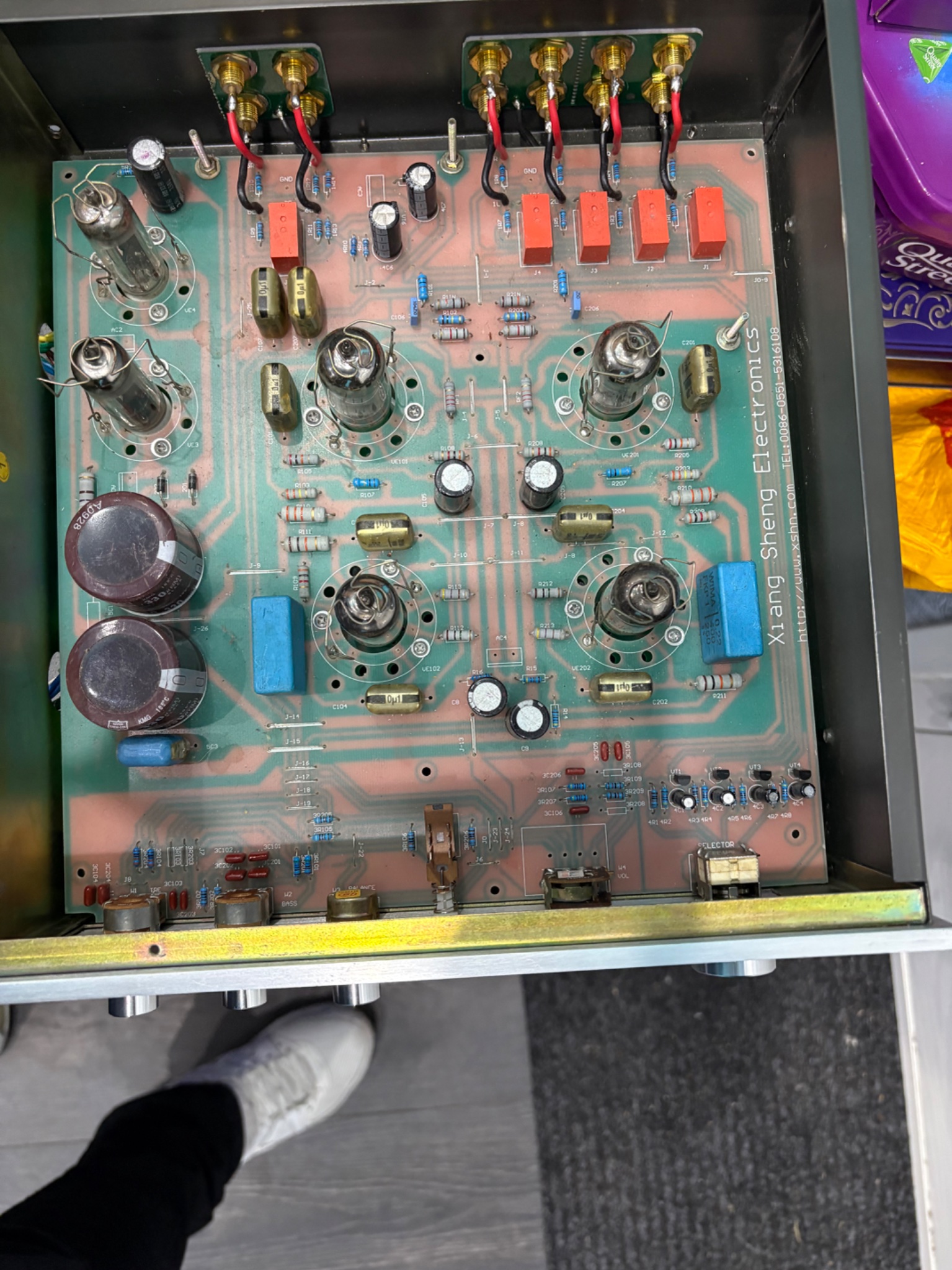

Hi! I bought this preamp and in loud volumes I can hear what sounds like a 60Hz hum through my speakers, which are fairly sensitive. Without the preamp in my system, I can hear no hum whatsoever.
What possible investigations and modifications would be advisable to address that 60Hz hum? Thanks in advance!

If it is 60Hz as opposed to 120Hz, then you have mains interference from somewhere, could be an Earth Loop?
Check for absence of hum with no inputs and if need be apply short circuits across the selected inputs. Preamp should be dead quiet.
I conducted those tests, but the hum is still there. Just to clarify, I am sending the sound I recorded with my cell phone at 1 cm of the woofer at full volume. I might be wrong, but sounds to me as 60 Hz, even if it is faint.
Am I expecting too much of this preamp? I don't hear anything like it from my solid state receiver or from the class D amp that I am pairing this preamp with. Thanks in advance.

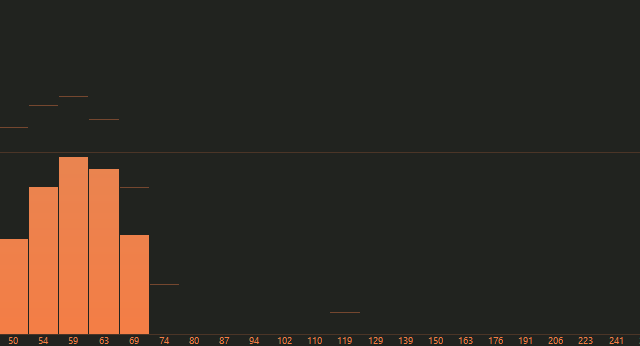

I used the visualizations in foobar2000 to get the attached screenshots. It looks like the bulk of it is centered on 60Hz, but there are also upper harmonics that show in the spectrogram.
The pictures don't show, but the 60 Hz peak is about -45 dB in this recording, while the 120 Hz is showing with approximately -60 dB peaks. The recording was made at 1 cm distance from the woofer.

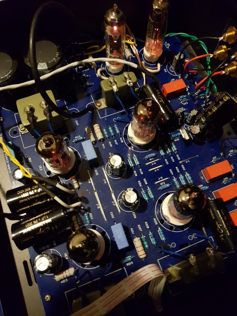

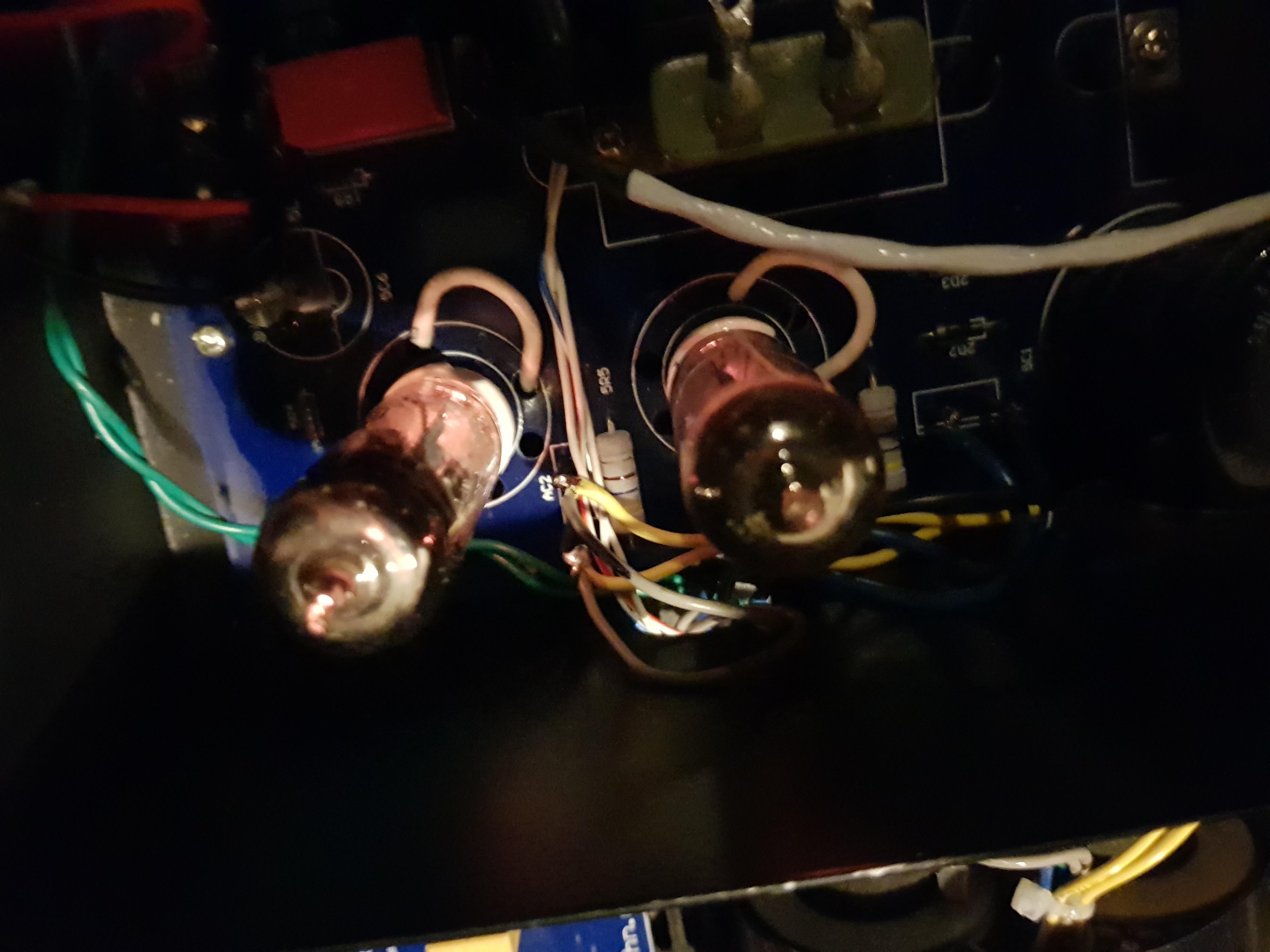

Some pics I have just taken while music is playing 🙂
All wiring is clear from tubes. I admit I was getting hurried on Sunday night, will tidy up nicely later when I feel like it. Still more to do including output & input wires.
I noticed 2 different values of resistor for the plate of the the 12au7 output in published schematics. Mine had 2.4K but 10K sounded much better. Need to be careful to use a higher power rated resistor. I used 2 watt carbons.
