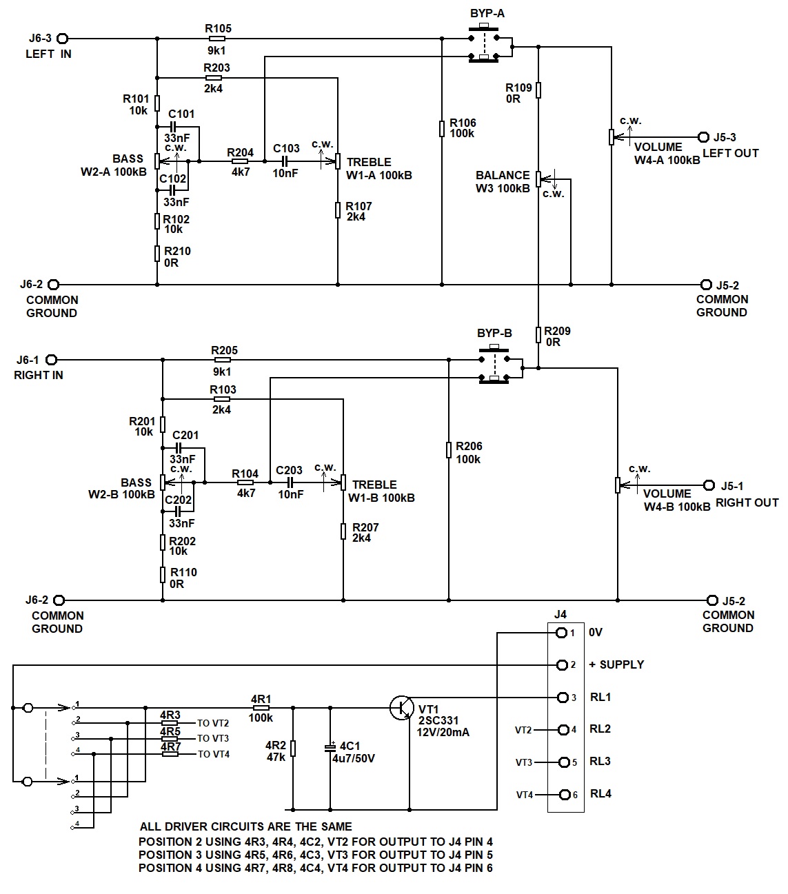

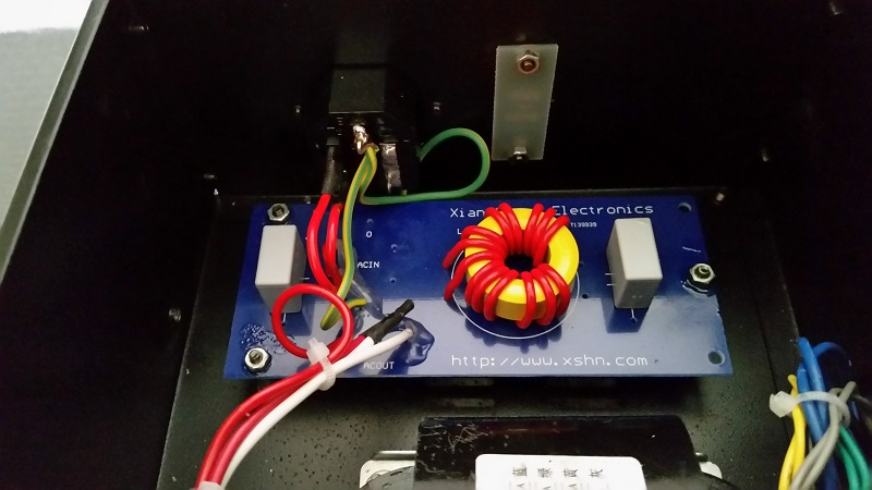

728A in for service

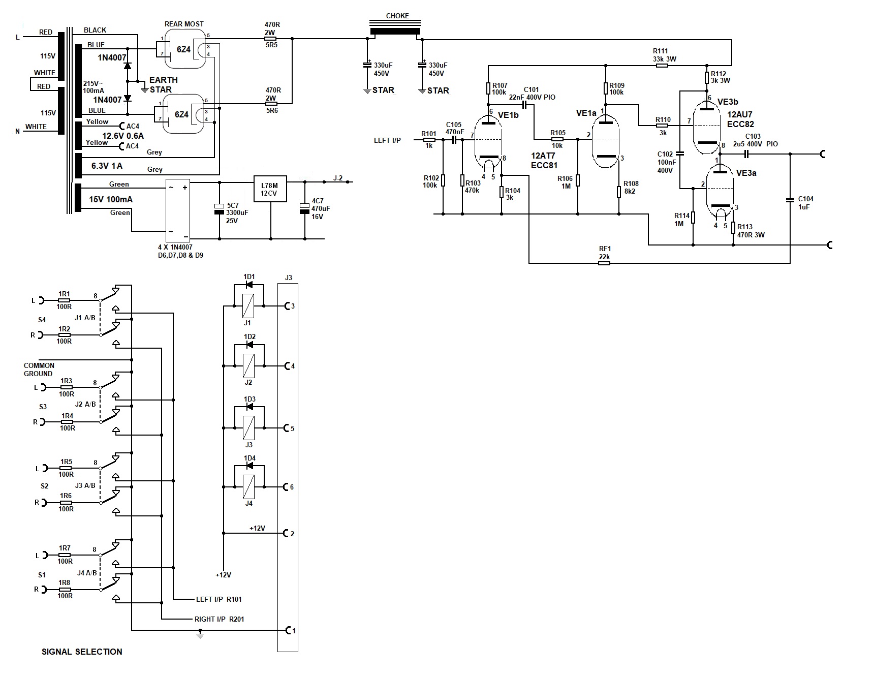

Just started this one and looks like a long haul if I am going to reverse engineer it. Circuits around the internet do not match what I have on the bench, this one uses two Chinese 6Z4 dual rectifiers, each strapped together and both forming part of a Bridge rectifier. The other half of the Bridge is provided by 1N4007 diodes. The main problem I suspect with this particular amplifier is faulty Triode tubes, the owner fitted Mullard NOS tubes which all but one tested as not serviceable. I am uncomfortable with the rectifier circuit where it seems the 8uF maximum reservoir capacitor is exceeded by over 300uF with just a 470 Ohm 2W resistor to limit in-rush current from the poor rectifier tubes. For parts of the world where a good safety supply Ground wire to the metal case is important, there is a naughty bit of construction here. The Earth pin from the power input connector is routed to a filter board and then to the case via compression provided by the boards fixing nuts. I have already placed an additional Ground wire direct from the power input connector to a dedicated Earth Bolt on the underside of the metal case. Naughty one Xiang Sheng!
One of the filter caps had blown as shown by guts emerging from a swollen case so these have been replaced by two quality X2 capacitors.
I think I have managed to reverse engineer the Tone control network. the balance control, volume control and the signal selector switching.
It looks a most daunting task to try to unravel the main circuit board, almost to the point that even after several Rum Toddies I have not yet gained the enthusiasm to do it. Does anyone know if the strange metal box capacitors are any good? They look like NOS oil filled components from WW2.
Did a bit more today, probably full of errors but if you have this unit and want to help, just to check the work, it would be appreciated by the many I am sure.
I want to run over the output part again and then try to work out what the two transistors and relay J5 do. Does this thing have a delay? Does it have a dual colour LED on front panel? A yes to both would get me going down a possible circuit route. 🙂

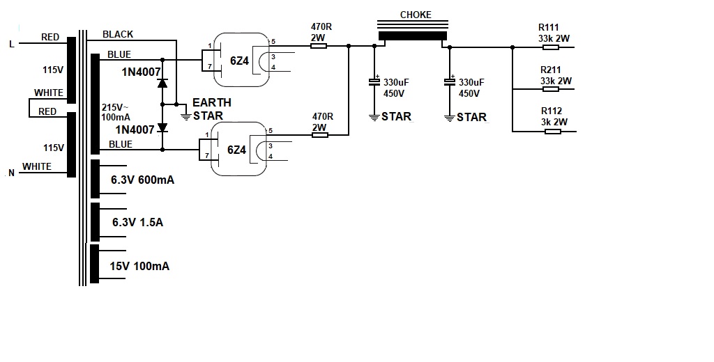

Interesting what you discover when you unravel the circuit. The earlier sketch is wrong in the output, the feedback resistor is actually sourced from the junction of C103 and C104, C104 is the output coupling capacitor. This means the signal going out has to go through two coupling capacitors. the oil filled one (C103) and then a square Poly one (C104). Maybe they don't trust the NOS oil filled 🙂
The HT line also has an odd 22uF/400V (5C5) on it as well as a 100nF 400V (5C3)., presumably to reduce HF Noise?
Also discovered the unit has a heater lift circuit using 5R1, 5R2, 5C4 and a HT Bleeder 330k (5R8). These I shall add to the provisional circuit diagram.

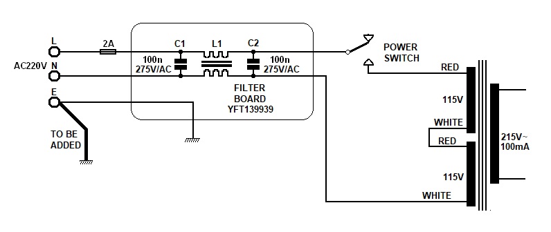

Just finished my investigations of this preamplifier.
http://www.g4cnh.com/public/A_Look_At_The_Xiang_Sheng_728A.pdf
