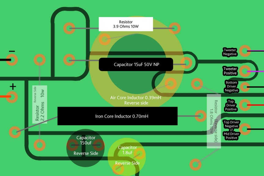

I am trying to replace the capacitors and resistors with Audio grade components
Hi Ranjith

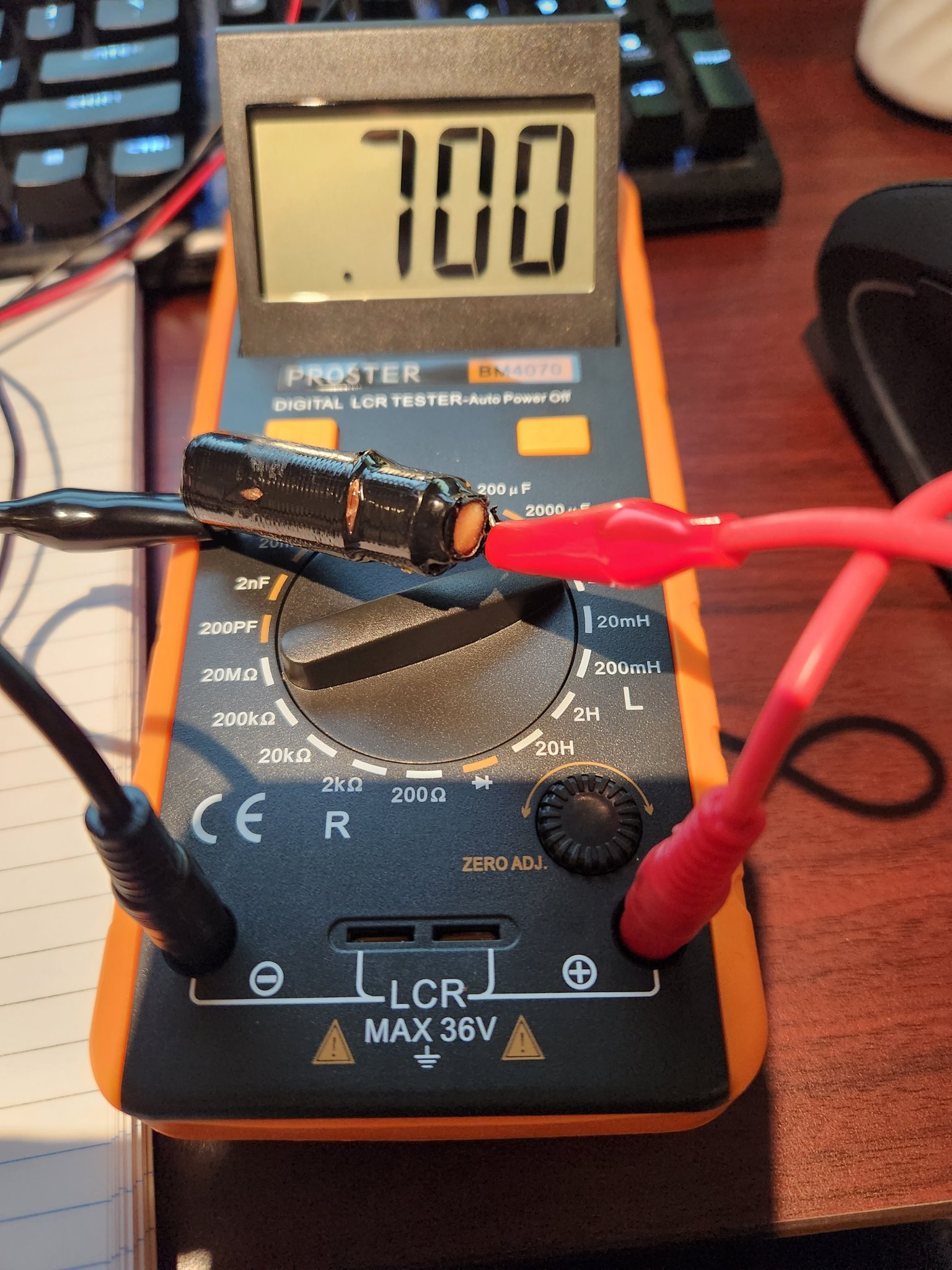

I was able to measure the solid core inductor. My meter is showing 0.7mH. I am currently trying to draw a schematic of this crossover. When I get it done, I will share here.

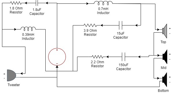

If I did this correctly, here is the diagram for the SP-FS52 crossover design. I measured the 0.7mH inductor but was unable to properly measure the inductor for the tweeter. I assume the value is correct as Ranjith stated in a previous post.
Not sure if I got this right, hopefully someone here can confirm the diagram below is accurate.
