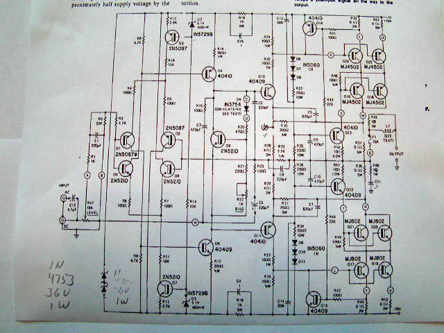

This is great, Thanks.burnedfingers said:schematic of Tigersaurious
By curiousity is going now. When was this amp made, any idea how many?
It's hard not to notice the series (cascoded) output stage. Probably for the same reason Mr B used it. A completely opposite approach to the Ampzilla.
What is the output power, the supply voltages (the image on my monitor isn't quite clear enough). Is there any kind of technical description? Anything like the Audio Amatuer or Audio articles on the Ampzilla?
If your interested in more details on the Ampzilla I have a pretty good collection.
Could I trouble you to take a picture of just the upper part of the voltage amp/ output stage? When you have time. Alot of the component values are difficult to read.

MikeBettinger,
I will email you some readable scans of the schematic plus pictures of the amplifiers.
I dug out my copy of the 121G schematic and it looks like the changes from the prior circuit were all in the DC Servo circuit.
My board has had these changes made to it. I believe death was caused by tantalum cap failure/fire/ = death to board.

Thanks, something new to dig into! Although I'm going to be tied for the better part of the weekend and won't get much of a chance to examine them. It will give me something to look forward to.
The 121G was the version where GAS actually got the AmpzillaII stable. They designated it the Ampzilla IIa Both the 121E and F were time bombs and didn't like looking into much more than a load resistor on the bench.
In my humble opinion the 121B and the 121G are sonically and stability wise the best versions.
Do you have the schematic for the E or F? I should have one in my files if you want to compare them. Off hand I forget what all the changes were.
I would have to agree. I've probably done more with the 121B myself. Sonically they are sweet.

My main curiosity is the Tigersaurus and am quite happy to pass on anything I have on the Gas gear; I'm not looking for money, just something interesting to do.
As far as laying out an ampzilla PCB, I'd suggest building the 121G boards based on the schematic. The form factor is the same for all. I've toyed with the idea myself over the years, except Amp no longer makes the connectors.
