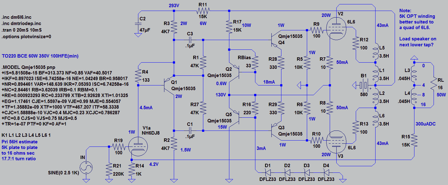

Agh! I tried to prove this in sim with a very slight overdrive. But the global
loop corrected both so much you couldn't tell any difference due to local
impedance mismatches.
Both errors are exaggerated in the drive signal by closed loop correction.
I just totally wasn't expecting both exaggerated errors to look so much
the same?!?!?. Disconnect the global loop to really see them misbehave
differently.
I disabled impedance equalization with a large bypass cap across R1.
Local impedance equalization may indeed by completely meaningless once
the big loop is closed? Maybe this simulated transformer is unrealistically
wideband to draw any hard conclusion that a global loop really fixes all.
Slightly into A2 with no blocking.
Just turn the LTP upside down...
Only 1 pole of caps left to kill?
If transistor voltage gain offends,
R28 R29 can certainly be reduced
to unity gain 10K. Works better if
you let LTP have some gain...
  • PWilSoup7.asc.txt

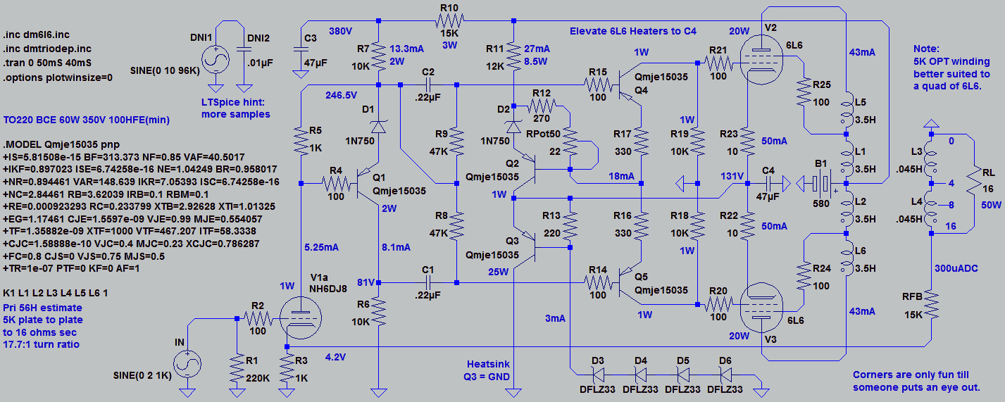

Further tweakage, slightly more A2...
Better sorted ref designators.
Hopefully you can still see Williamson in it?
All that PNP-age and VBE constant current
makes it a little unfamiliar at first glance.
Zeniers further stiffen VBE CCS and can buck
tempcos of well matched emitter junctions.
Don't place too much faith in my tempcos,
I'm just throwing random sand at random.
C2 and R9 aren't absolutely necessary, but
takes a lot longer simulation for DC balance.
If you replace those with a simple wire, you
could get the whole thing down to one cap.
And be at least halfway direct coupled.
Excepting the OPT in the loop of course...
Q3 the only sand that gets hot, also happens
to have a grounded collector (lucky accident).
Could bolt right to star ground lug or something.
T0220 heatsink tab is also the collector.
Fear not 580V, with fixed cathode bias at 130V.
6L6 are seeing only 450V UL. Heaters here will
need to be elevated to voltage at C4, probably
no harm elevate 6DJ8 along with...
  • PWilSoup8.asc.txt
If R17 were made to be adjustible? Or a pot inbetween R16+R17?
then slightly mismatched pentodes could be biased individually.
AC gains will still be equal across the LTP even if R16 differs from
R17, as CCS provides no leakage path for AC. Yet DC biases can
be purposely imbalanced here to correct a mismatch.
Constant current across Q2 VBE+Zenier becomes bias at R18,19.
Why I threw the Zenier at improving VBE regulation, so the bias
voltage that appears on 6L6 G1's would not drift...
