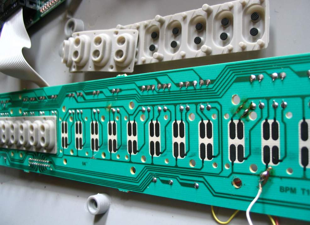

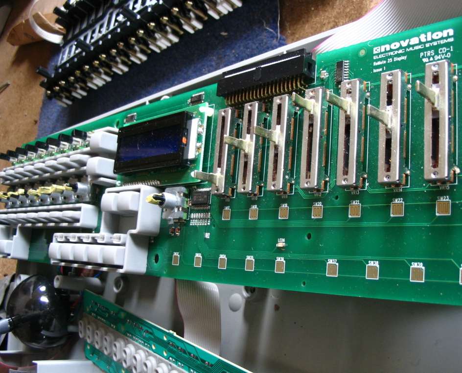

I just hacked up a "Novation remote 25" keyboard which has about 30 MIDI-cc potentiometers, 30 keys and an XY pad.

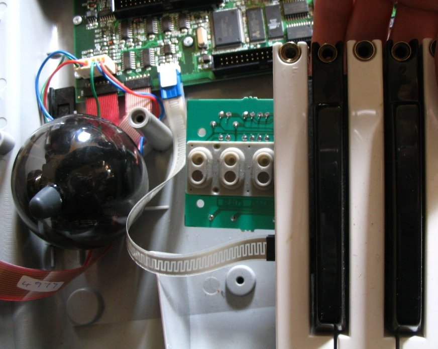

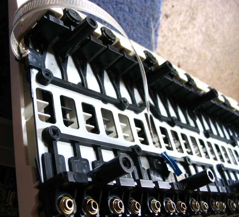

when I got inside the keyboard contacts, it turns out that each key is activated by four contacts on each key, that look like the number four on a dice🙂🙂, plus a bizarre long ribbon connector that runs the whole length of the keyboard under all the keys but that doesn't look like it can make electrical contact with anything very oddly.
to activate a key, I have to join the top and bottom pairs of contacts for that key. I have hacked into the circuit and extended it into copper wires (from a mouse cable) that are about one meter long.
when I try and join the notes one meter away it is tricky getting the contact and then when it does it often hangs on a gate on.
is it really tough to hack into velocity sensitive keyboards?

here are some pictures of the beautiful insides of a MIDI keyboard.
1-confounding velocity sensitive note pitch/gate contacts.
What could the ribbon connector be?

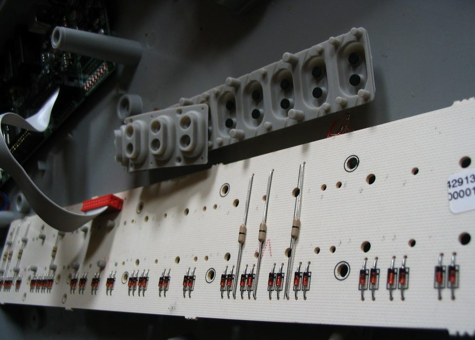

velocity sensitive double contacts, a line of rubber buttons with 2 contacts each is pressed by every key, each button has one contact higher than the other to sense velocity.
I can't seem to turn this into a basic note on/off system system even for only five keys.

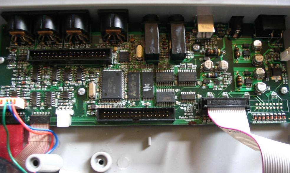

main novation controller for the remote series into which the different controller/key panels are plugged, with USB/power, MIDI, all the keyboard IO.
The pitchbend XY wheel and the cheapo XY pad that you think would be the strength of this board are at the left, still an excellent controller.

thanks for the encouragement, in any case, I figured out what the ribbon is going along the length of the keys, it is a resistor that measures channel aftertouch which is a mono MIDI message
I also found that there is no easy way of turning the contacts from any commercial MIDI controller with velocity sensitivity into basic note on off keys like to get on a DIY MIDI board, unless you are really a mad electronics buff it is literally a type of electronic shafting for anyone that triesbecause all the velocity sensitive contact go into a really fkkkkt bastard microcontroller

Basically to register a key press the switches close a few milliseconds apart, and the micro deciphers the time difference as the key velocity.

On the novation website, they have a templates configuration program for the keyboard where you can assign all of the buttons to different functions like toggle and gates and keyboard notes, so you can wire into the buttons and assign them to keyboards.ooops should have thought of that

the keyboard plays fine through its own electronics and I think all the potentiometers a polled about 50 times a second, and there's tons of multiplexing and scan matrix and processors that get overloaded hence they delay.
I managed to get a MIDI boutique readily extendable board that can handle 320 switches and 64 potentiometers so it should be pretty decent now I'm just waiting for some extra parts and finally I can do this thing.
