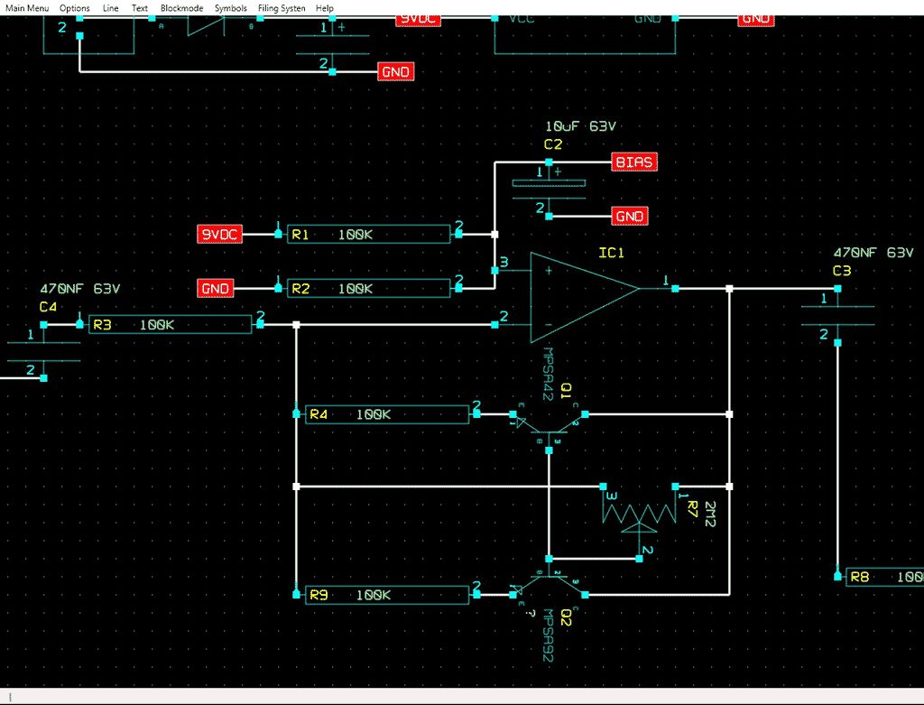

Hi guys,
I can't remember who it was, but I know someone on here has used (with success) transistors in the feedback loop of an op-amp.
Thanks in advance,
Chris
I use this in conjunction with a guitar to get valve type distortion. There is a sweet spot on the pot that sounds very good.
I use this in conjunction with a guitar to get valve type distortion. There is a sweet spot on the pot taht sounds very good.
That looks a bit similar in configuration to the one I posted, using PNP-NPN pair. Thanks for posting it.. now we have more circuits to cook up and play with. One thing that I have tried in the past with the Distortion plus circuit was to remove one of the clipping diodes from the circuit, which brings the sound more towards a subtle overdrive. I will try that as well with the transistor version. There is some tube/valve circuit theory going on behind that approach too.

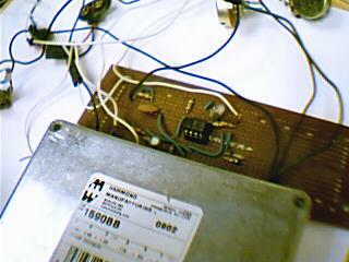

I finally dug up my MXR Distortion + board. I had scavenged a couple of parts off it for another build but just a couple of jacks needed and a case to put back together..once I clean up the wires Once it gets going and add the FB transistors I will post and maybe start a new thread on a pedal build ..if anyone interested in continuing.

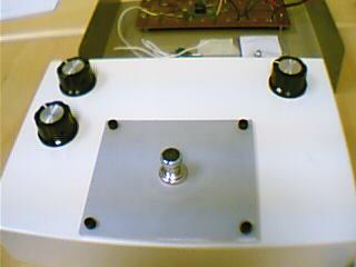

yeah im quite interested in that, hehe yours looks a bir tidier than mine, mines just a breadboard in a aluminium box and it looks like ive just thrown some stuff in there... though it works quite nicely!
At least your circuit made it's way into a box! I was going to load it into a Hammond stompbox case but have decided on bigger one to leave room to modify etc.
Hi Nigel, thanks for posting that. I thought it was you that had mentioned it previously, but wasn't sure.
I'm currently running Ch1 with only one LED installed. When used in conjunction with pedal-based distortion, it sounds rather good, though the 4x8" cabinet I'm using is too bright and extended in the treble. I've left a chocky block in there (soldered wires to the board), so it's easy enough to experiment now. I'll give your circuit a try and report back.

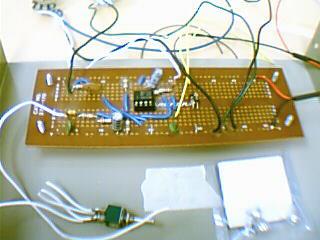

hard/soft clip build
Cleaned up wiring on the Distortion + board and mounted in chassis. The chassis is bigger, as I want to be able to experiment a bit with various setups for hard/soft clip. I removed the 1N270 diodes from the op-amp output circuit, and will wire up a selector switch to be able to switch from them (at the output) to the transistors in the FB circuit. Aiming to add a Tone control after, as the original Dist + did not have one.
