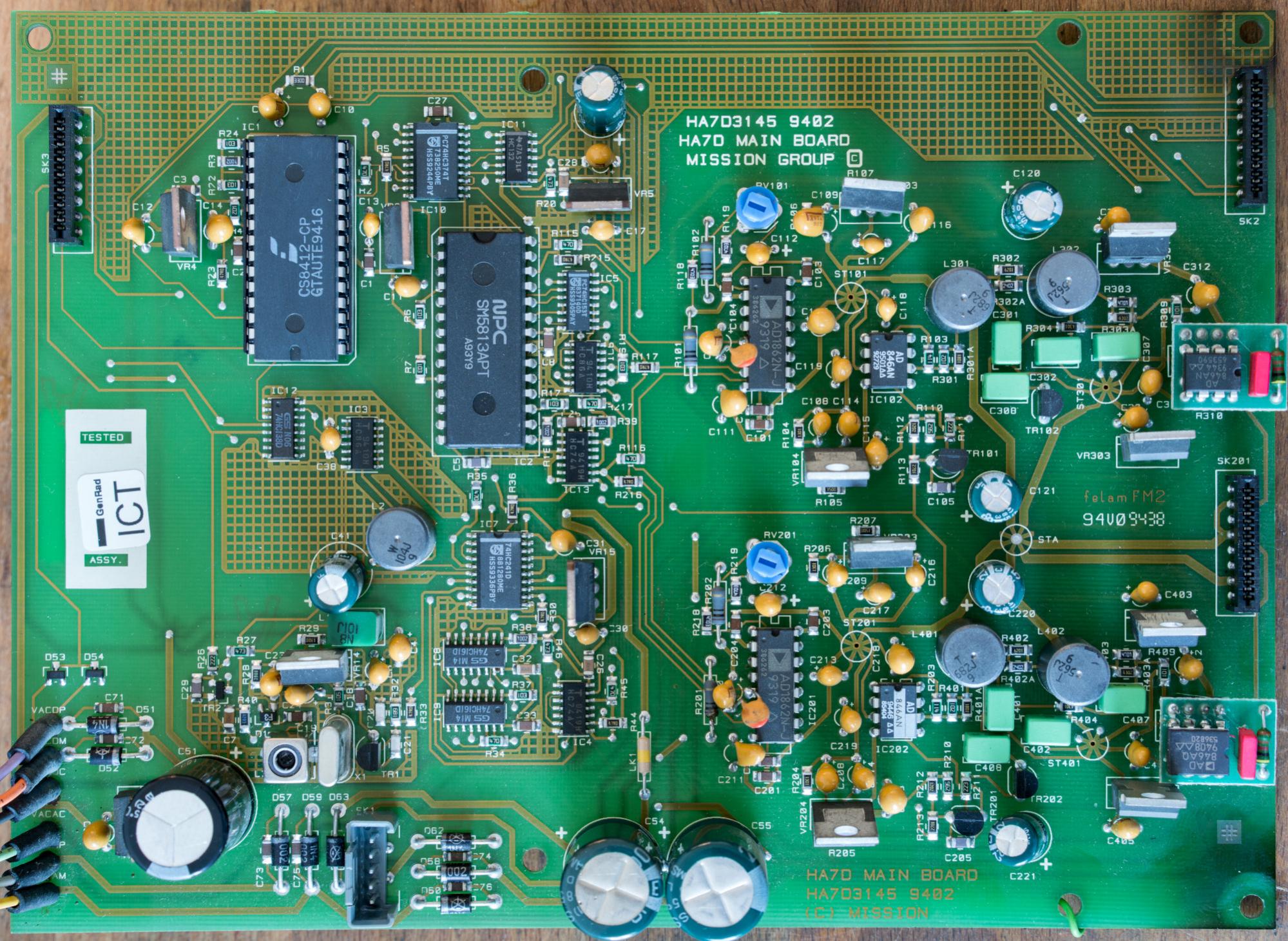

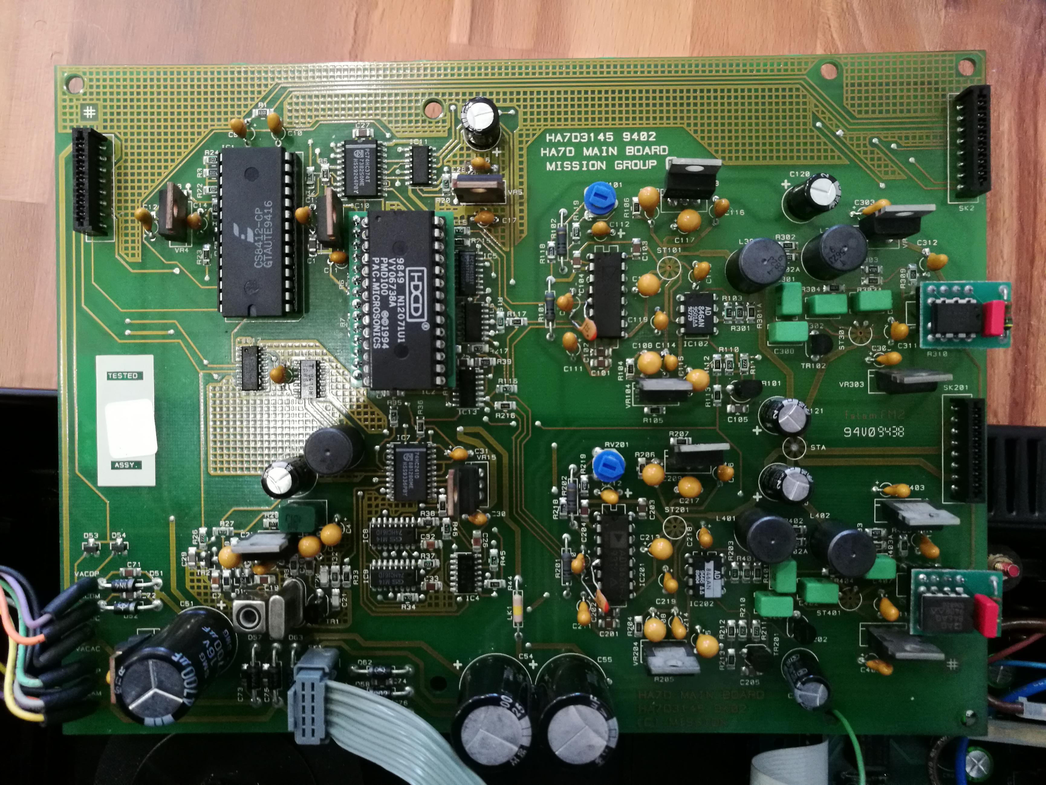

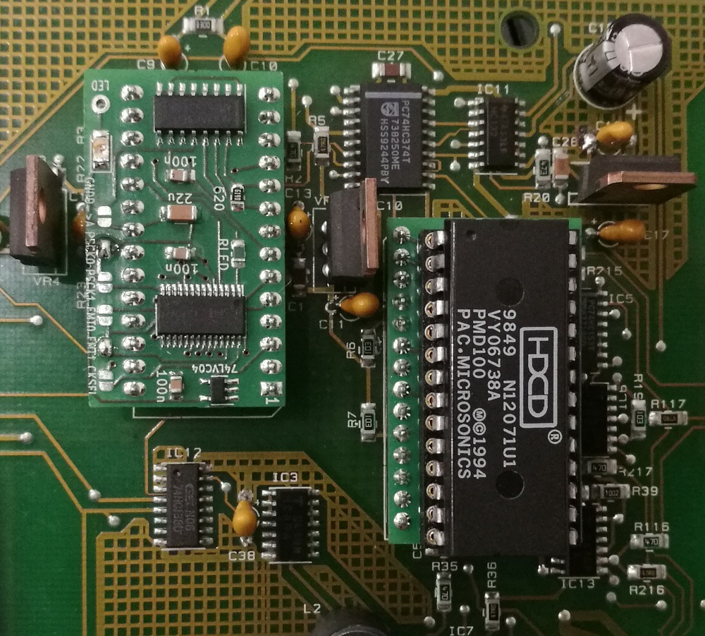

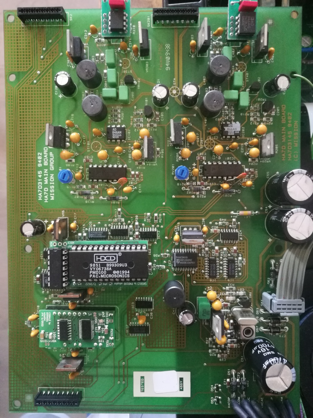

I found a defective and cheap Dacmaster online, bought it and repaired it, recapped it and upgraded the digital filter to a PMD100. This was the main PCB before recap:

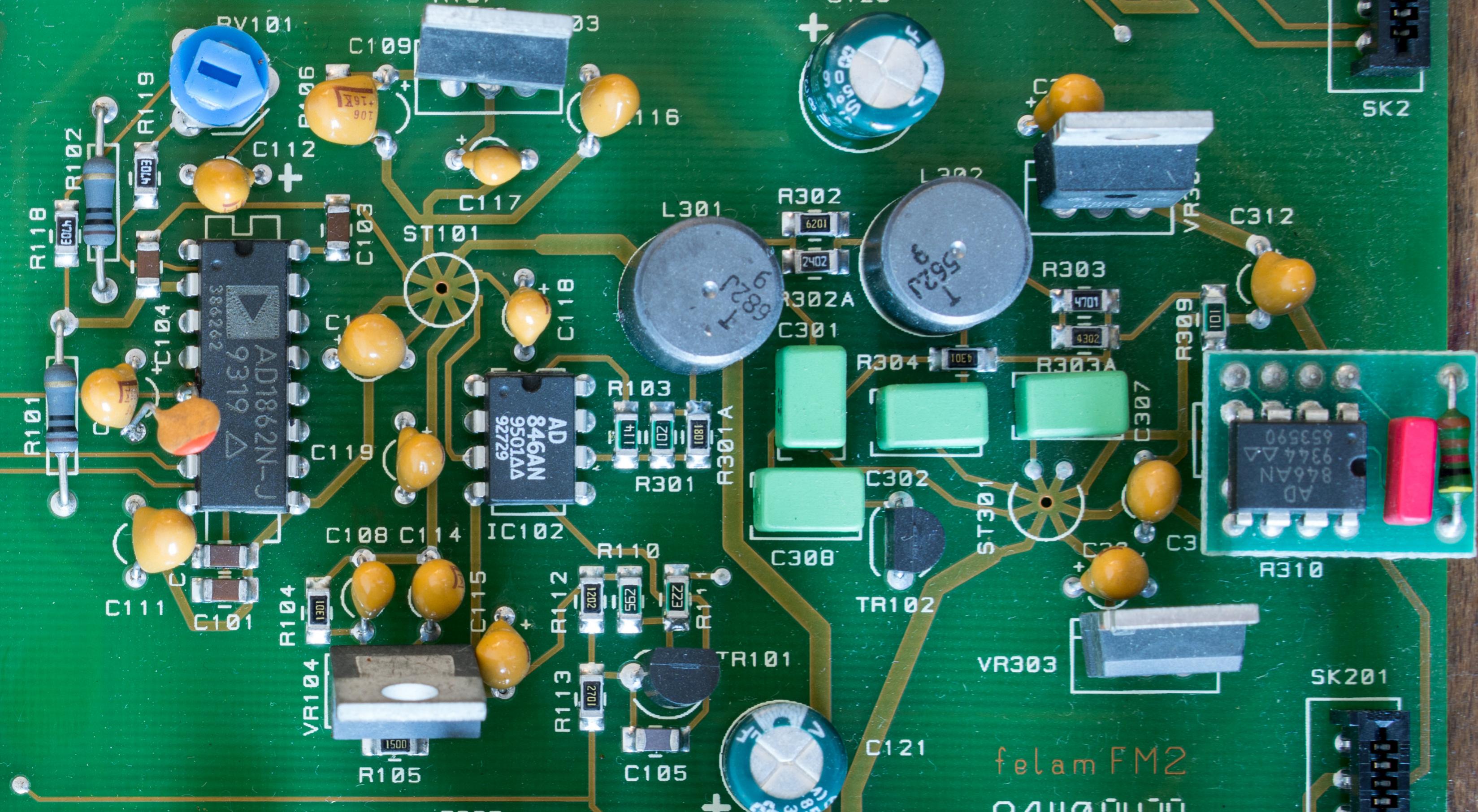

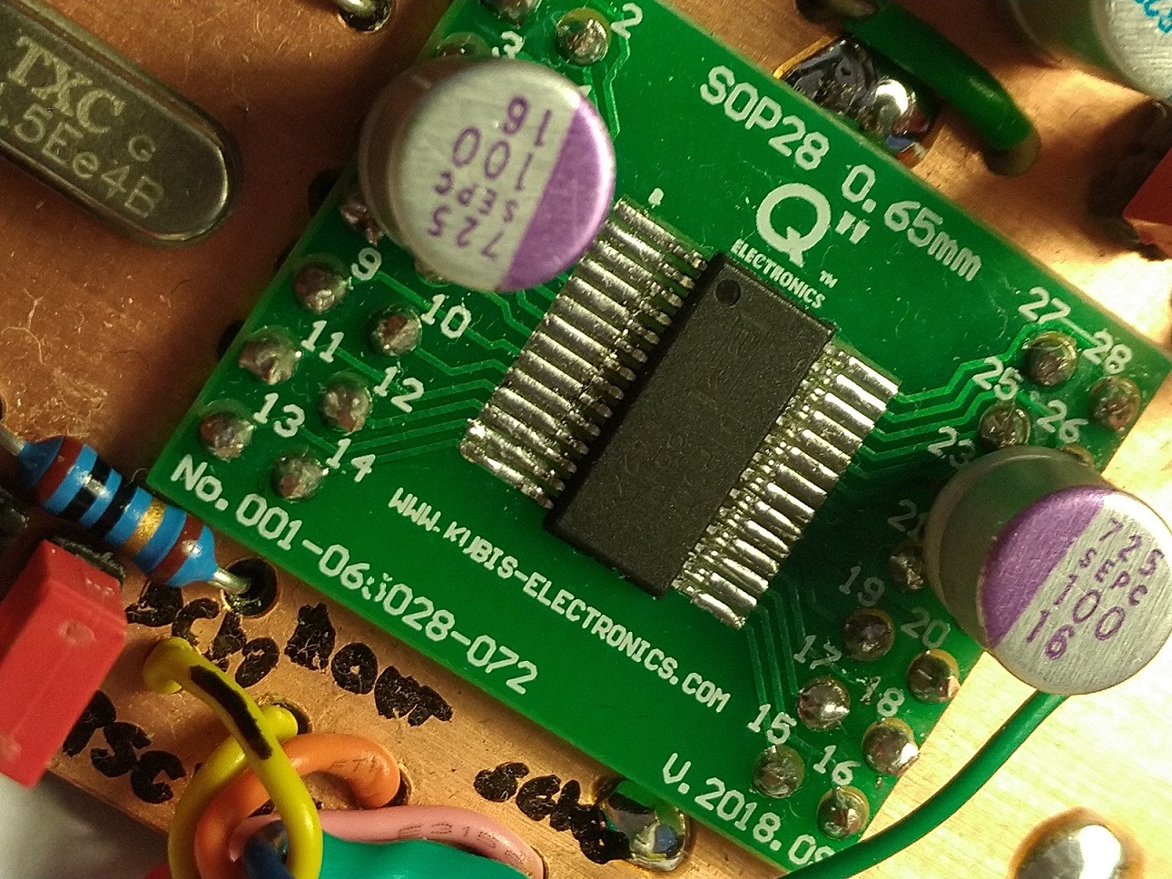

The Dacmaster sounds wonderful now and is really a good and nice and small devic. It has a nice analog section with very good AD1862 DAC chips:

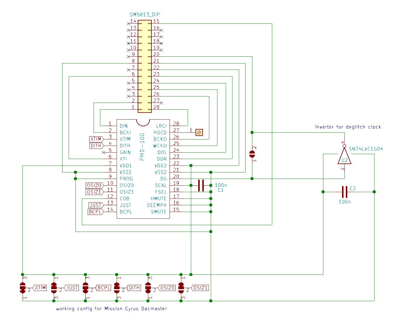

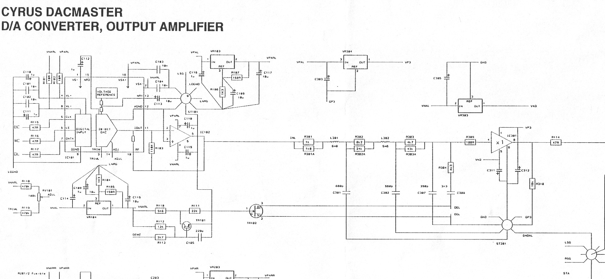

If somebody has a complete schematic I would be very glad to see it. I found only this part online:

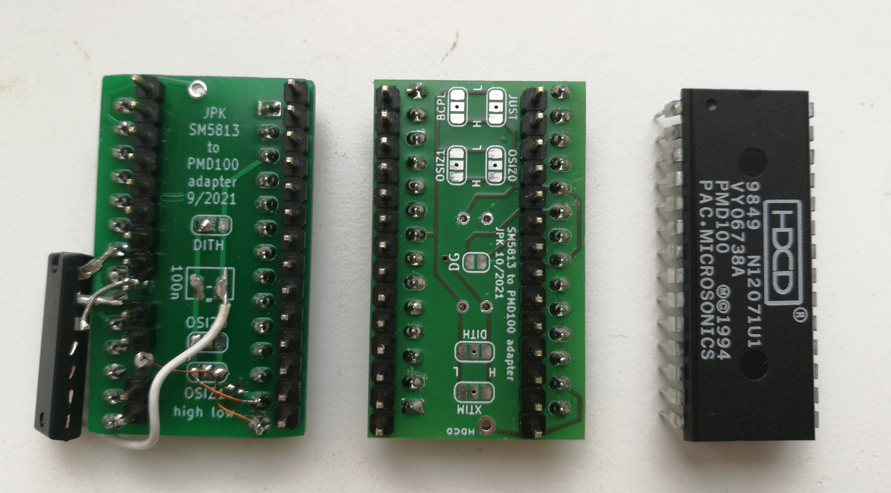

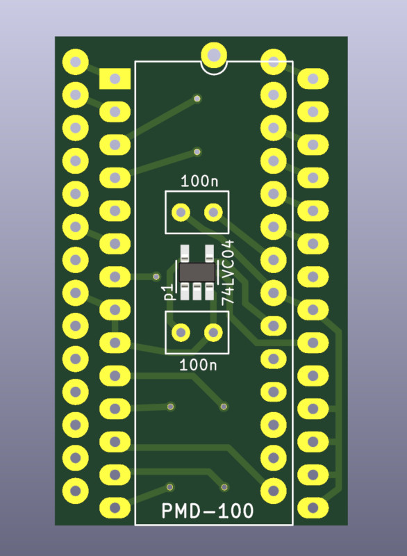

The adapter PCB has solder jumpers to configure the settings of the PMD and uses an inverter for the deglitch signal:
The first version of the PCB did not have the inverter on it, I soldered an old 7404 from my parts bin to the legs of the PMD (left PCB on this picture):

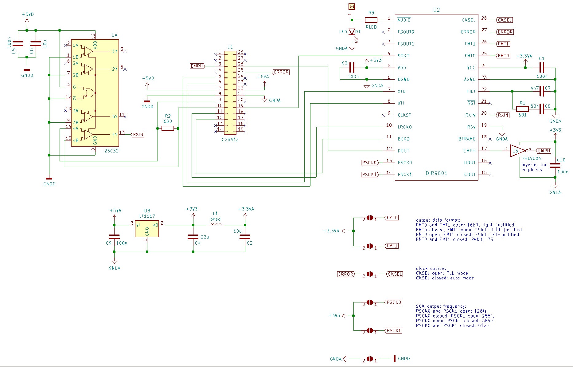

If anybody is interested I can give away the first version of the adapter PCB, and also I have 2 unpopulated PCBs of the final version (contact me via PM and I will send for free, I ask only for shipping cost). Here is the schematic of the adapter PCB:
This is the board after recap and with the PMD100 fitted:

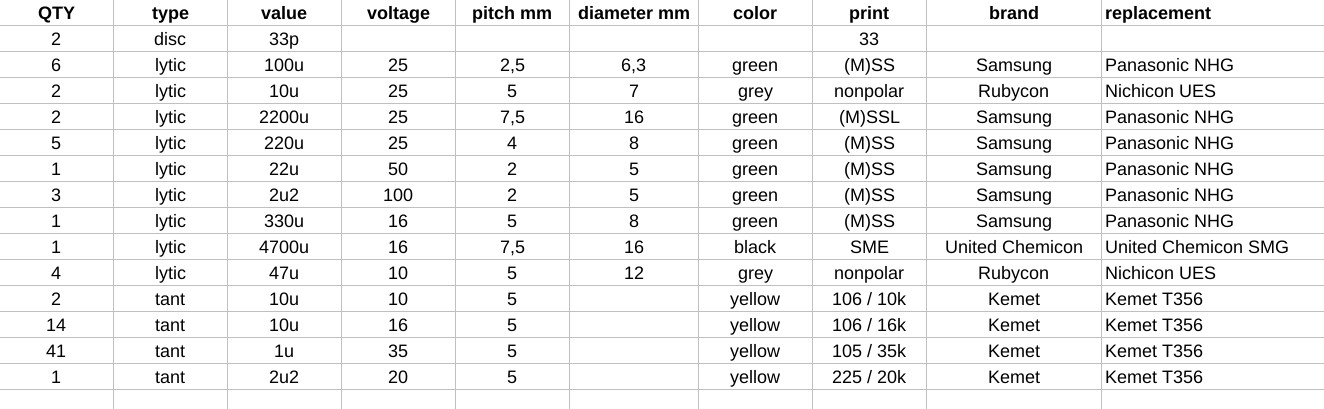

And this is my recap BOM for all 3 PCBs of the Dacmaster:
The sound improved a lot with the recap, and improved another leap with the PMD100: it sounds more fluid, more 3-dimensional, smoother, and also more emotional...

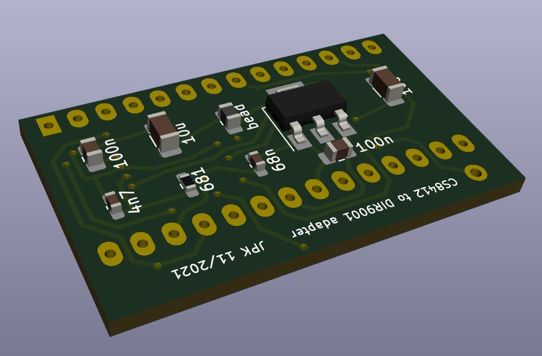

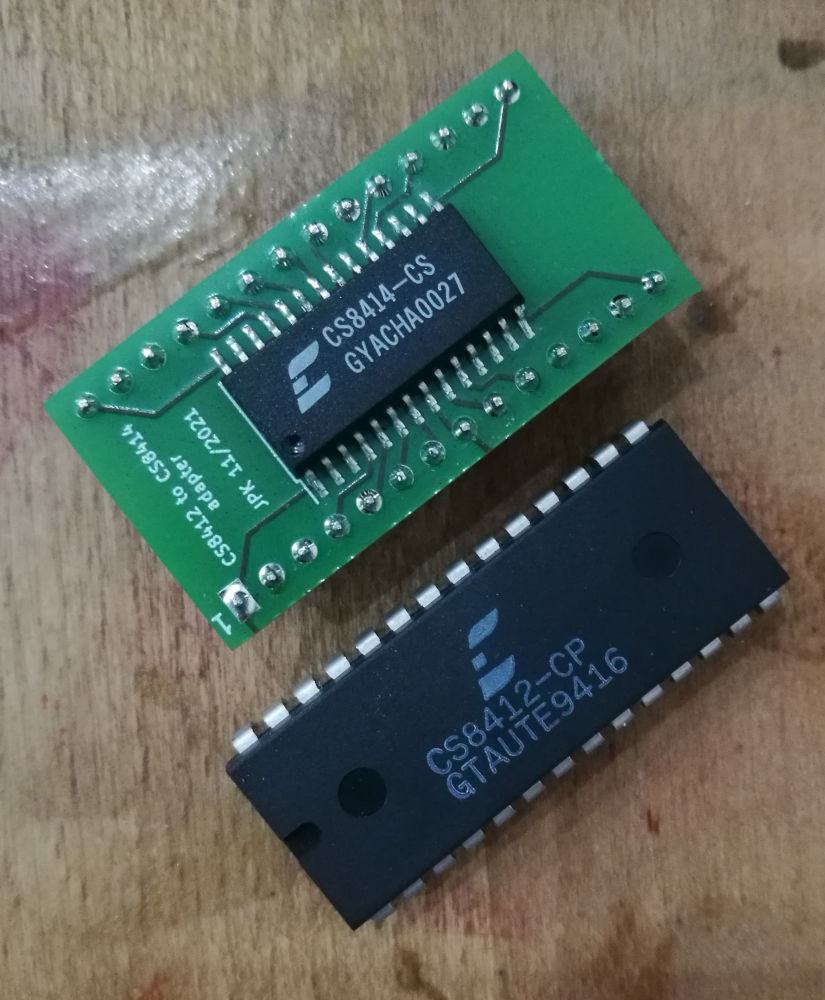

I made 2 adapter PCBs for the digital receiver: one for the CS8414 and one for the DIR9001 (based on the circuit shown here). The CS8414 adapter PCB has the loop filter components on the underside. The DIR9001 sounds much better than both the CS8412 and the CS8414. Maybe that's because of the extra regulator for the receiver chip...? I configured the jumpers on the DIR9001 and the PMD100 boards to 24bit left justified transfer between the two boards. Here are pictures:
DIR9001 is simply better, the data says it all. I also replaced CS8414 with DIR9001 in my DAC, I left the regulators the same with two ADP7118 and I also use PMD100 as a dig filter. The sound is better and there is no doubt that DIR9001 is better than CS8414 (6).

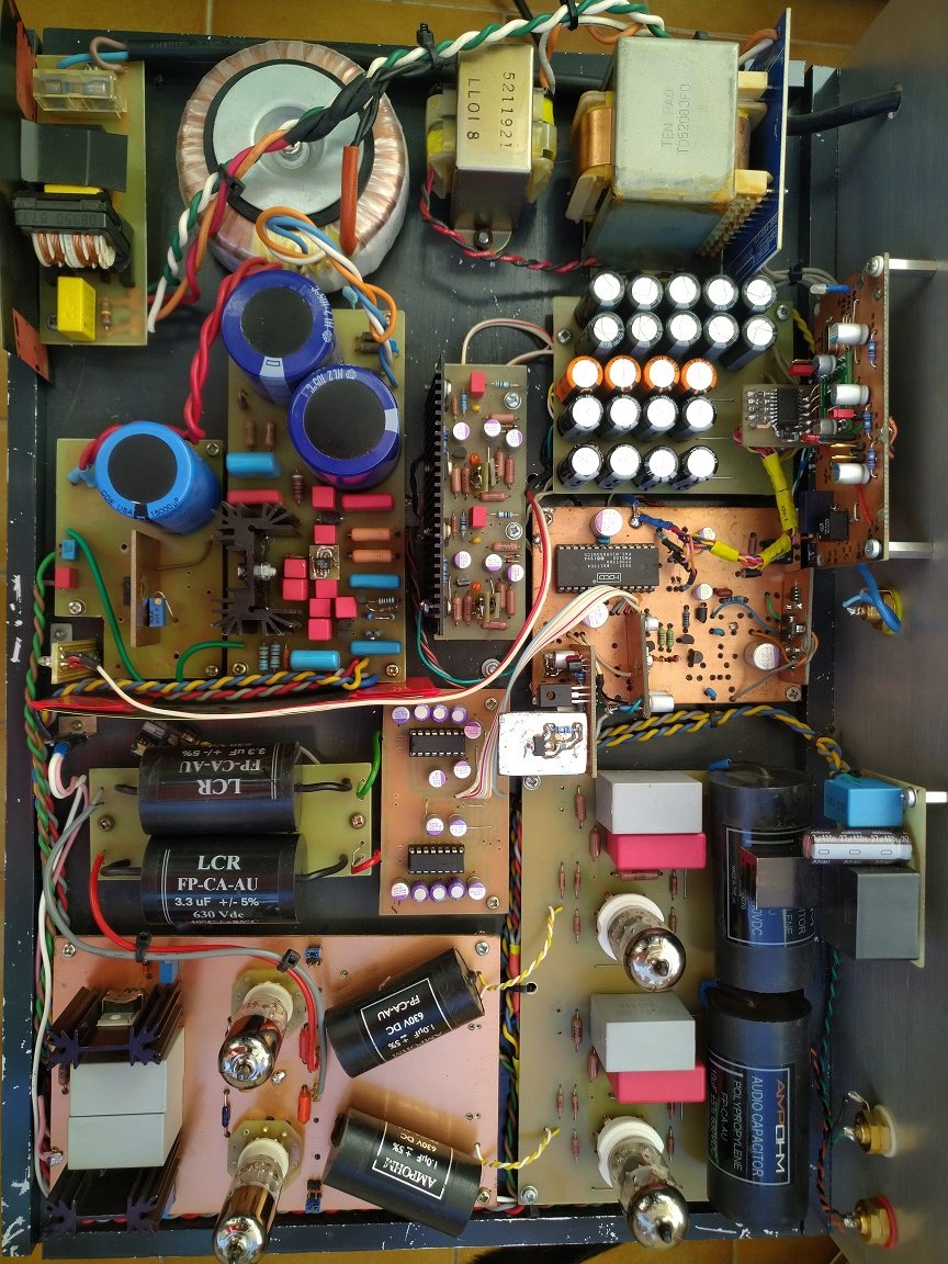

And good work jpk73 , I am also a fan of old generation dac ic , now I will amplify in my two PCM1702 to 6 pieces, three per channel, it will be interesting to hear. And I intend to drive the TDA1547 soon.
It is very cool. It can be seen that JPK73 has put a lot of effort into verifying it. It is true that although DIR9001 only supports 96K, it does not prevent it from being a good-sounding receiving device. Congratulations.I made 2 adapter PCBs for the digital receiver: one for the CS8414 and one for the DIR9001 (based on the circuit shown here). The CS8414 adapter PCB has the loop filter components on the underside. The DIR9001 sounds much better than both the CS8412 and the CS8414. Maybe that's because of the extra regulator for the receiver chip...? I configured the jumpers on the DIR9001 and the PMD100 boards to 24bit left justified transfer between the two boards. Here are pictures:

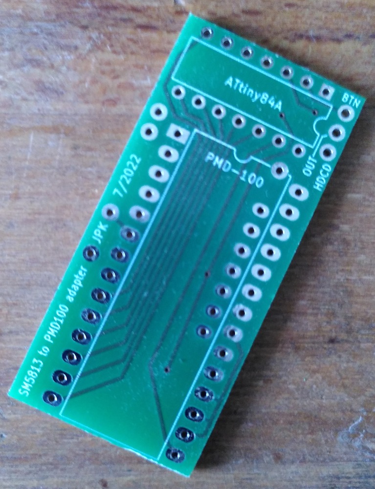

I populated and installed the new board today, the sound improved a lot with dither mode 2. The following code runs on the ATtiny:
