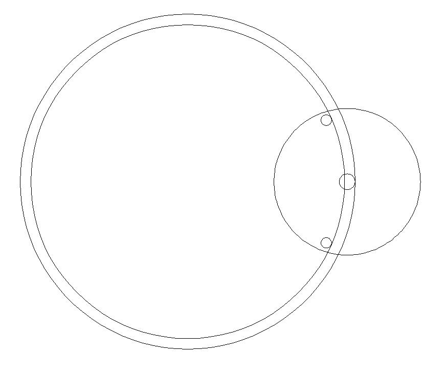

I'd stick or screw a 10mm ply board behind it (do you have rear access?) and then iterate the location of the center point using compasses or string and pencil.
Could you work with something like this?:
Router Bushing Set
I know your depth is not the same as what they are working with but that is the idea.
You could make another board stack to act as a guide for this setup using the router bushing set.
Or make two guide pins on the router base. see jpg
Router Bushing Set

Happens all the time. Best is to bolt in a backer board so you do have a center. Now, finding that center is a bit of a challenge.
Some router edge guides have adjustable rollers, but they tend to be not the best.
Be sure to orient the board with an arrow or something or you WILL be off center.
I don't care for bushings. They also have to have the orientation concerns as they tend to be slopped than I like.
+1 on that.
