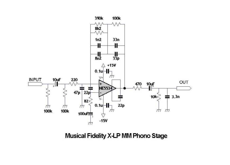

I've traced the schematic of the MM section only of the X-LP.
the 22pf is connected wrong, for the circuit to work, there should be a path for the resistors in the feedback network to connect to the inverting pin of the ic..
yes, but we have to correct mistakes when we find it.....
caught this one thru google search...😀

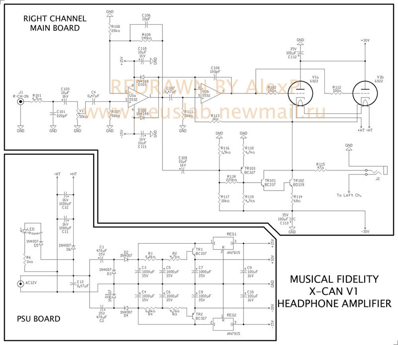

As there seems to be no circuit diagram on the net I had to reverse engineer it from the pcb.
Now, mind that I am not an electrical engineer. I am just a humble mathematician with a daily job which allows me to fund these kind of projects. If you see anything strange in the schematics please feel free to point it out. Also in the sequel if you see anything which can be done better let me know.
I was a bit surprised to see a quad op amp in the circuit. I could thing of one op amp per channel, but two? What I say was pretty bad: it seems that the vol pot has been sandwiched between two op amps.

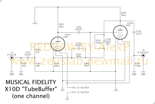

Removing the op amp was easy as there was a socket on the pcb. I just took it out. Then I bridged IN to 8 of the op amp (I was not brave enough to go to the other side of C208 - any thoughts on this? anyway the cap is Elna SilmicII which has Nelson Pass' blessing and is used in his ACA). Another bypass want from the slider of the pot to output 7 of the op amp. Mind that since the amp uses a dual power supply it is not possible to bypass the coupling can which comes next.
At this stage the sound has lost some of the harsh sibilance. And I still had a volume control and the source switch.
But still too thin to my liking.
My guess was that it was due to too small coupling caps. I beefed up the 0.22uF in front of input of the first half of the tube up to 1uF. This brought an improvement. Then I added another 2.2uF at the output (which proved to be very tricky given my design brief). Another improvement.
There is lots of presence but still too bright to my liking. Not sure where to go from here.
Also I do not understand the whole feedback from pin 6 of the tube to pin 3.
When I disconnect it it does not work. Any thoughts again?

Hello Gregje, I can't help much (save that the schematics are in the beginning of this thread) but I'm glad to see that this unit is in good hands!

After studying the circuit of x-10d a bit more I realised that I have pretty much converted the x-pre into x-10d (there is a typo in the schematics I have posted above: I missed 1.8M biasing resistor in front if the grid of the second half of the tube).
In the threads about x-10d people confirm what I suspected: the feedback network from the anode of the second half of the tube (pin 6) to the cathode of the first half (pin 3) is used to shape the response correcting for all anomalies caused by the low B+.
Strangely nobody comments on the size of the coupling capacitors. I guess I am imagining things just like a DIY-er who changed something and is convinced it is superior to the previous state.
