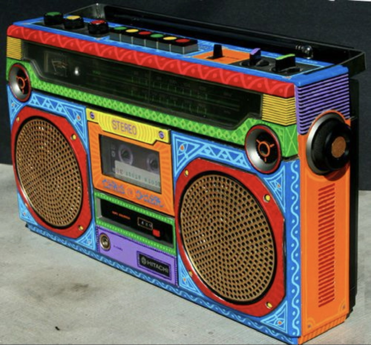

I have just been given this:
It's a Hitachi TRK-3D8E boom box / guetto blaster / brixton breifcase.
Whatever you call it, it sounds pretty good. It's powered by either mains, or what looks to be 8 x Alkaline size D cells, which would make it 12V.

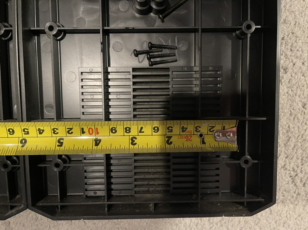

- Add additional drivers - theres a LOT of space internally from what I can see though one of the vents

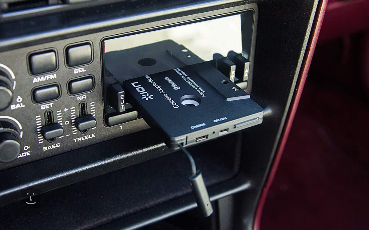

There is Bluetooth cassette adaptors

I believe those are only suitable for car cassette players because of the way the bluetooth receiver has to hang out of the insertion slot - see image.There is Bluetooth cassette adaptors

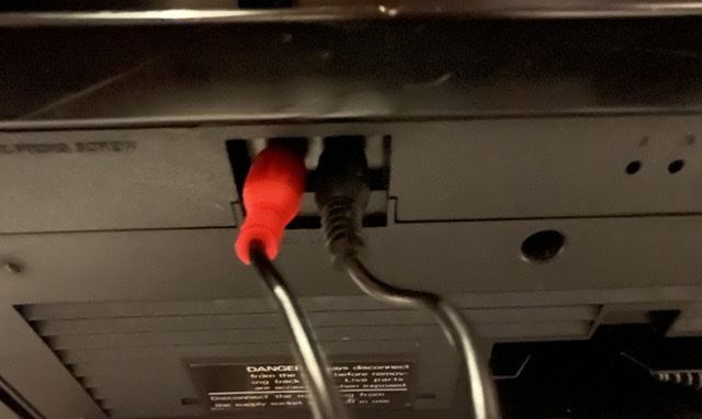

There’s definitely no need to use those cassette Bluetooth adaptors, there’s an aux in at the back:

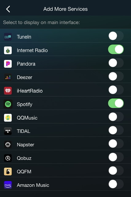

I already own one of these little boards and it makes my amplifier visible by Spotify and other music services. If you have more than one, you can synchronise playback between them. It runs on 5V. Would be pretty awesome added to the Hitachi… would give it WiFi, Bluetooth, Spotify Connect and more…

The Mrs is already ordering acrylic paint and decals…. I think she may have seen some inspiration on Pinterest….
Who says we can’t make it into a TRK-3D75E? I’m fairly certain there’s a lot of space inside it. 3” drivers would probably fit nicely…..

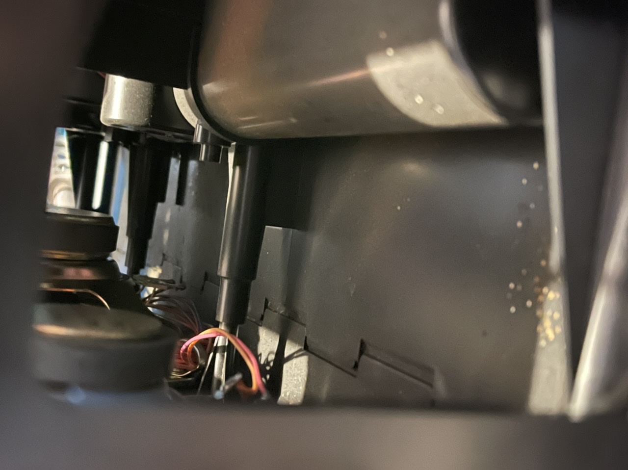

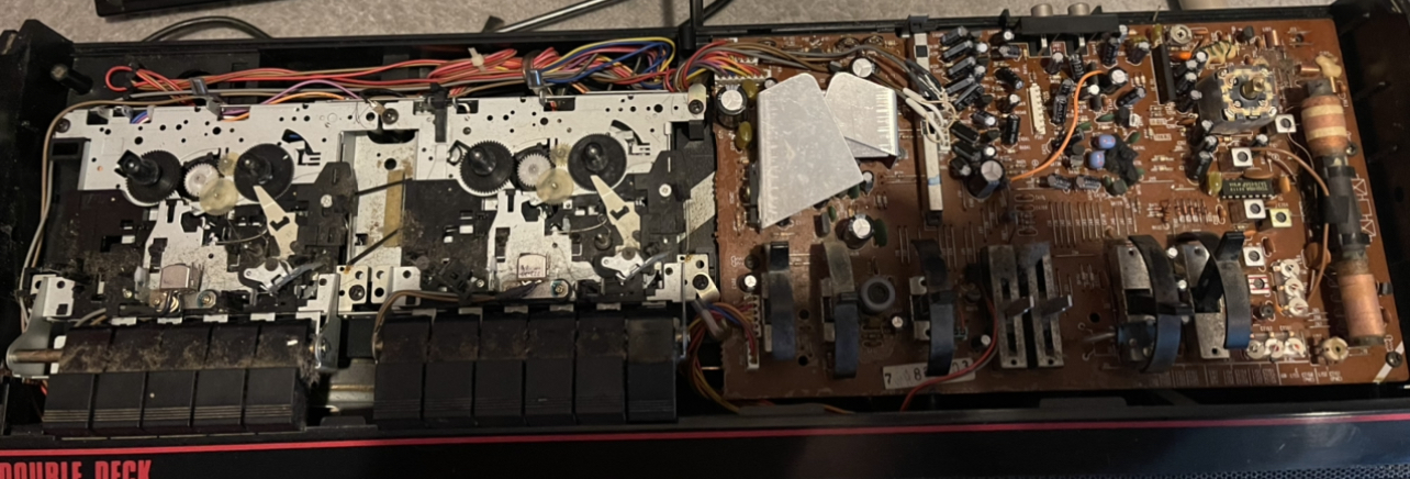

I opened this baby up today….. wow…. It’s busy
But there’s an absolute ton of space inside:
These end caps, a good space for extra drivers?

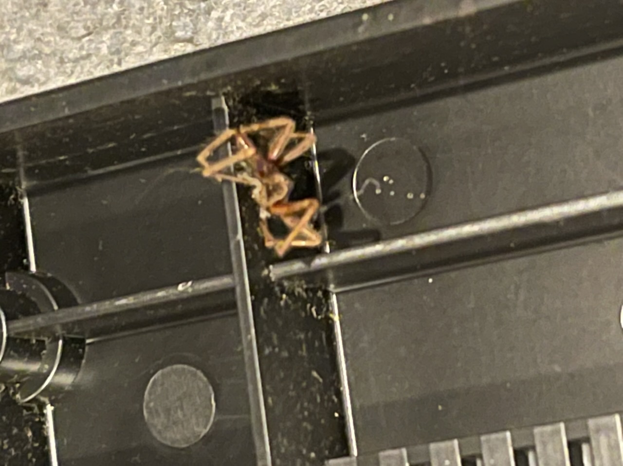

This guy obviously made his way in and couldn’t get out…..
I have located the 2 wires coming from the PSU that feed the 12V. Looks like the batteries feed into the PSU, then out again. Not sure why if it’s one or the other and no rechargeables.
So here comes a stupid question of mine…. Is it possible to add additional drivers by splicing into the existing wiring?
Is there any way of knowing if the left and right drivers are full range by looking at that circuit board? It’s difficult to see anything on the back of them to identify without complete disassembly.

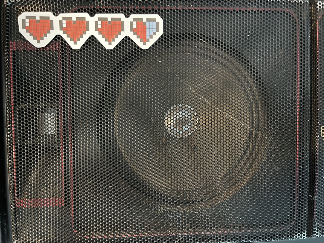

There are tweeters at the extreme left and right hand sides of the enclosure.Is there any way of knowing if the left and right drivers are full range by looking at that circuit board?
The full driver complement is as follows:
1 x 160 mm super woofer
2 x 120 mm midrange
2 x 20 mm tweeter.
I don't see the point of adding additional drivers inside the enclosure. In fact, doing so would be likely to affect the operation of the existing drivers.
The 8 ohm superwoofer is driven by a mono 8 W amplifier.
The 4 ohm mids are driven by a 2 x 3 W stereo amplifier.
The tweeters are 300 ohm and must piggy-back on the mids.
I wouldn't attempt to add additional drivers without full knowledge of the circuitry involved.
The total power rating is 14 W RMS @ 10% distortion - don't be fooled by the meaningless 60 W PMP (Peak Music Power) specification!
From where am I getting all this information? From the Service Manual of course! 😎

You would have to show me how the present drivers are loaded in the enclosure for me to answer that fully.
I presume the superwoofer is in its own sealed enclosure so that would be OK.
However, if the mids operate freely into the remainder of the enclosure, then mounting other drivers may subject them to unwanted back pressure.
Then, there's the consideration of impedance. Connecting additional drivers in parallel with the mids would lower the impedance, perhaps to the extent that the stereo amplifier would experience stress and distortion.
EDIT: In addition, there's the question of sensitivity. Adding drivers of greater sensitivity would result in most of the sound going to them and vice versa.
Oh and the 2 x 3 W stereo amplifier will be bandwidth limited to supply only midrange and high frequencies to the mids and tweeters.
I can see no advantage in augmenting this bandwidth with additional drivers - and the subwoofer, with its own dedicated amplifier, should need no augmentation.

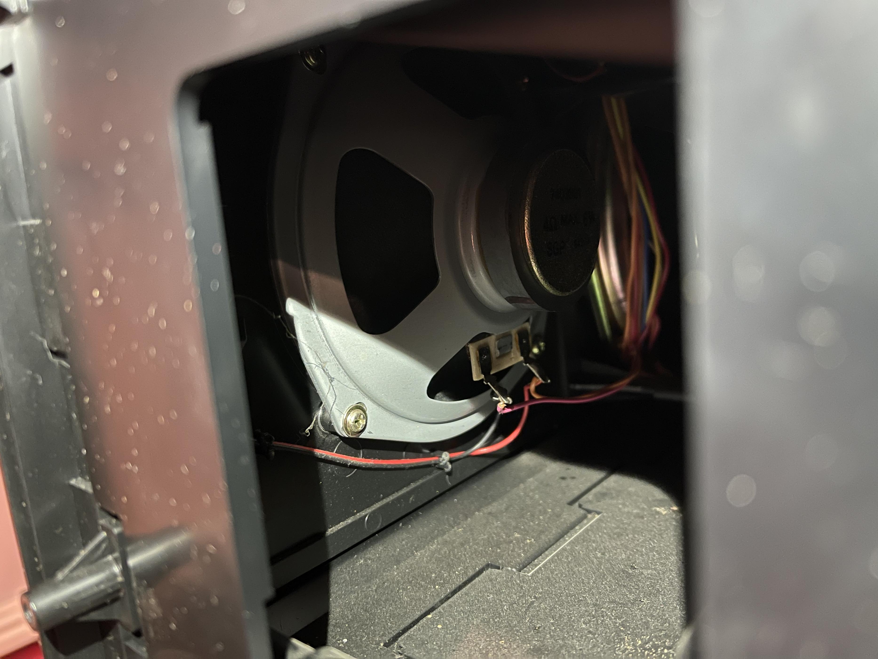

That second photo of yours appears to show the woofer and mids operating into the same volume - correct?

So the bass is not enclosed:
Yes correct.
