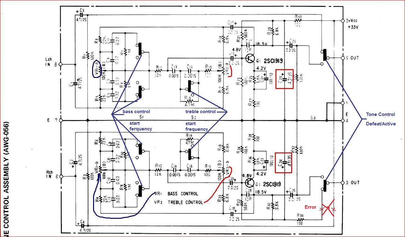

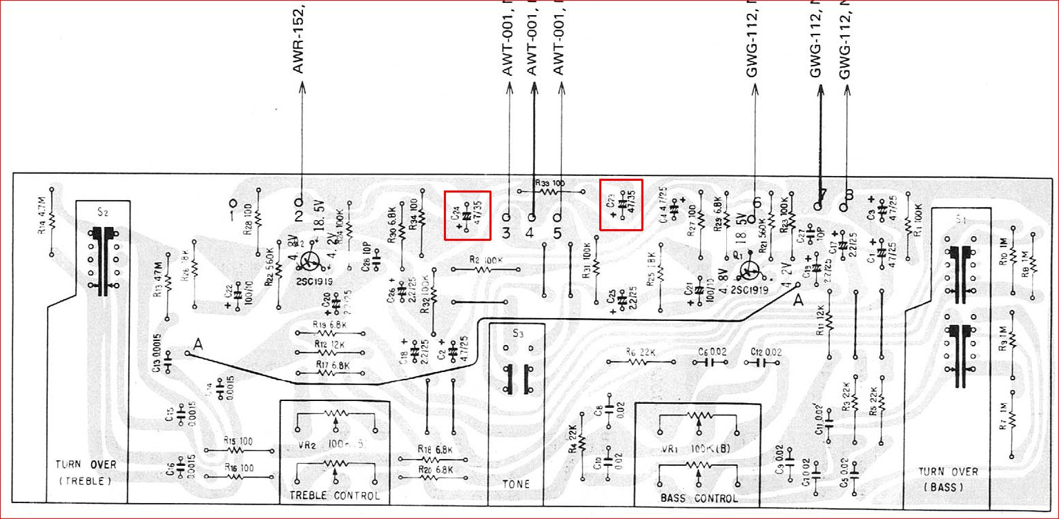

I wonder if I can modify the tone control in my Pioneer SX-1080, by changing the value on some capacitors on the tone control board?
I've read a couple of places that the specs of the caps can enhance/reduce the amount of bass/treble an amp (pre-amp?) will let out, and also a while ago I watched a video on youtube where a guy had made a very simple curcuit that clearly demonstrated this correlation.
The reason I'm looking into this modification is, that I still miss the clarity and open airy sound this receiver used to be able to sound like. I have replaced ALL electrolytic caps, all trannys, many diodes and some resistors, on ALL boards, along with the protection- and soft start relays since it was beginning to sound rather dull and confined. I never really was satified with the result of the re-cap, and have been searching for that last thing that will make the difference and bring back the quality sound the baby once was capable of.
So if any one would care to comment on the idea (hopefully positive) I'd really appreciate it.
If I should give a guess, I would try and replace C23, C24 (47 µF) with ~30 µF caps, in order to enhance the treble.
What is the function of the low capacity caps of 0.02 ceramic and 0.0015 mylar caps? Will it influence tone level to replace them with other values?

C23 and C24 are rail decoupling (power supply). All the small value (non electrolytic) caps on that diagram are related to setting the tone control characteristics.
Fist steps should be to test the amplifier with a signal generator and scope and make sure that the response is initially flat and that all the controls work as expected.
Replacing all that you have done leads the way open to possible mistakes having been done.
You need to test the amplifier in its present state and determine if in fact there is a problem before randomly changing parts in hope.

changing any of the low value caps to other values will completely change the tone flavor as well as the center position flatness. c17 and c21 affect the bass response and 2sc1919 gain.
What drives the tone control stack? line or preamp?
do both channels sound dull? if not a bad resistor in amp may be the problem.
OK won't touch those, then
OK, so these I can play with.

From what you tell, I suppose I could experiment replaceing the low value ceramic and/or mylar caps, and see if it changes to my preferences ?
Since there is a switch to defeat the tone control, seems easy to find out if the problem comes from there 😎

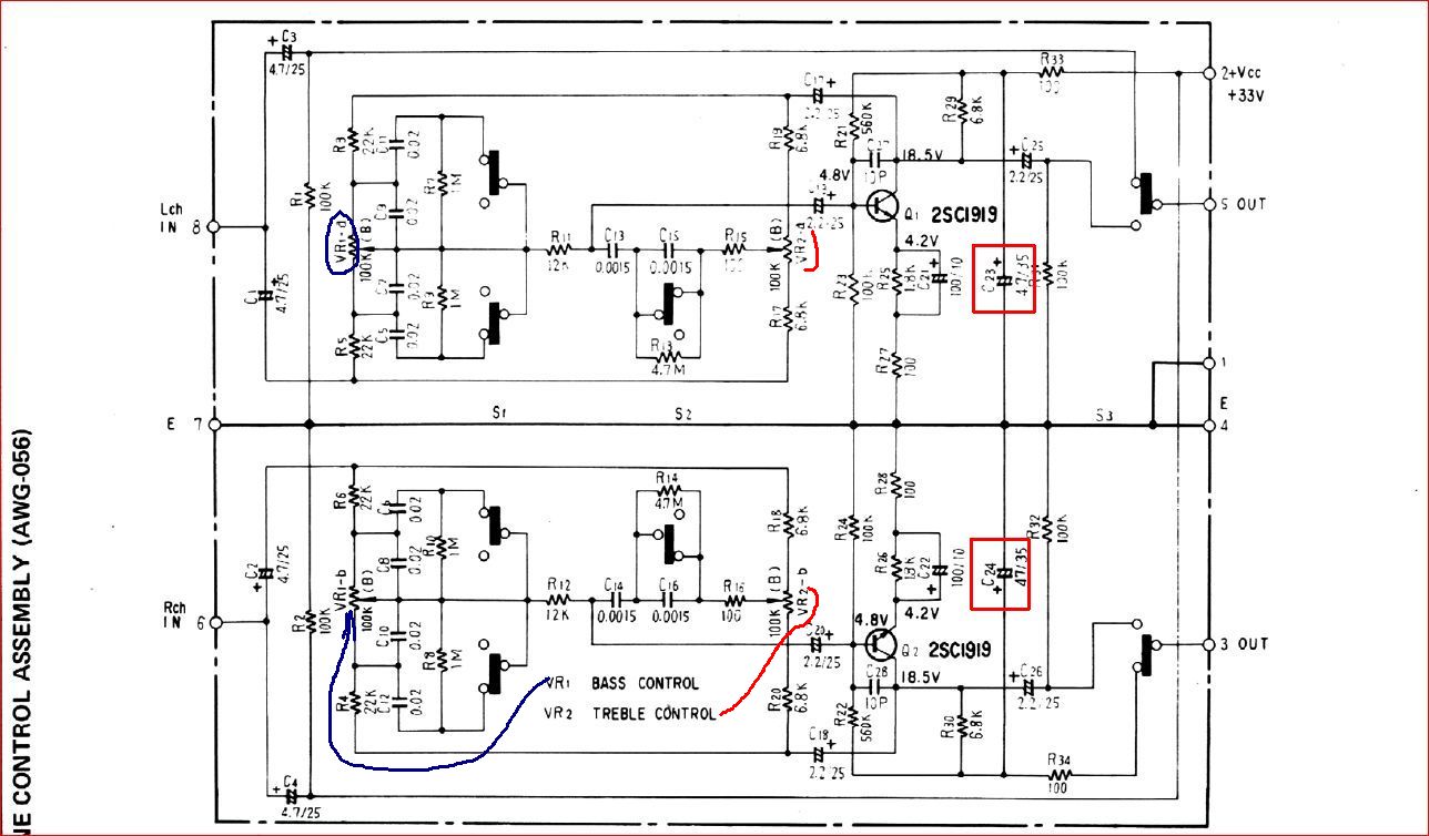

But perhaps the schematic is not what's in the amp, found allready an error 🙁

One of my amplifiers also sounded "veiled" and "dull" (compared to others) and I found out that the highs started to elevate only from 2kHz upwards while my "reference amp" started to elevate them already from 1kHz.
Ok, installed LTspice, found some tone control models from the net, spent some hours on learning my way around and found the cap to change (from 39nF to 100nF it went). As a result the "shine" is back in the sound, the elevation starts from ca 800Hz and is ca 3dB (compared to base level) at 3kHz. Certainly I can put the knob in the neutral position and have flat response ;-).
Mona
That's a pretty sharp observation :radar: on the diagram - now I see it too

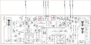

There are several parts either not installed or of different values in the SX-780
however this will not explain the lack of an open airy sound as it had it before.
KSC1885 could replace 2SC1919 but I doubt that is the problem.
it is easy to tell as the tone defeat switch switches out the tone circuit entirely.
to electrically remove the circuit, input capacitor C1 (4.7/25) can be removed from 1 channel and test. if no difference then 2SC1919 is ok
