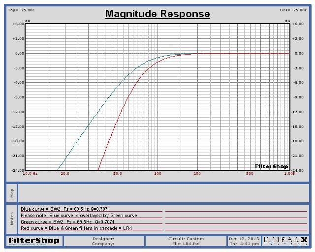

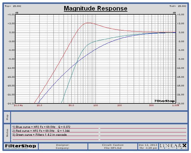

If I understand you correctly, you want to seal the enclosure to obtain a HP2 acoustic response and then add an active HP2 filter that will give you an overall acoustic LR4 response to your bass/mid drivers.
Unfortunately, it is only possible to do this if both responses, the sealed enclosure response and the active filter response, are 2nd order Butterworth (BW2) with both responses having the same Fs and Q.
I hope the attached two graphs will help clarify this. In graph HP4.JPG, you can see that I have entered the data you gave in your post #5 into a simulation program, which gave me your two filter response curves, which I then cascaded as shown in the Green curve.
If you compare this Green curve with the Red curve showing the cascaded response of the two BX2 filters in the attached LR4.JPG graph, you will see that the magnitude and phase (phase not shown) of these two cascaded responses are only the same at Fs and at the two frequency extremes either side of Fs. So your sealed enclosure + active HP2 will not sum to a flat response with your sub at frequencies close to Fs.
What this all means is that an LR4 response is uniquely defined by two identical BW2 filters in cascade and cannot be constructed by any other pair of 2nd order responses.
However, all is not lost, because there are a few other ways that can work, but in all cases you will have to force the sealed enclosure response into a BW2 response first and then add your active BW2 filter.
One way of forcing the sealed enclosure response into a BW2 response is to add a suitable peaking filter (BP type) to boost your Q from 0.372 to 0.7071 at Fs. You can then add an active BW2, which will give you an overall LR4 response. If you have, for example, a miniDSP, this could be implemented quite easily with only 2 biquads. Implementation in the analog domain is doable as well. You will need to accurately determine the coefficients of the peaking filter in order to force the sealed enclosure response into a BW2. Another way is to use a Linkwitz transformer to force the sealed enclosure response to a BW2.
Yet another approach which may work is to add resistance in series with the driver which will increase the Q. The drawback with this is obviously the loss of power if implemented passively. But if you implement it in an active form, you won’t loose power. After this you just add a BW2 to get a LR4 response. Hope this helps.

findings for sealed box speaker:
Fs 69.5Hz
Fh 110.2Hz
Fl 39.96Hz
Qtc or Qts? 0.372
Required filter Q is 1.344
Do I set the filter F the same 69.5Hz?
This should result in LR4 of F-6dB @ 69.5Hz
Is that right?

How did you get that number ?
1.344*0.372 = 0.5 for the LR damping.
