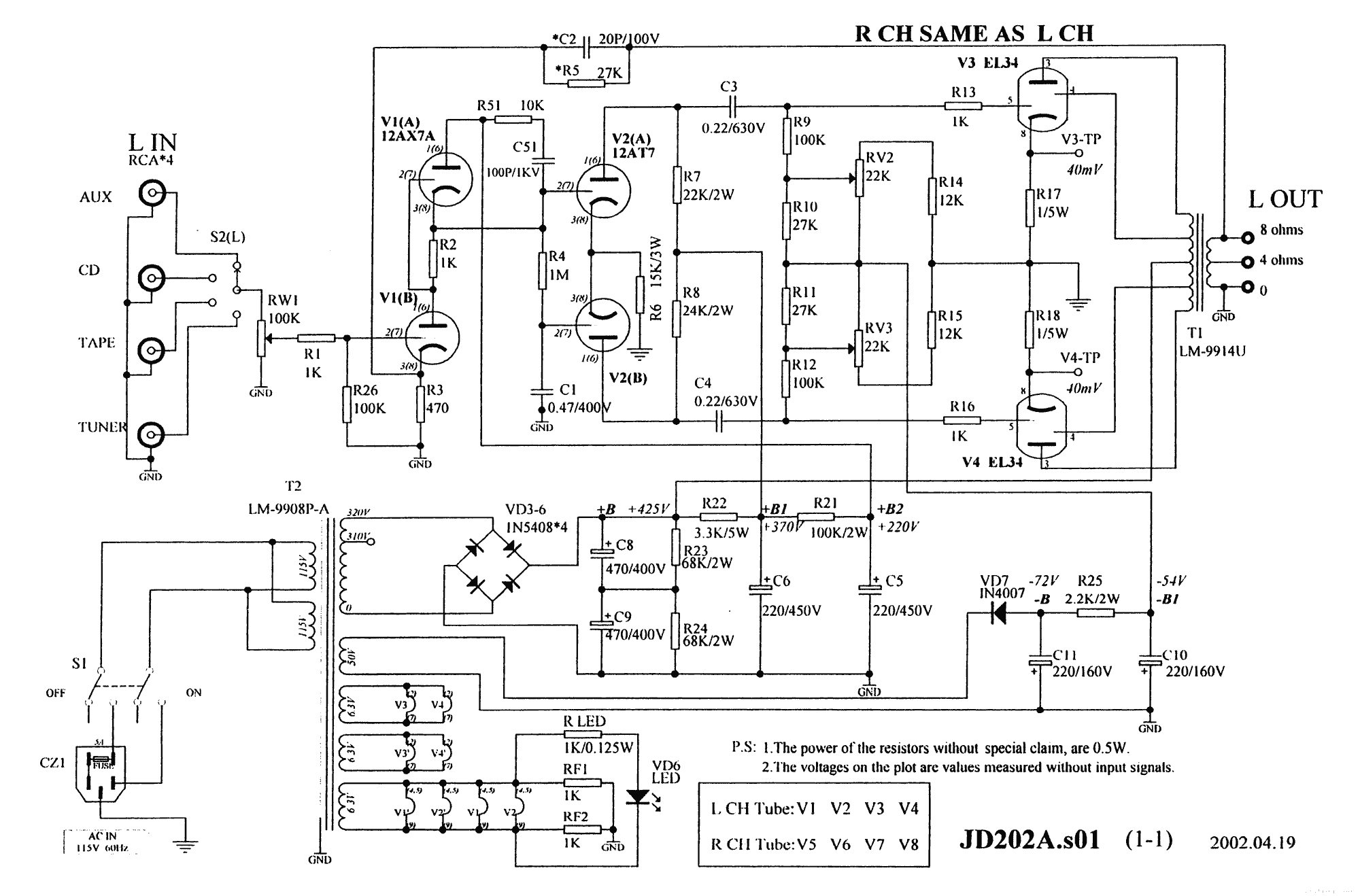

Looking for some help modifying my Jolida 202A into a power amp. Unfortunately I do not have schematics. My goal is to use the Jolida as a power amp for mid/highs and another a separate amp for the LF.
Fortunately, this 1 is easy. Look at the schematic. The Jolida 202A is a Mullard circuit power amplifier, with source selection and a volume control at the I/P.
Connect the AUX I/P jacks to the wipers of the volume controls, instead of the source selector switch.
BTW, a very simple modification will improve PSU performance. Replace the 4X 1N5408 diodes with totally compatible UF5408s. The amount of SS diode switching noise will be greatly reduced.

Thanks for the simple solution, schematic, and Pro tip on diode upgrade. May I ask what you meant by totally compatible? Looked Mouser.com and it seems for less than $5 I can reduce the switching noise. Amazing. I will open the hood and check to see which diodes are in my unit.
