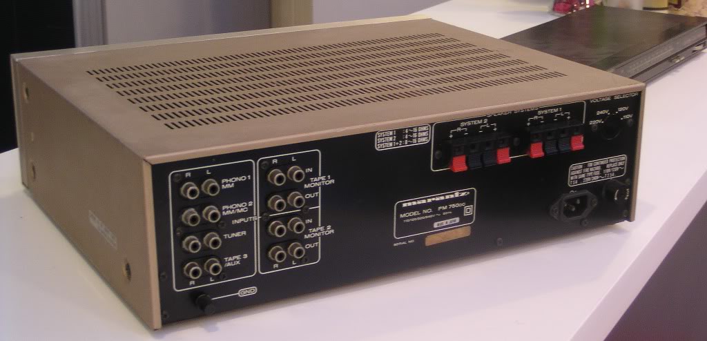

Im new here, hope this is correct subforum. I plan to test my working integrated amplifier Marantz PM-750 DC, want to try their preamp.
I already research that its doable. I want to make sure, is this the correct signal path? Here is the zoomed schematic, and below is full schematic.

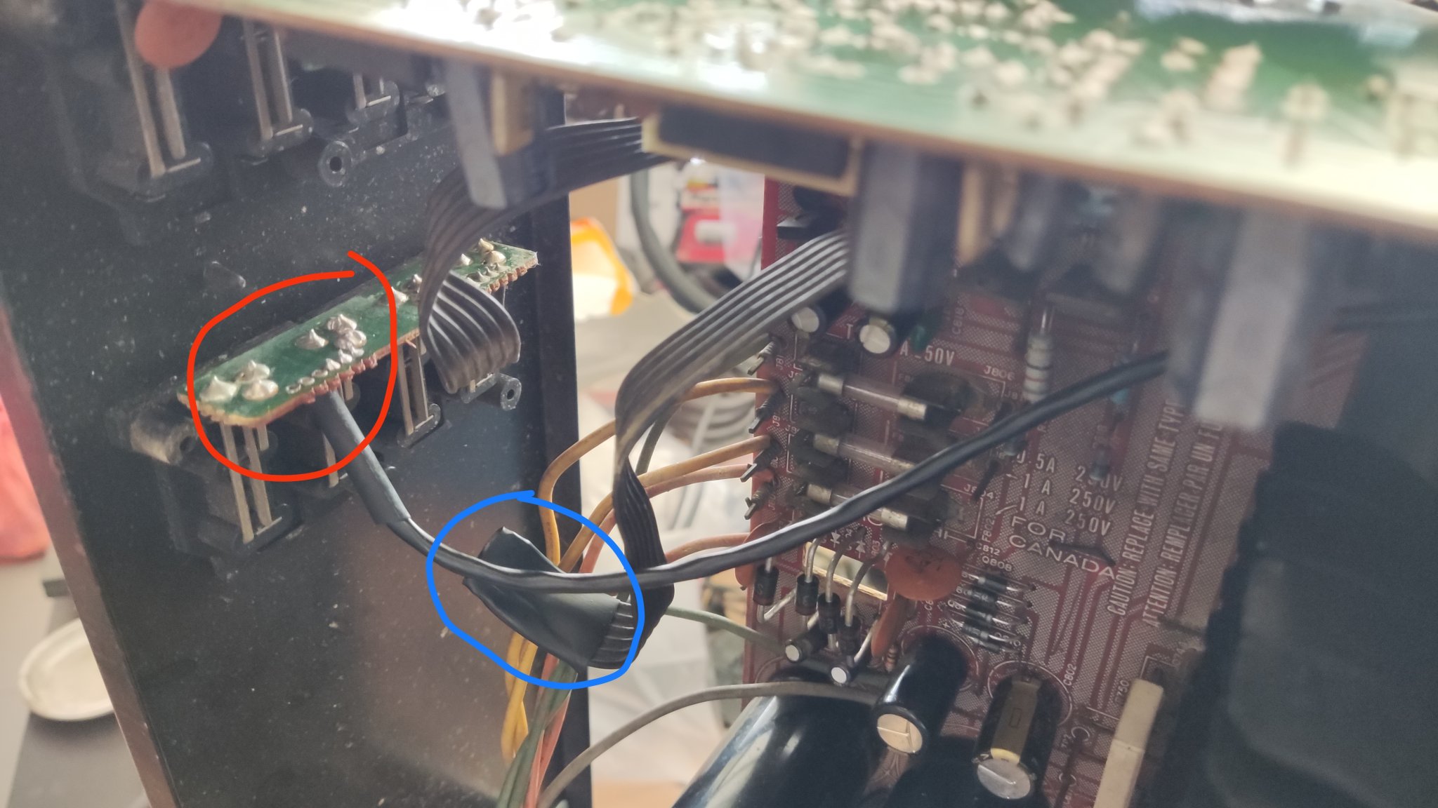

@Mooly thank you for your replay. That so fast!
So i can start to my plan. Luckily i found a jumper before power amp. Make a shortcut cable that i did not use tape in and out for temporary PRE OUT.
I desolder the jumper (red circle) and put the audio cable.
Then desolder the tape cable (blue circle) then connect them to the TAPE OUT (red circle).
Will test them tonight cant wait to hear them. I like to listen music at night, nobody will annoy me lol... And no noise from outside.
Will update how it sound,
