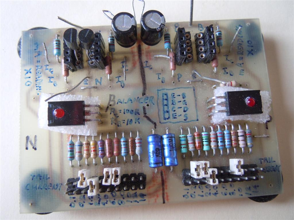

Setting bias current the way Carlos has mentioned would be a great exercise, you would learn a lot. Since I have almost always had a distortion analyzer, I could investigate many things. Consider that the ultimate goal in service (or modifications) is to at least maintain low distortion, one of these instruments is worth their weight in gold. At the very least, use your computer sound card to investigate these things. But better yet, see if you can buy an old HP 331A, 332A, 333A or 334A. The specs aren't stellar, but they hold hidden value! The 333A and 334A have auto null. You really, really want this - big time. Once you have a THD meter, you can look at the residual from the THD meter with your sound card. This is worth more than just a sound card. The THD analyzer will protect your sound card from damage as well.
One nasty little secret you should know. I was forced to buy a specific make and model (Leader) THD meter. The spec indicated response to 100 KHz. Years later I discovered that it rolled off around 30 KHz! The HP products respond to 1 MHz and above, so you do read the harmonics properly. Now, if you do buy one, do not force the big dial if it is stuck. If you do, the nylon piece inside will break, and you will cry. Just take it apart, clean the bearings, lightly oil (single weight, like 5W, no additives!) and reassemble. Clean it while you have it apart. What you end up with is a mighty fine instrument. These days I use an HP 339A, but I have another 334A that I plan on restoring, along with it's companion 654A oscillator. For those, the same lubrication thing, they are 652A and 654A. The 652A is most useable for service. The 654A has a single dB level attenuator (Accurate). These audio generators come with a beautiful output level meter. Really useful, worth it for me to restore a pair even though I don't need to have them.
I hope you can pick up this pair of HP oscillator and THD meter. They will serve you extremely well.

Sorry, that unit would teach you some things, but as a component matcher, it is useless. Useless and slow to use. The key here is that your pair must be running at the same temperature and current levels. This one requirement cancels most of the stuff out there. So much so that I finally had to design and build a jig that satisfies those requirements. No other type of instrument will work unless you can keep the transistors at a constant temperature (25 °C for example), and run them at the identical current levels. The thing I posted has been build a couple of times, and I finally put mine on a PCB because I used it too much and the perf board version wasn't happy about that. I have attached the images for this PCB.Nice suggestion on the transistor matcher as i was already considering this kit from Ebay:
Given that you are a keen listener, replace the tone section with a flat gain stage equal to the tone control circuit gain with the controls centered. Again, a nice little NE5532A would work quite well for this. Cheap, cheerful and easy. All you need to do is send a constant tone into the receiver with no speakers connected. Measure the level into the tone board, then for the output. Output / input = gain Set the replacement gain stage to test the same way, this can be calculated before the first resistor is touched. This way you are not touching the original tone controls so they can be replaced easily. Also, you could then put a switch to select between circuits and not suffer level changes. The NE5532 might just stay behind, you never know. This is a great way to learn, and the same building blocks can be used for more experiments.I am a very keen listener and one thing i noticed in my simple experiments that can make a huge difference in the overall spatial image is balance.

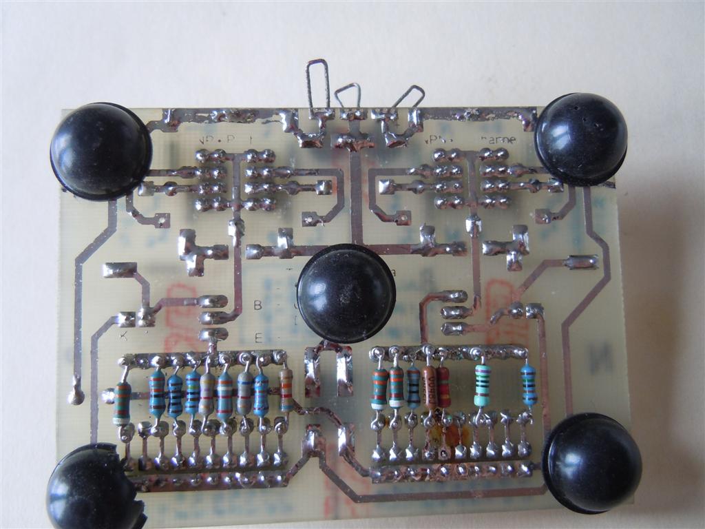

Hi jooch,
Well, I can't tell from looking at the capacitors you have shown. Normally on the tan disc ceramic capacitors they would mark the top with a black band (black = 0). It "sounds" like you installed the correct ones. (sorry about the pun, don't know if it translates).
To run op amps, you would be better off to create a bipolar supply at +/- 15 volts from the main power supply. You can either go the super regulator way (CCS driving a shunt regulator) or a normal series pass design (standard voltage regulator). Don't use the three terminal regulators for this, although there is a high voltage LM317 (HV) version. Series or pass types can both be designed to be excellent - down to splitting hairs.
There may be other locations where an op amp improves performance. So making a power supply would serve those too. If you run with a single ended supply as suggested, you will need to create a 1/2 supply reference voltage that also forces coupling capacitors on the input and output side. The 1/2 V reference will be a regulated power supply. If you do that, you may as well regulate the raw 35 V supply. Now you are looking at two supplies, two capacitors each channel, and the same for any other op amps you might add in the future. I would just make a bipolar one.
The other value of capacitance will shift the x-over frequency a little. For your good build, get the correct value. I guess this change was worth while then? 😉 Do the same thing for power amps, phono amps and anything else you listen to. Same for the power supply regulators.

Would you please point out what exact parts you are using? Here is a link to Murata's capacitors. http://www.murata.com/~/media/webrenewal/support/library/catalog/products/capacitor/mlcc/c02e.ashx
I don't use these, but I feel uncomfortable with what I think you are using.
anatech,
Thanks for the catalog but it was easier for me to link to the exact part. This is the part that I got for bypassing the larger resistor in the NFB loop. I have had these for a while, am in no hurry and do not have to use this part. Murata 10pF MLCC C0G from Mouser.
Other than rated voltage and the fact that it is ceramic, is there something about this part that you don't like? Do you feel that MLCC is not ideal for this type of duty?
Among ceramics, type would you prefer for NFB, Miller, etc?
thank you
Hi roger2,
Ah-ha! Many thanks for the link. Now that I can see what this part is all about, I don't have any problems with it at all. Go ahead and use it.
Normally I would prefer to use a disc type NP0 / C0G ceramic, but more the polystyrene where there isn't heat, polypropylene or Teflon. Basically all "low-k" dielectric types. Silver mica is another really good type to use, even in the heat. So you can see there are a few factors that might influence the capacitor used. If you have a non-zero temperature co-efficient, high k ceramic in there, any plastic based capacitor will be an amazing improvement. Some amplifiers aren't good enough to warrant the more expensive capacitor types unless you intend to change a lot of things because you love the way it looks. But you can certainly improve an amplifier inexpensively (save your labour).
